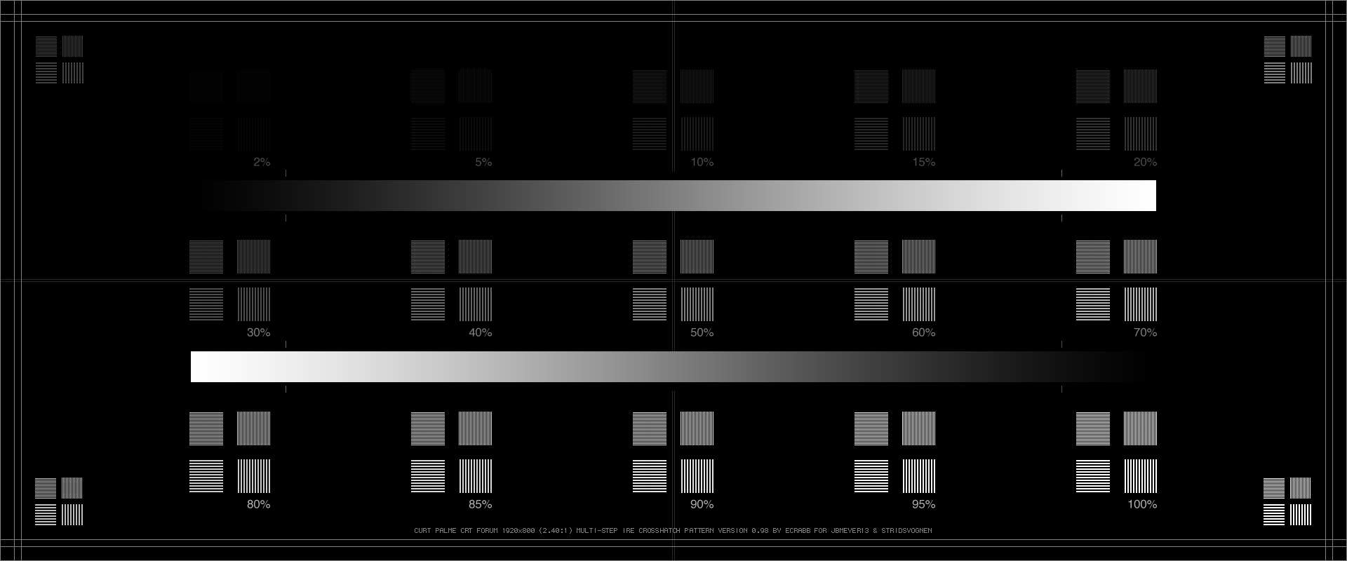

stridsvognen wrote:
Nice patterns, if i should have a wish its one where you only have low level patterns in it, like op to 20 or 30% for not washing out the 2% pattern.
I was thinking he could reduce the corner patterns to a lower % , like 25 %, left top, 50 % right top, 75% bottom left
and 100% bottom right.
This way we see the two left ones in the x5% range.
A second one would be go to 5% intervals after 10%.
For that version the patterns could be smaller in size as well.
Aslo on the version you made last remove the border on the luma ramp please. what you can do to signify
the 16 level black is put two small white dots marking it above and below the pattern. That can be done on the white side with black dots marking 235 level white in the pattern. maybe put the 16 level white dots in the ramp as well not above and below.

Ill like it to stay below 30% all around, it would be a good way to take a really good look at 1:1 at low level, to see if the signal is clean and undistorted. And use it as a G2 setup pattern to.
For me these patterns is realy nice when i play with the MP mods, and try different components myself.
They will look quite bad on any standard CRT.
Try run them on a digital projector/ flat panel, and see what happens.
Posted: Tue Dec 16, 2014 6:57 pm    Post subject:
Oh and one more thing this can also become and over scan pattern simply by adding on the cross hatch the points with an arrow for 2.35 and 2.40.

Hey, guys... Lots of ideas flying around. I don't mind a little "scope creep", but I don't want to take what could just be an idea as direction, or dismiss anything that's crucial or important. So...
Can one of you guys sort of "lead" and take this last round of discussion and put it into a couple of specific specs so we can finalize at least this pattern? What I'm getting it is to hash out the ideas (ala "I was thinking..."), agree on what exactly you want, and then I'll build it.
Maybe we could then turn this into a discussion on other types of patterns we'd all like, variations, colors, etc., then we could even build a list and turn it into a whole set of patterns. What patterns are you missing to set up your system?

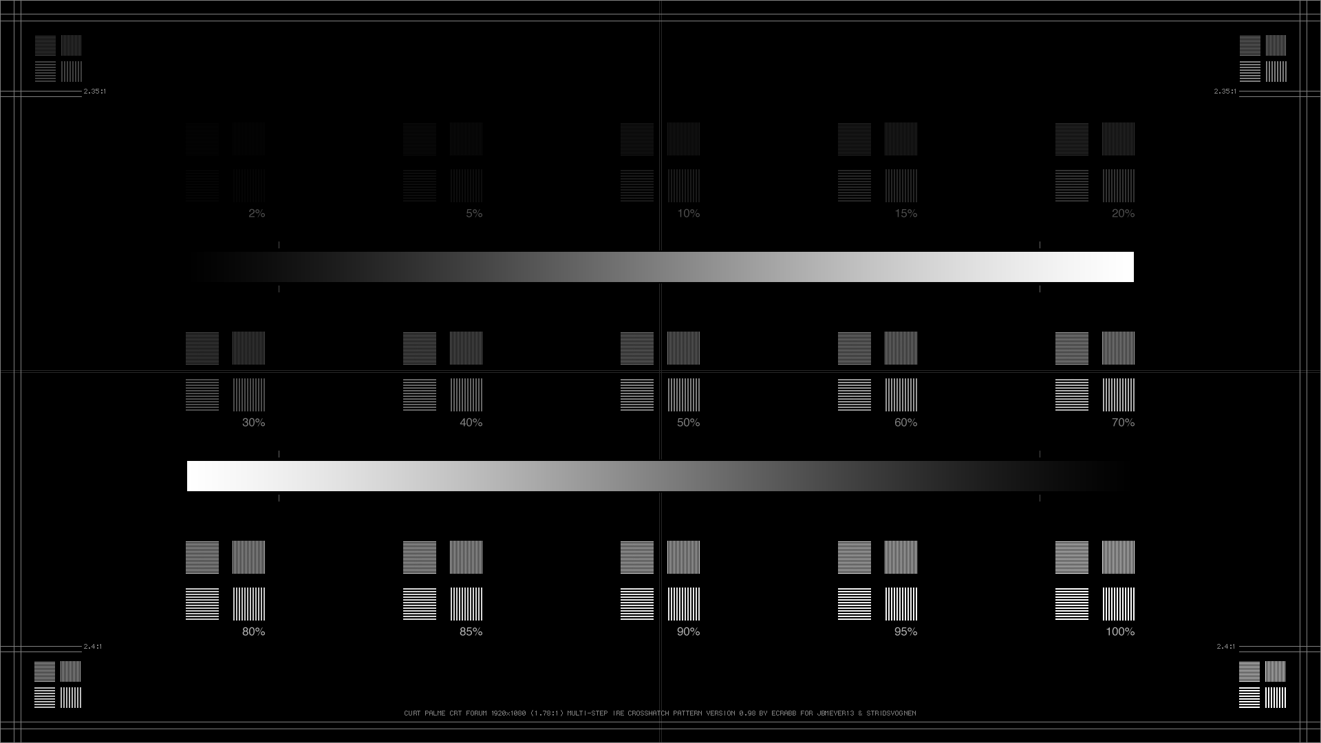

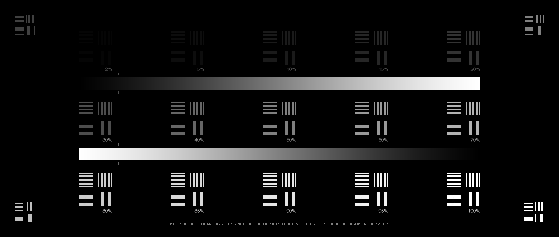

And do the reduced brightness of the corner patterns. top left start at 25%, then top right at 50%, bottom left 75%, and bottom right at 100%.
And on the 1.78 pattern maybe there add the 2.35 and 2.4 aspect ratio markers on the cross hatch you have .
that should do it

Here's version .98 with the latest round of requested changes. No doubt I've forgot something. Wink
Cheers,
