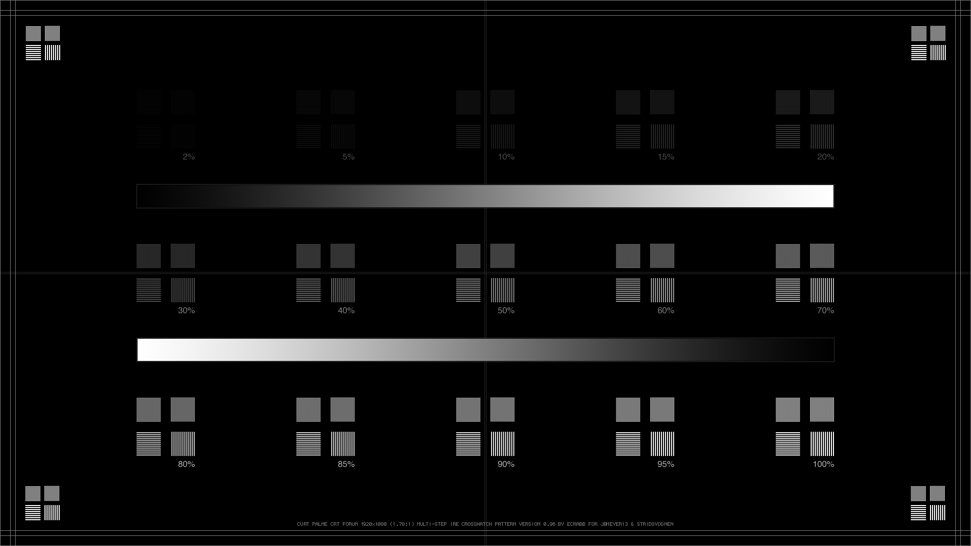

Ecrabb modified SMPTE Pattern
Posted: Mon Dec 15, 2014 7:10 am    Post subject:

Hey Nashou - you and Kurt take a look at that revised pattern I posted? That what you guys are after?
Posted: Tue Dec 16, 2014 4:38 pm    Post subject:
it looks good. Now in a 2.4 aspect, 1920x800.
Also if there is a way to maybe add a greyscale ramp from black to white.
maybe in the middle or on the right side going from top to bottom?
Not the stair step but the smooth transition.
Not sure if you could add that. That would also show the uniformity of
the gamma from black to white.
you might be able to fit a narrow one in the center form left to right, and spread the
1:1 out a bit.
EDIT : Or remove the 3:3 pattern. Not really needed if you ask me. And change the IRE to % IRE is antiquated now.

Posted: Tue Dec 16, 2014 5:57 pm    Post subject:
One more to verify it's the final, and then I'll make it a release and add the other AR's.
Good idea. Done. I added two, in opposite directions.
1:1 out a bit.
Good point on changing to IRE. That really wasn't correct. % is probably the most simple. Good point on the 3:3 pattern, too. Not much use, really. Removing them made the change to scope much easier, too. Just pushed things closer together.
I also added a crosshair. I don't know why, but I always liked to be able to see if something wasn't plumb or square. I made it ~15% so it should be pretty unobtrusive.
Let me know if that looks good, and I'll save out finals.

I like it. My only request is that you send me a copy on a BD. My damn BD player won't read anything but a JPG file Mad
Posted: Tue Dec 16, 2014 6:43 pm    Post subject:
Nice patterns, if i should have a wish its one where you only have low level patterns in it, like op to 20 or 30% for not washing out the 2% pattern.
