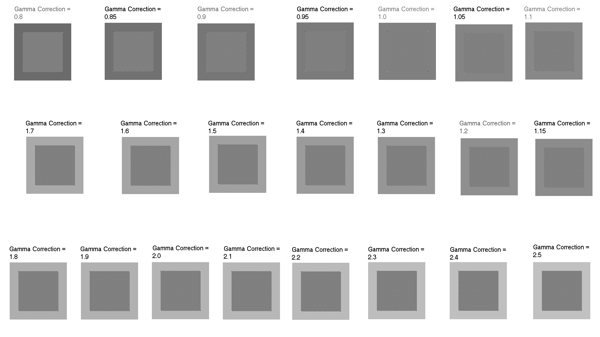

Here is a patter guys that helps determine what your Gamma is.
But it depends on how far you can stand back in your room to
look at the patterns. You need to walk back till the checker board in the middle of the pattern is not visible and a checker board but more solid. When the out line of that pattern matches the checker board , that is the gamma your display is showing.
 Filesize:  78.26 KB
 Viewed:  15606 Time(s)
Posted: Mon Dec 15, 2014 1:24 am    Post subject:
If your display is pretty sharp, you may not have enough room to keep walking. One trick we used to use back in my prepress days was to squint to blur your vision. Or, if you wear glasses, take the glasses off. Anything to blur the checkerboard and make them appear 50% grey to your eyes.

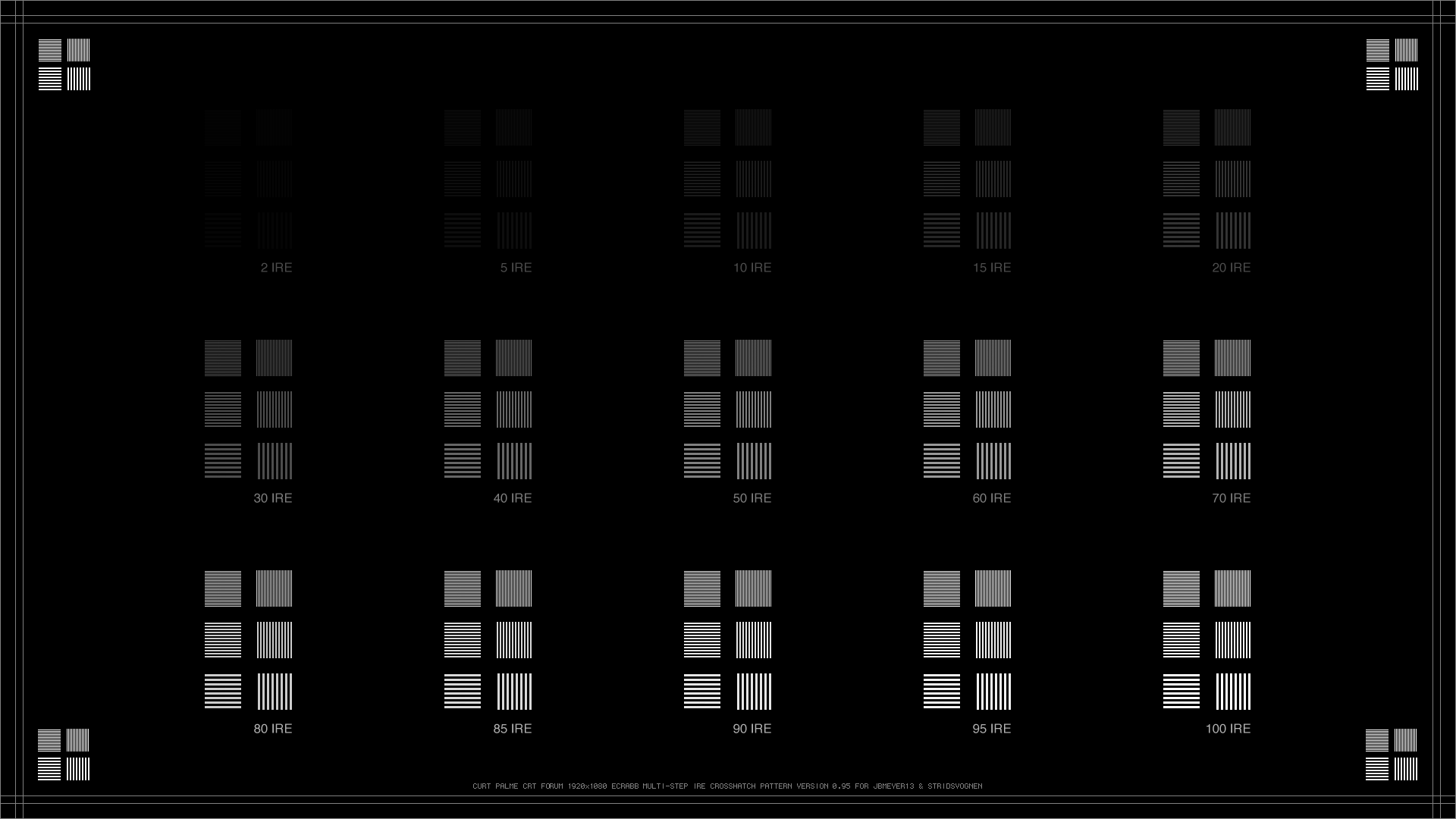

Posted: Mon Dec 15, 2014 1:27 am    Post subject:
Guys,
Here's a slightly newer version based on some feedback from Kurt. In the old pattern, where the horizontal and vertical crosshatch lines butted together, it would make a brighter line, making it a little hard to evaluate visually. This version adds some 0IRE (black) space between the vertical and horizontal crosshatch patches.
Let me know if this is good, and if everybody is good with making it the final, then I can make some variations, and at slightly different AR's.
Cheers,
 Filesize:  37.44 KB
 Viewed:  15599 Time(s)
Posted: Mon Dec 15, 2014 3:55 am    Post subject:
... When the out line of that pattern matches the checker board , that is the gamma your display is showing.
!? How the hell does that work?? The outline is different levels of gray. The checkerboards are identical, or close enough I can't tell them apart. I grabbed samples of the 0.8 and 2.3 levels and blew them up, and I can't see any difference.
So is the display supposed to result in different levels of gray for the checkerboard, depending on your gamma? And you look to see which gray level it matches?
Posted: Mon Dec 15, 2014 6:58 am    Post subject:
What gamma level should we be aiming for?
