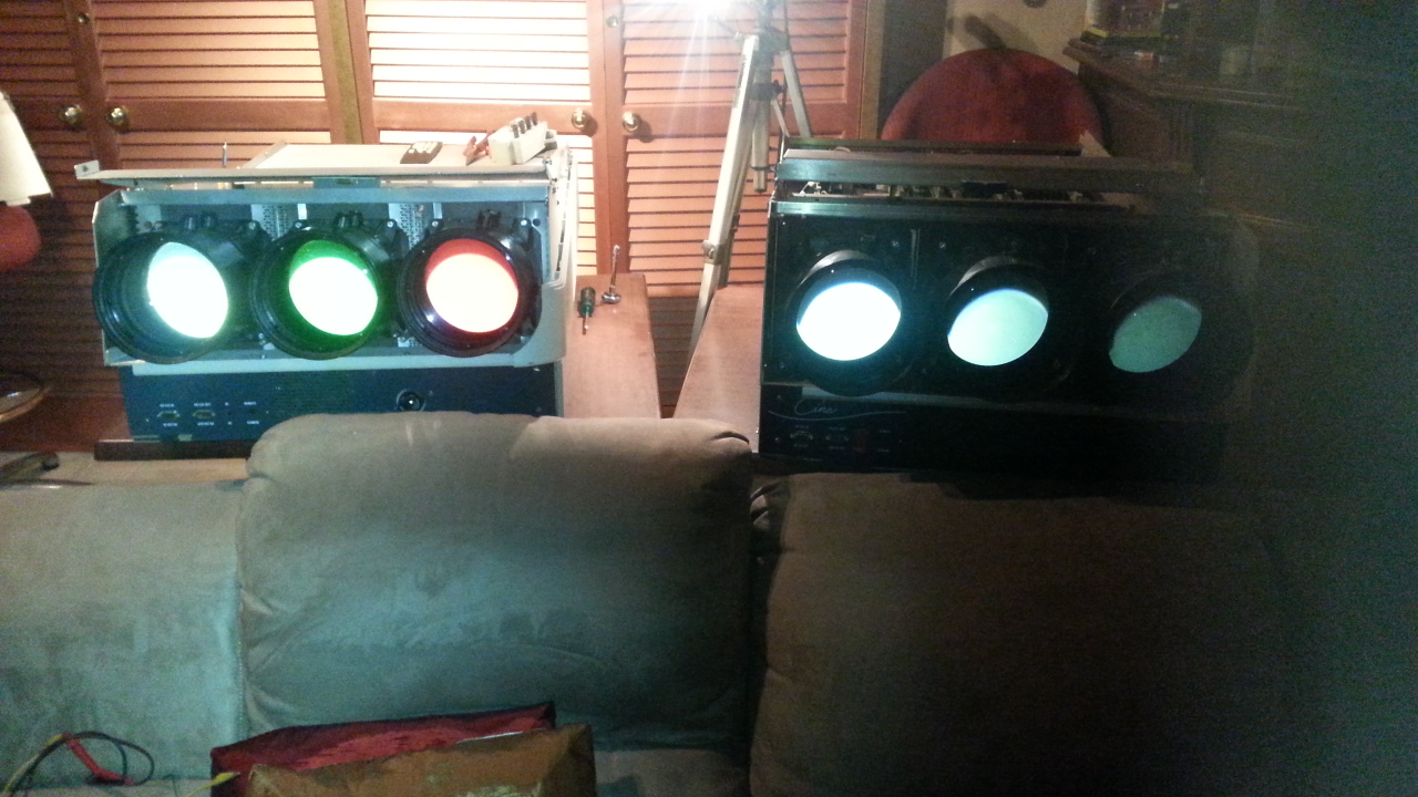

BOTH MACHINES
BOTH MACHINES

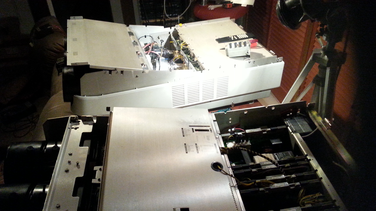

BOTH
BOTH

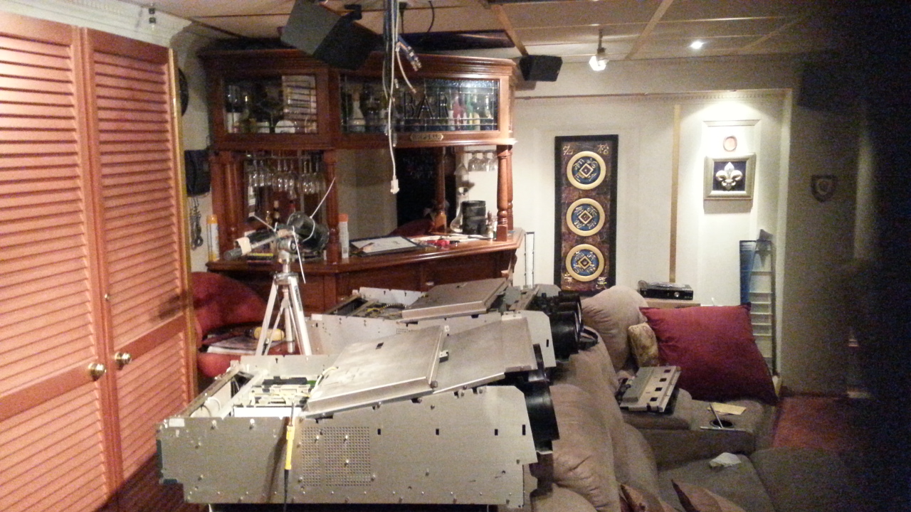

BOTH
BOTH

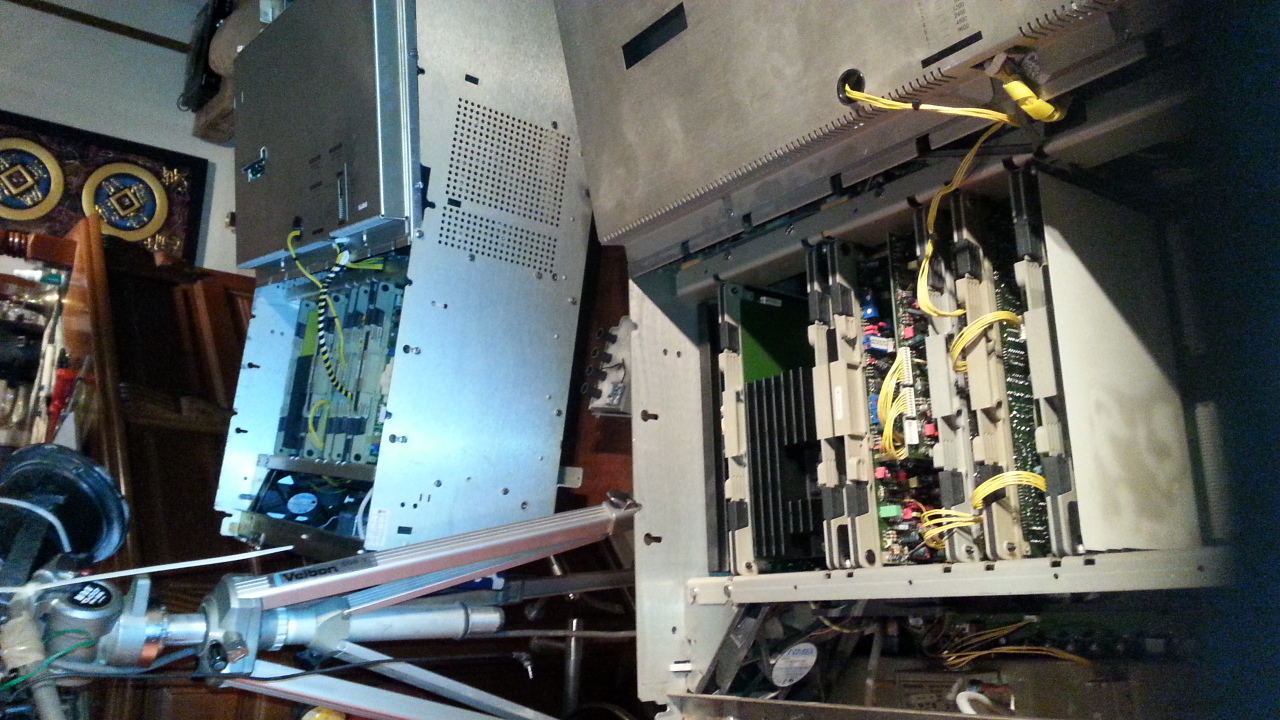

BOTH
BOTH

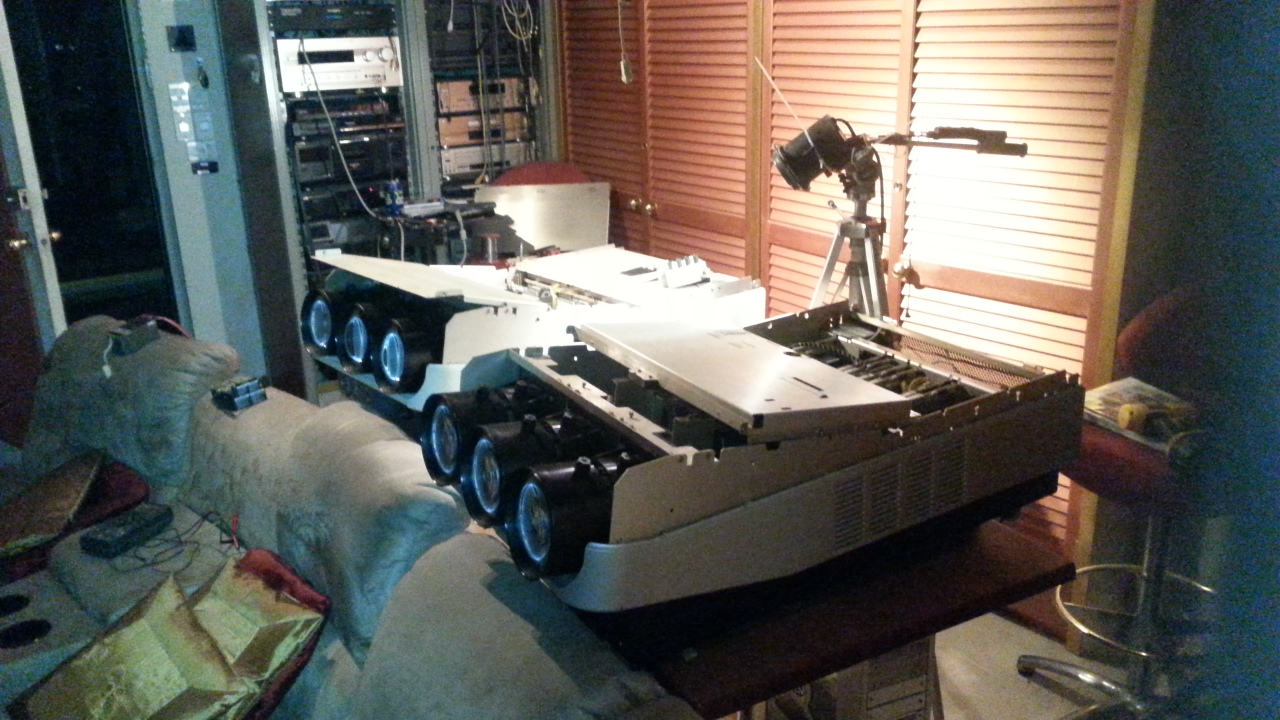

Posted: Sun Jan 11, 2015 2:30 pm    Post subject: Barco Cine 8
THE MESS!!

THE MESS!!
THE MESS!!

Posted: Sun Jan 11, 2015 11:36 pm    Post subject: Re: Barco Cine 8
dentree wrote:
BLUE
Who plastered all that silicone around this blue tube??? Thats a mess. Hope whatever it is its non conductive, i had a big problem with a Sony due to semi-conductive silicones causing issues.

One other thing you asked Casey and that was the state of the silicone stuff on the tubes, well, once again I do not think the machine has been "Tampered" with since it arrive here in Australia, I do honestly believe that
the machine is as bought, the chap I bought it from did not in my estimation, have either inclination nor the expertise to attack the the inside of this thing, so the silicone question will forever be unanswered.
But yes, it is a mess, I only saw it for the first time last night,as it was the first time I had removed that panel to expose the yokes.

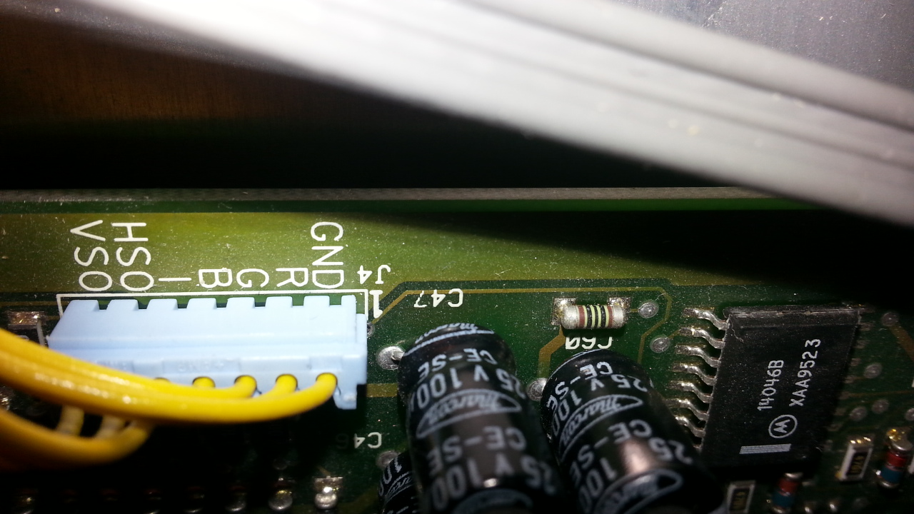

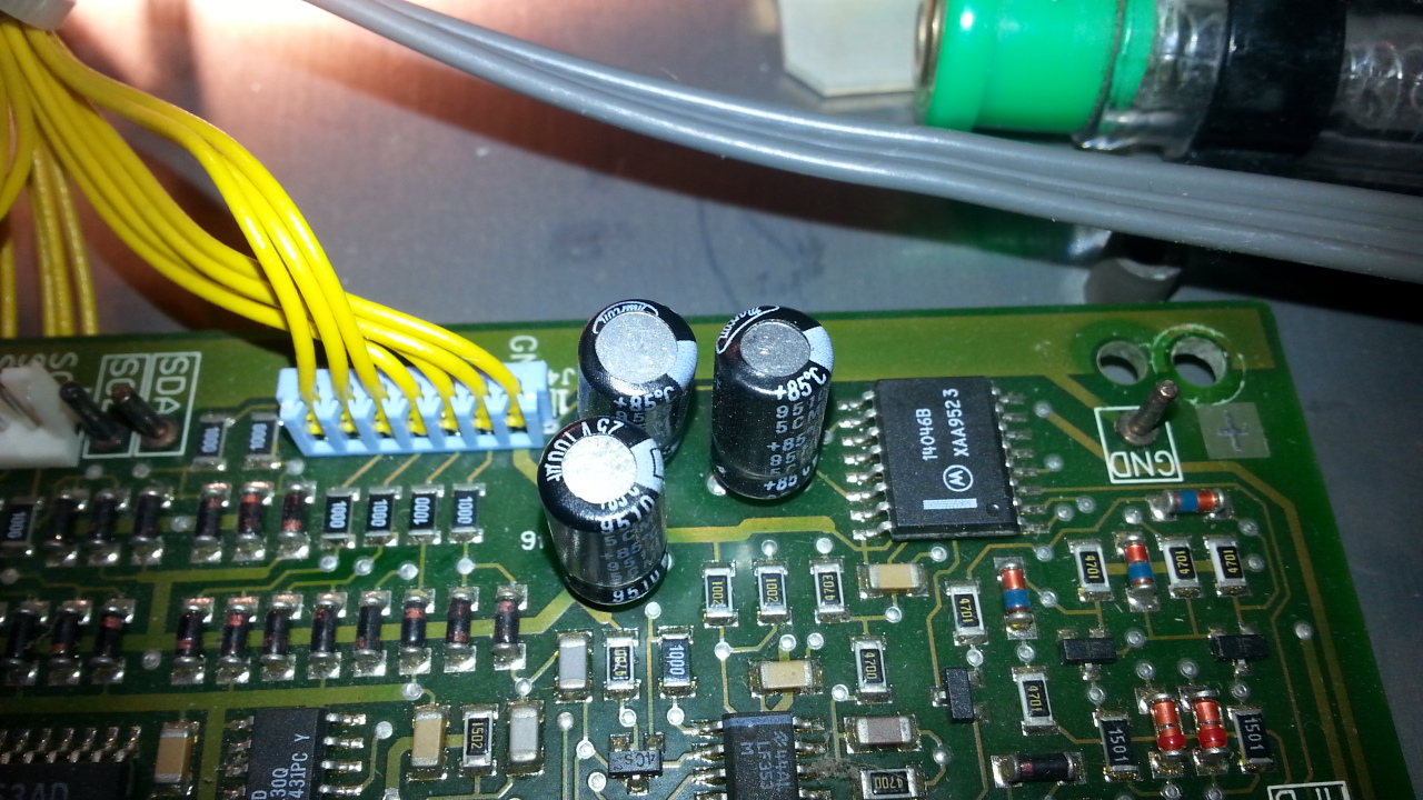

Posted: Mon Jan 12, 2015 4:30 am    Post subject: Barco Cine 8
km98765
Thank you very much for your thoughts, I am in the process of doing as you suggest.
Firstly I disconnected the LIMO and there was NO change in the focus, I have now begun to remove the controller board from the BG 808, but I seem to have run into trouble with the BLUE connector, I cannot see whether it just pulls out like the rest or not, if it is soldered into the board I am not very comfortable about de-soldering it
Could you please advise me on this
Controller board
 Filesize:  456.36 KB
 Viewed:  4962 Time(s)
The LIMO is just a scaler, the cables connecting it will generally only go to their correct places, even though its all yellow wire, the plugs are all different sizes so they only fit one spot.
You dont need the LIMO, its useless for anything other than a Cine 9 or 909.
Swapping any of those RGB input related boards is very unlikely to have any effect of electronic focus!!

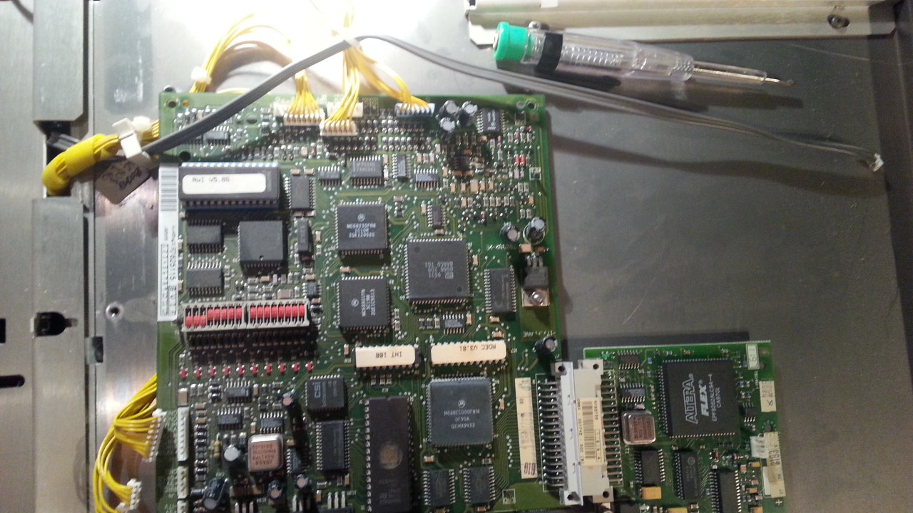

Posted: Mon Jan 12, 2015 4:31 am    Post subject: Barco Cine 8
Controller board
dentree
Joined: 01 May 2009
Posts: 247
Location: Melbourne Australia
TV/Projector: BARCO GRAPHICS 808 BARCO GRAPHICS 801
Posted: Mon Jan 12, 2015 4:32 am    Post subject: Barco Cine 8
Controller board
Controller board
 Filesize:  306.33 KB
 Viewed:  4958 Time(s)
Cant see which connector youre talking about there sorry Trev
dentree
Joined: 01 May 2009
Posts: 247
Posted: Mon Jan 12, 2015 4:33 am    Post subject: Barco Cine 8
Controller board BG 808
 Filesize:  447.09 KB
 Viewed:  4954 Time(s)
