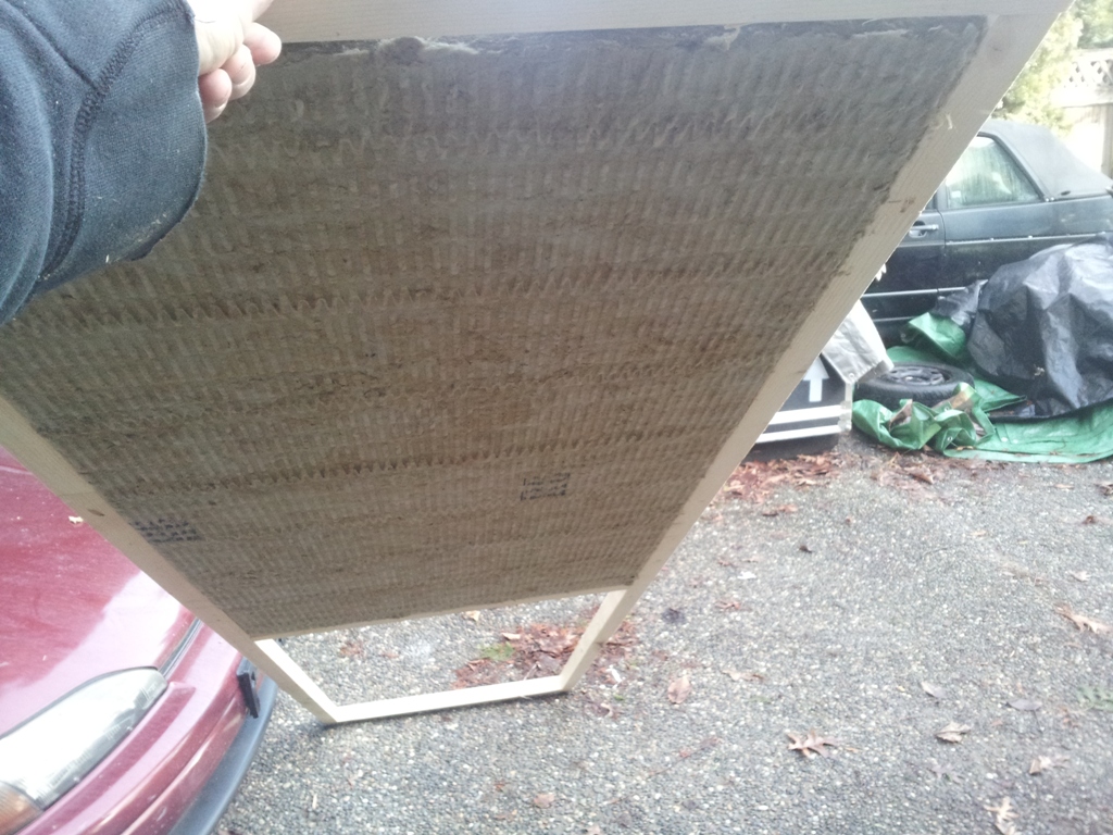

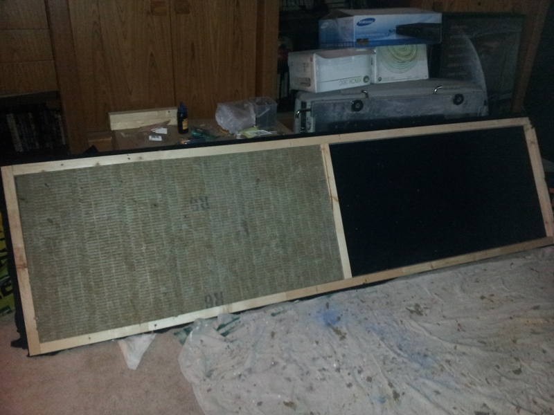

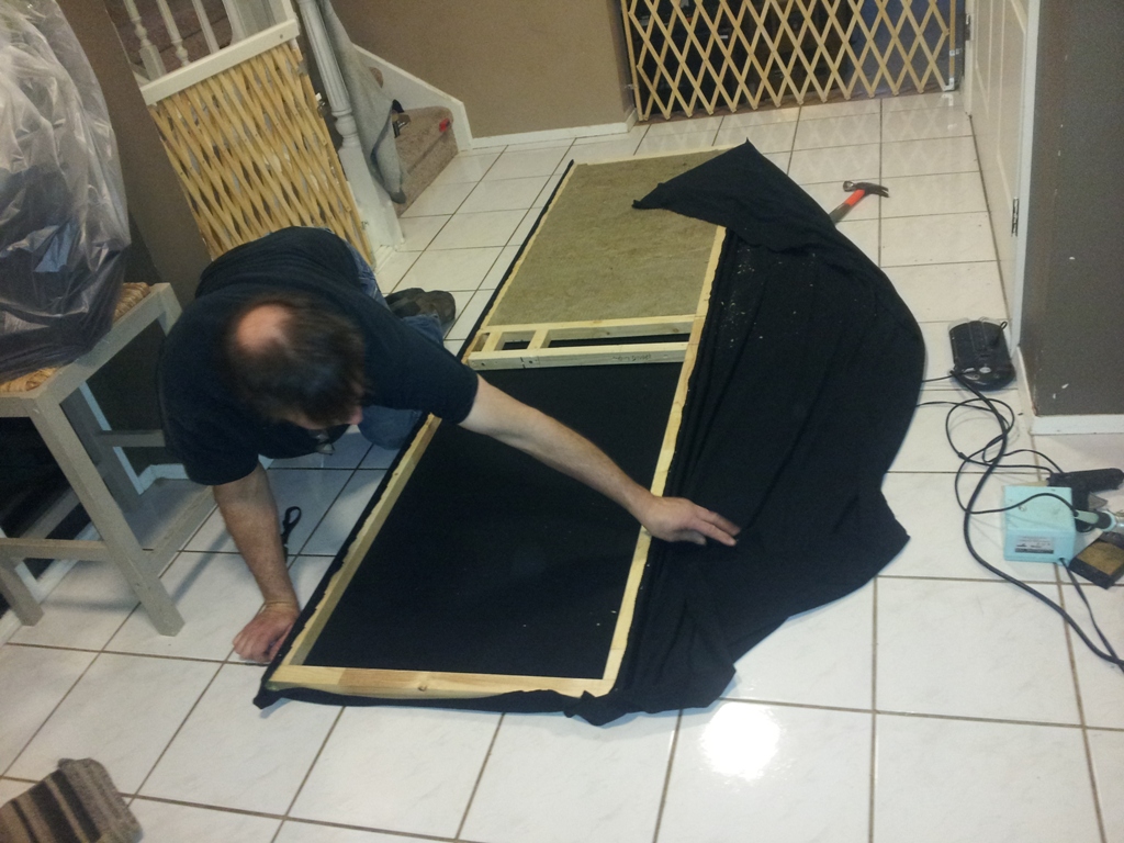

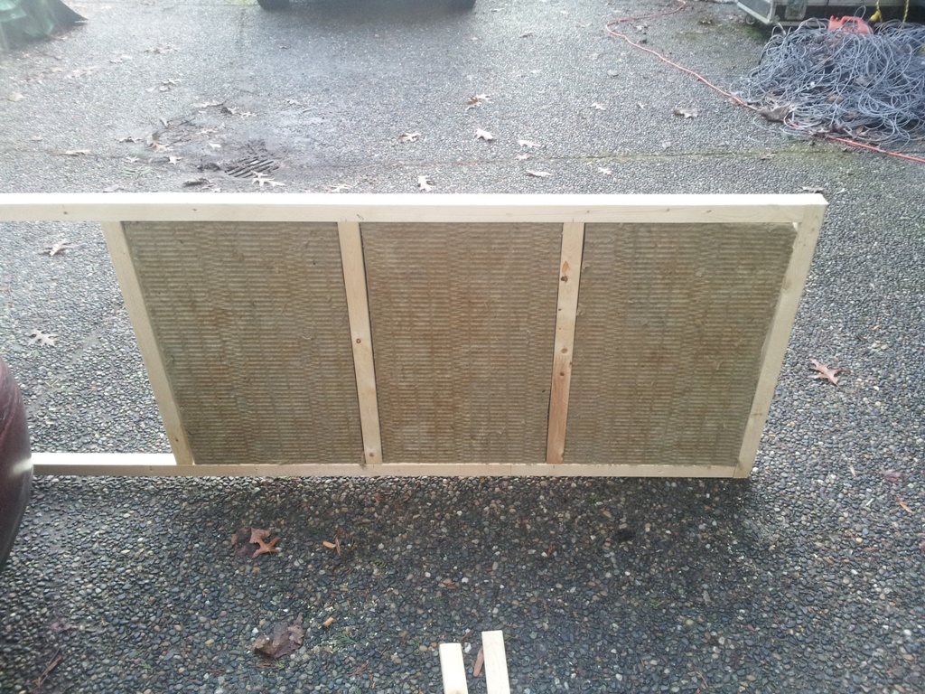

More acoustic panel details. These pix should explain it all. Pay no attention to the balding guy...
