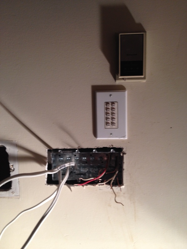

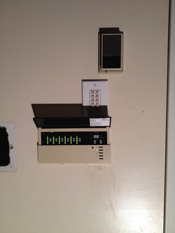

Posted: Sun Jan 04, 2015 5:57 pm    Post subject:
Kinda proud of myself on this one. A CRT customer that had an Ampro 2000 and worked for Lutron gave me this.. oh... 11. years ago! I finally installed it, taking out a single gang box and putting the Lutron in. Before you guys get all crazy about the thermostat, it will be moved down beside the audio keypad. The entire wall will be covered in 1 X 2 frames covered with black cloth as the ceiling is, and we'll put a cutout into the cloth covered panels to access the Lutron and the audio keypad.
Not a bad retrofit for a hack installer that HATES electrical wiring. Now onto adding 2 15 amp circuits for my amps!
The gaping hole to the left is for the 1983 vintage Nutone intercom that's wired throughout the house. It will get covered up by the black panels. Smile

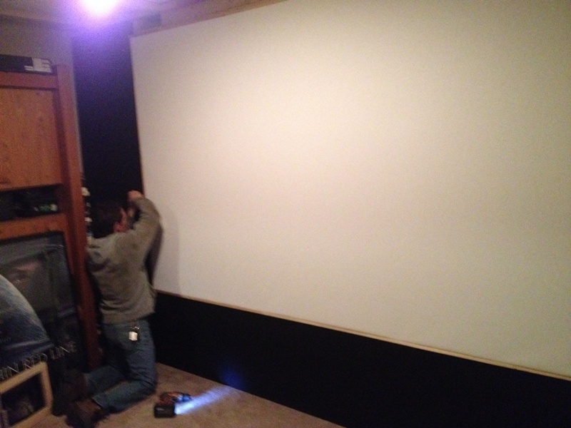

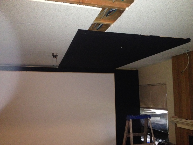

Posted: Sat Jan 10, 2015 9:41 pm    Post subject:
Well, the panels around the screen look great. need to get some black paint for the wood around the screen.

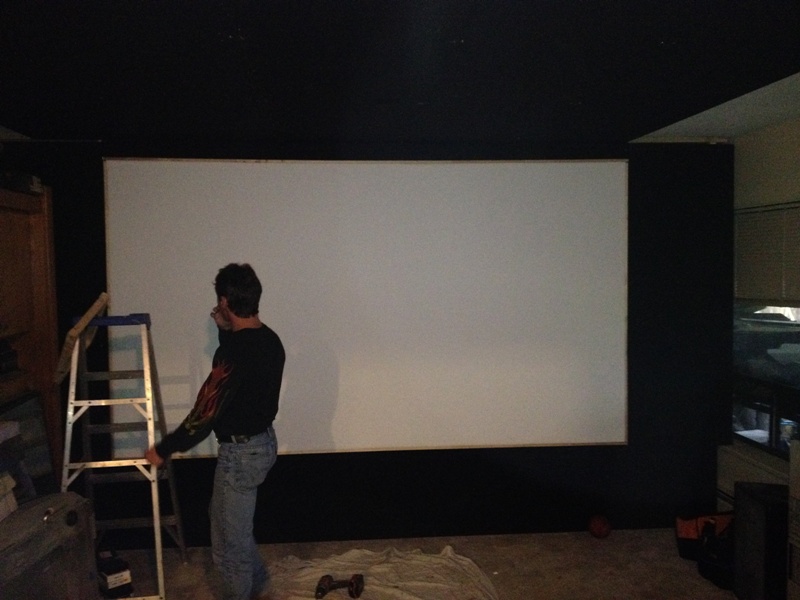

Posted: Sat Jan 24, 2015 9:47 pm    Post subject:
Front row of ceiling panels will be in today, maybe a part of the second row as well. Tomorrow I pull all power amps and blow out the dust, replace the filter cap on my one subwoofer channel so I can run on four 15" EAWs, and I make the patch cords for the rear and front surrounds.

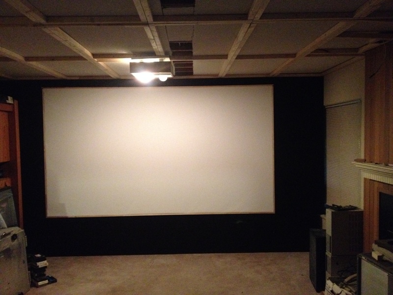

Posted: Sat Jan 24, 2015 11:26 pm    Post subject:
Slow going on these panels, but it's an amazing difference!

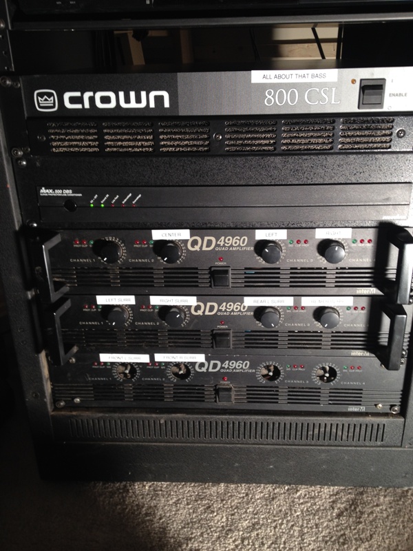

Posted: Mon Jan 26, 2015 2:04 am    Post subject:
I rewired my rack today and made up new patch cords for the surround speakers.
12 channels of 170 watts into 8 ohms for LCR and surround, and 2 X 400 watts RMS for the EAW subs.
I'm not using 3 channels of the amps, they are spares. The bottom amp was a freebie, and was missing the knobs when I got it. Not really a big deal, but I do have the distributor checking to see if they can get them.

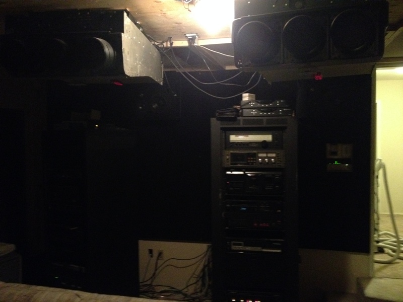

Posted: Wed Jan 28, 2015 2:10 am    Post subject:
Back wall panels are now up!
 Filesize:  114.39 KB
 Viewed:  16275 Time(s)

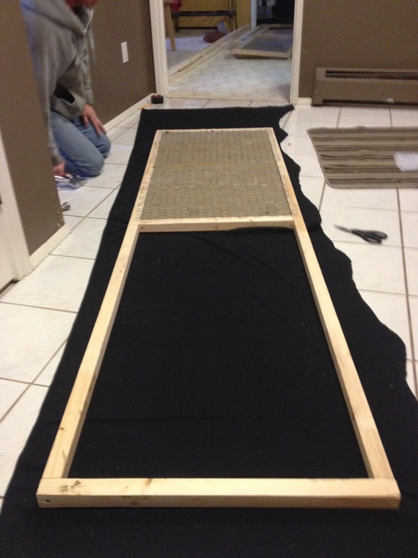

Hi curt,
Your room is really beginning to look great. I'm interested in how you fixed the black panels to the wall and ceiling. When I did a couple of Sound absorbers in my living room some years ago, I attached the 2x2 frame to the wall, then filled it with Ecophon that I got from work. I then covered it all in cloth which is held in place with staples. If you look closely you can see the staples, but they are very close to the wall so you don't notice them. As you made your panels then hung them, can you see the screws that you used to fix the in place?
I wanted to put one on the ceiling, but could not work out how to keep the ecophon from falling out and making the cloth sag. How have you stopped yours from making the cloth sag?
Peter
If only you could see what I've seen with your eyes!

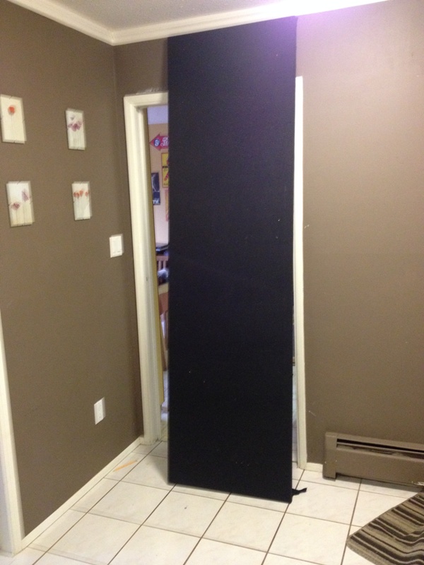

Posted: Fri Jan 30, 2015 10:56 pm    Post subject:
We used black washers and 6 screws per panel. Was going to paint the screw heads black, but they are so unobtrusive, there was no need to. the washers are raised, like on old Sony reel to reel decks, so the screw heads recess right into them.
The frame is built of 1 X 2s, nail gunned together, with a couple of extra 1/2 X 1' across the short sides at the 1/3 and 2/3 marks. Instead of fibreglass pink, we used sheets of insulation that are still fibreglass, but more like bats of insulation, not the fluffy stuff. We notched out the insulation sheets so they rested on the 1/2 X 1s, and there's no sagging whatsoever. We then stretched the microfibre cloth over them, used about 200 staples to support the thin cloth, and used a soldering iron to touch the cloth where we had to put the screws through. With the 4 way stretch of the material, it more or less opened a hole just larger than the screw head, so the screws wouldn't catch the material.
