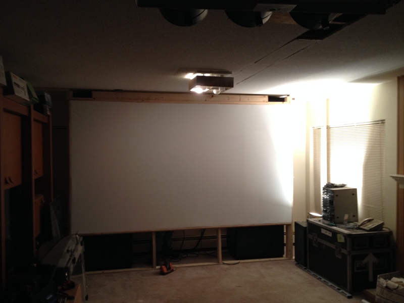

Screen is UP! didn't take much, have a small wrinkle in the top left corner that will mostly be covered by trim. Have to refocus/reconverge as the screen is now about 2" closer to the projector, but not a big deal.
Closeup shot of the speakers as well. Now to vacuum the carpet and get to wiring everything up!

You reckon youll get away without having to move them back?
How close to the edges are you running your tube faces

I managed to get the stack realigned quickly last night, even 2" movement of screen is a PITA. I'm at an average throw distance. There's a bit of tube wear, and I'm not running the sets hard at all, so I wanted to be within the tube wear area, and am for the most part, save for a tiny strip on one projector down the left side. Not visible unless you REALLY look for it.
I finally am running 5.1 properly, need two more amp channels for the front surrounds, and will tie in the rear surrounds this afternoon. Ran the Pioneer calibration program again, and watched Trainspotting and a Frank Zappa 4:3 video from 1985 I think called Baby Snakes. video was awful quality, but the sound was amazing. I am finally hearing surround the way it should be heard.
Turns out one amplifier channel for the subs is intermittent, so I was 'only' running two 15" subs out of 1 cabinet, not two. Considering the whole room is on 1 15 amp breaker incl the two projectors, there's no point in cranking it.
Work has slowed down, so I am hoping for almost 2 weeks of downtime to list stuff on ebay, relax a bit, and work on the HT and the rest of the house. Will post more pix and comments as things progress.
Also one step I'm not looking forward to is to change out the whole controller tray on one projector to see if I can correct the drift. That means full re-setup of 1 projector. that's a good 4-5 hours...

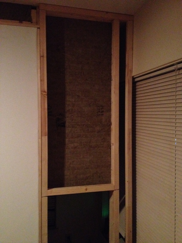

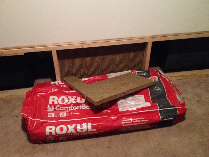

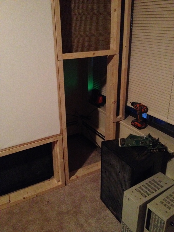

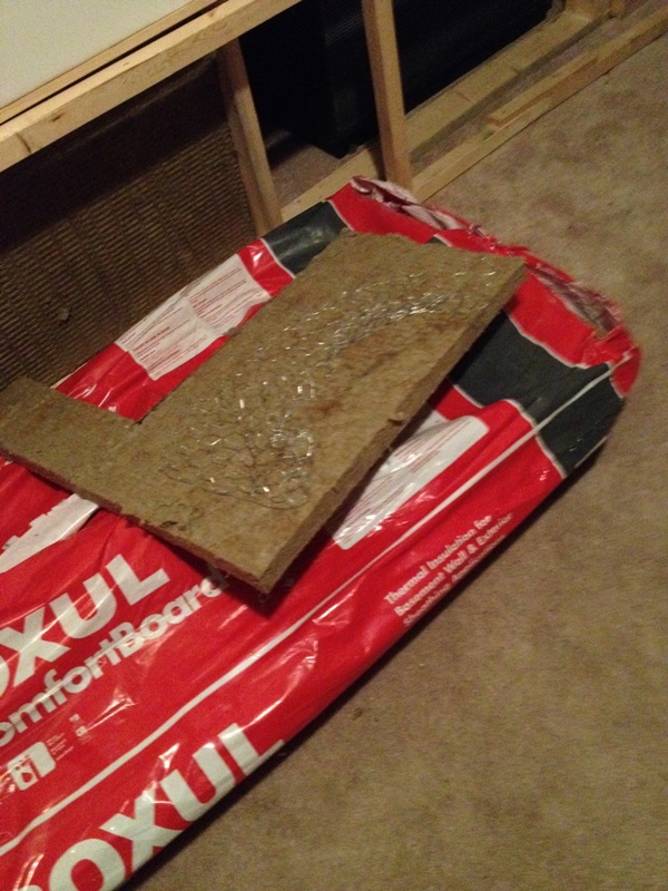

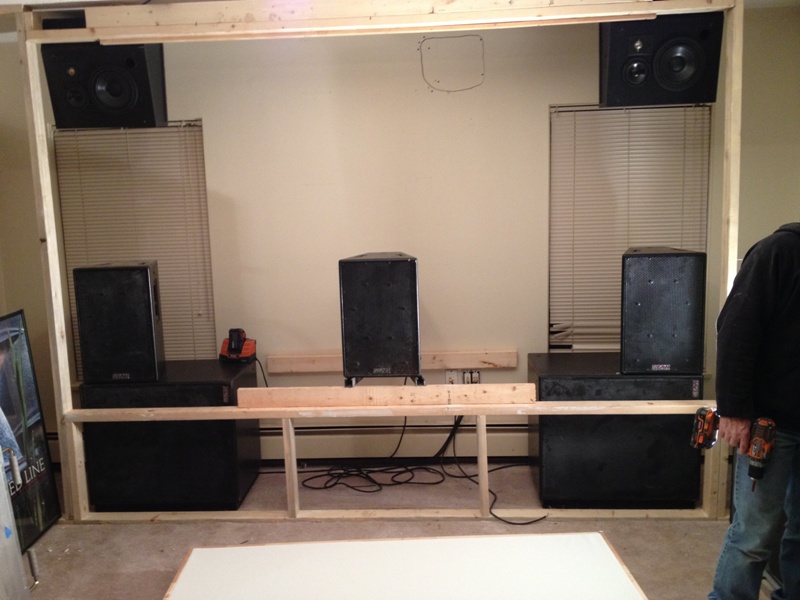

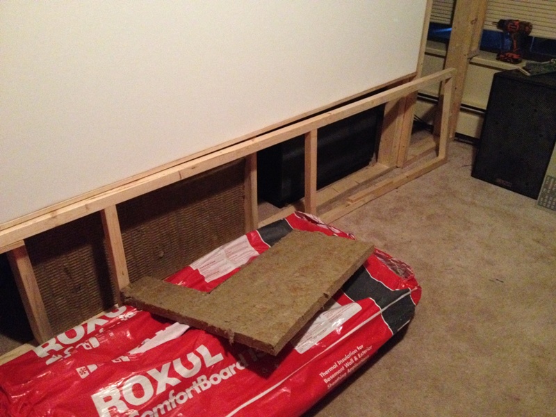

A minor update... building the frames to house the insulation which will be covered in matte black cloth. The first idea was to cover the front and back of the frames with chicken wire to house the insulation, but it's uneven, and will be seen through the cloth. Turns out the insulation sits perfectly, without falling out, so we may use small sections of 1 X 1 to hold them in place, and only put the chicken wire on the backside of the vertical frames.
Will cover all walls and ceiling area with similar, although not every panel will have insulation in it. No need for too much sound absorption as others have said, as a too-dead room sounds as bad as a too live one. Will experiment with that.
The screen frame was mounted forward a bit from the wall, so the panels will be flush with the screen. The material will show up next week, so I'll post more pix. We're buying 2 X 2s like they're going out of style.
the bottom side panel will be removable for access to the speakers if they ever need servicing, although the screen and frame would have to come out if a sub ever has to be taken out. (easy to remove the screen frame without damage to the screen).
More shots to come when the material shows up.

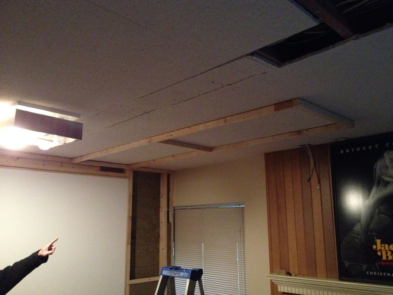

And a bit more progress. Bought all the wood (56 lengths of 2 X 2, 8' long) to build the ceiling and wall samples. The cloth is slow in getting here, so we can't order more until the stuff for around the screen shows up, but we're ready for it when it does arrive.
The panels are simple enough as shown. Made of 2 x2s, some will be full of insulation, covered with black fabric. Will do all around the screen, the entire ceiling and most of the walls. Fireplace will stay as is for now, but we'll have to do something about the hideous 1980s gold trim, which you can't see in this picture.
The windows and sliding door will most likely just be covered by heavy curtains. That's up to the g/f.

Curt;
So one side of the roxul looks like stacked cardboard on edge? What is the stuff in the openings that looks like stacked cardboard? Is that the cloth over your speakers?
