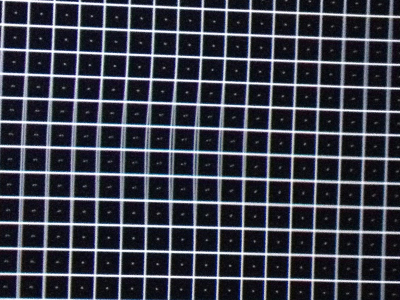

What I'm seeing now is random drifting of small areas of convergence. I thought at first that it was H linearity shift on one projector, but not so. This is what is happening. What I need to do now is narrow down which set is doing it, by marking the screen with painters tape.
Also noticed is that the 'bending' of the lines as per the below pix are global, in other words it's raster changing, the convergence on both sets is solid.
Annoying as heck! I'll be doing some board swaps, as I've seen a tiny bit of shaking from the one projector as well.
Welcome, to the real world.

I would guess that it is something in the smpts2 the power for the convergence because it is only in the middle so not the horizontal deflection but it is all three colours so not on the convergence board but still convergence.

Yes, first I need to figure out which set it is! Smile
Was watching it last night, and there's very slight drift overall. Funny, if I sold either set, they would be perfect, but overlapping, nope, Houston, we have a problem.

Stack held up well through two movies last night. It seems that the slight misalignment as shown in the pix above keeps reoccurring , but in the same areas of the screen, which is weird. I'll have to put tape on the screen and mark each projector test pattern, to see which one is drifting. Then the board swapping starts.
