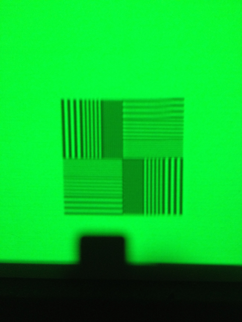

So if port 5 is the best port on the 909, why is all testing not done on that one? It dont make sense to compare different dacs on different input ports with different performance.
So ill think its a good idea to post resolution, input port, and peaking setting to each screen shot.
I noticed that the 2 different pics Case posted, had very different sharpness to them, i have to agree that the port 5 pic from the PC source is the best Barco 1:1 i have seen, would be fun to lower the pixel clock untill its fully resolved, and see what bandwidth it will do.

When the level of the vertical match the horizontal on all 3 colors, and it holds up from Black to White, you have the ability to hit the right level and color at all resolutions, that have a great impact on the image quality, and how you experience it when watching a movie.
Lower the pixel clock is simple, just try run 1080P 50 Hz, or go to 720P 60, or 50hz, just like redfox has shown in anotyher thread.
The reason to look all 3 colors in the end is, that normaly the peaking in the video chain is the same on all 3 colors, but they are driven differently, so depending the amount of peaking, you might have very different results on different colors.
What i was curious about is how this RGB behaves with the PC solution, at what pixel clock it will be able to fully resolve the signal.
Its that simple.

I was referring to this picture:
Posted: Tue Sep 30, 2014 7:31 am    Post subject:
Id have to say i think it is better, it will go to a higher analog resolution, but i havent tried any of this with the 9800GT i have here, its in my 3D machine though so i might be able to test later in the week. Its hard to deny the fact that the RGB output straight from the PC is yielding me clearly better results, but again and ive said simular things in the past, i dont feel the image looks any better from the lounge chair when i watch a movie on it, even if it is clearly better on test patterns.
On my machine the blue tube has issues, it has some slight internal damage that probably occured during shipping of the projector to me, and it wont go fully black without turning the gain way down. To get good greys i have the blue set at 26 gain and 12 cutoff. The red tube is not quite as sharp as the green, but it shows a simular result via RGB.
I leave peaking turned off, which seems to make the vertical lines very slightly darker, but turning it on seems to slightly affect sharpness.
I would like to see Fransisco do some testing between the RGB and the new internal MOOME on his modded 909 too.
When i tried all this on my XG to compare the different HDMI converters i was using a GTX650 Ti, i found the internal MOOME to be about the same as RGB, and the external MOOME V3 to be only slightly better than the HD Fury 3, but for that i was not running stock 1920x1080p timings because the XG has issues with that and it causes major streaking.
Although the CineMAX was clearly a bit sharper, the XG using both RGB and internal MOOME V2 did have the H and V levels pretty near bang on. I think Gábor proved a simular thing via RGB with his 6PG XTRA.
I would be interested to see this done on a well set up G70 to see how it compares to the XG and Crabb might be able to comment further on that, when i set up Aussie_Al's G70 is seemed to have no issues with the stock 1080p timings, it all went quite well, but i didnt feel the sharpness was good enough at 1080p though either, but i reckon it would still smoke a Cine 8 ONYX when set up right.

Yes eyeballing is the way, as no one have all the instruments, so to have a dialog on a forum like this we need to use the best options in hand.
And i think you will be surpriced how much you can see looking into the lenses if you step back to the screen finding the area you like to study.
Fully resolved is maybe not the right Word to use with CRT as this will never be possible, so lets just call it CRT reference level.
Also remember when looking at the end result on screen, you have the total outcome from 3 colors, and a hole lot of info that will be hard to meassure, as when you measure you will need to focus at 1 parameter.
The reason i ask a lot about how it behaves from Black to White running the 1:1 is that its not possible to evaluate bandwidth just using a full on off pattern, specially when there is to much peaking in play.
I posted some shots ilustrating how my G90 will look more right with a lower bandwidth moome Card, i even had it make a perfect 1:1 when playing with filtering, just that it lost all vertical output at low level.
So if all the above paremeters look good eyeballing them, you are running pretty smooth bandwidth/peaking wise.

Yes the card runs fine in the machine. I can't get the Barco to vertical sync. One time I had it syncing using a t-connector and composite than again it refused. I think it is all in very proper cabling.
Do you use a short vga breakout and rg6 from there?
redfox001
Joined: 16 Mar 2009
Posts: 2257
Posted: Tue Sep 30, 2014 2:45 pm    Post subject:
Now I got a vertical shifted image with a very short vga cable so i could just display the Nokia one on one. And it is bad Sad
How is this possible? I have a 30 cm VGA cable (capacitance 83pF)
1080p@60 on port 5 from a Geforce 750ti.
One tip for the Marquee owners. I could not get a sync on the Marquee too but using a very short vga it worked fine. A little better resolution but still bad.
