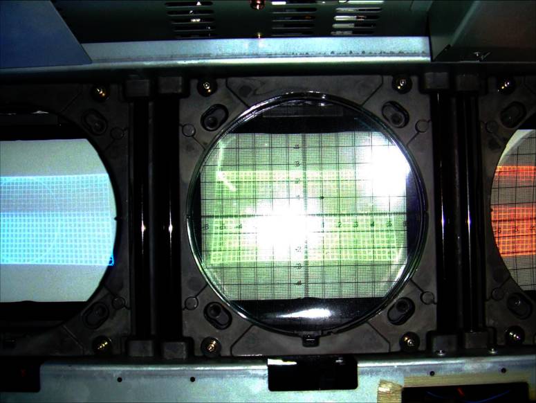

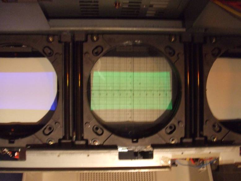

Hi! I've finally bought the NEC 9 PG Xtra, and i must say, as you already know, that it's really excellent projector, very high contrast, beautiful coloursa and sharp images. I've receveid it just 2 days ago, the owner of the projector came to my home with the projector and we tried it to estabilish that everything works, the input, the convergence, the tubes ecc. ( i also had a little trouble with the passcode, but, to my luck, after a tentative we have found it). I read the definitive procedure to calibrate a projector on the site, the official setup manual and the installation manual of the NEC,and i have l a some doubts.
Here's my doubts:
- I've positioneted the projector at a distance of 3 meters from the wall, and after theraster centering, and the convergence and alignment stuff, it came out an image of approximately 115 inches. It came out big like that because i have expanded the image as much as possible with the amplitude settings of the alignement menu to obtain a raster that occupate almost all the tubes faces. The problem is that on the manual says that the ideal projected image of the projector is 100 inches, and i've read somewhere on the site that if the projector it's too far from the wall, the tubes wears faster. But the manual also says that the the maximum projected image can be large 300 inches. So is it positionated correctly to you?
- I project the image on the wall, is it better to project it on a screen, right?
- To centering the raster, it's necessessary to remove the lenses? I guess so because the lenses concentrate the light so it's bad for the eye to look inside them.
For the moment i have this three doubts, if you some advices, they are appriecieted Smile
Thank you and have a good day!

Frankie,
sounds like you're doing really fine. No need to worry.
Don't rely on the sreen size notations in the NEC manual. If you follow the instructions for mechanical alignment you will end up with a significantly shorter distance.
That would happen if you would not fully utilize the full tube surface area which you do.
A screen will be better than the wall, yes. A DIY Sreen can be built for very little money. The biggest advantage of CRT projectors over digital is that a curved screen can be realized much easier. Depending on your viewing situation and audio gear I'd recommend you build a curved screen with acoustic transparent material - that's the best you can get.
For proper raster set up it is best to take of the lenses. Then you can measure the raster and image size. I built myself a tool for that (see pic and this threadhttps://www.curtpalme.com/forum_archived/viewtopic.php@t=5495.html).
The Tube will loock as bright as with the lenses mounted, better turn down contrast all the way. It is handy to have a mirror if you are not routinely familliar with reading the OSD back-to-front. Also you need to check the raster position in the final mounting position of the projector. In ceiling front projection you will need a consideral ammount of keystone correction (setpoint around 60 is normal) so the raster will have some distortion.
