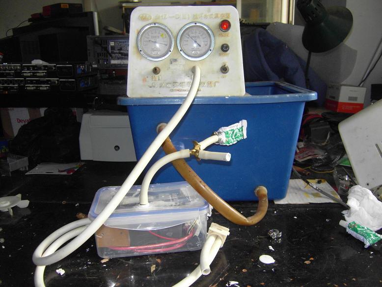

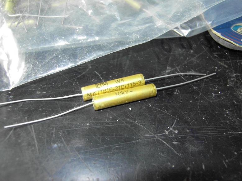

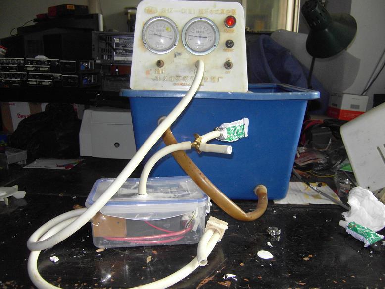

It is difficult to succeed, I use the ERO capacitor has the advantages of small volume high volume capacitance caused by the capacitor with small pitch will seriously affect the insulation level. Vacuum filling is not difficult, I use the South Korean sealing lunch box and ordinary vacuum pump can do, filling equipment cost no more than $200.

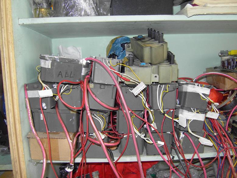

Figure is the most complete the repair, Barco EHT, to replace all the capacitance is too complex. The damaged EHT only replacing the damaged 2-3 can work for a long time, EHT would not be 7 capacitors and damage
Repair the case too much

The ERO capacitor is the most ideal volume

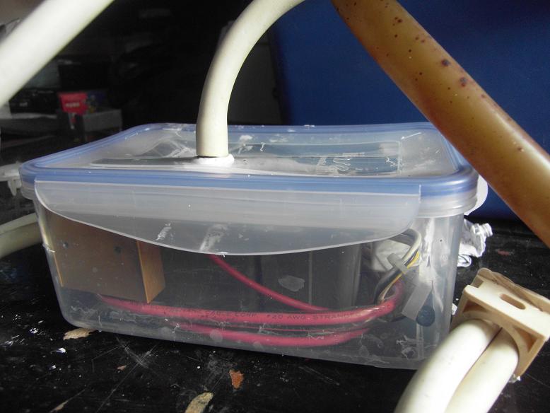

For plastic lunch boxes need to support, the vacuum will make lunch box contraction

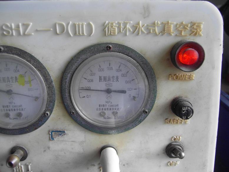

To achieve this degree of vacuum can filling silicone.

zxh398 Thank you for sharing pictures.
I can see you are using '1000pf' capacitor for replacement.
Is it fine to mix different capacitance in same unit?
I mean original caps are '3000pf' and your replacements are '1000pf'.
and I have some broken diodes in my quadrupler.
what diode did you use for replacement?
anything above 10kv rate are good?

It is surprising that that plastic container withstands atmospheric pressure without leaking or crushing.
