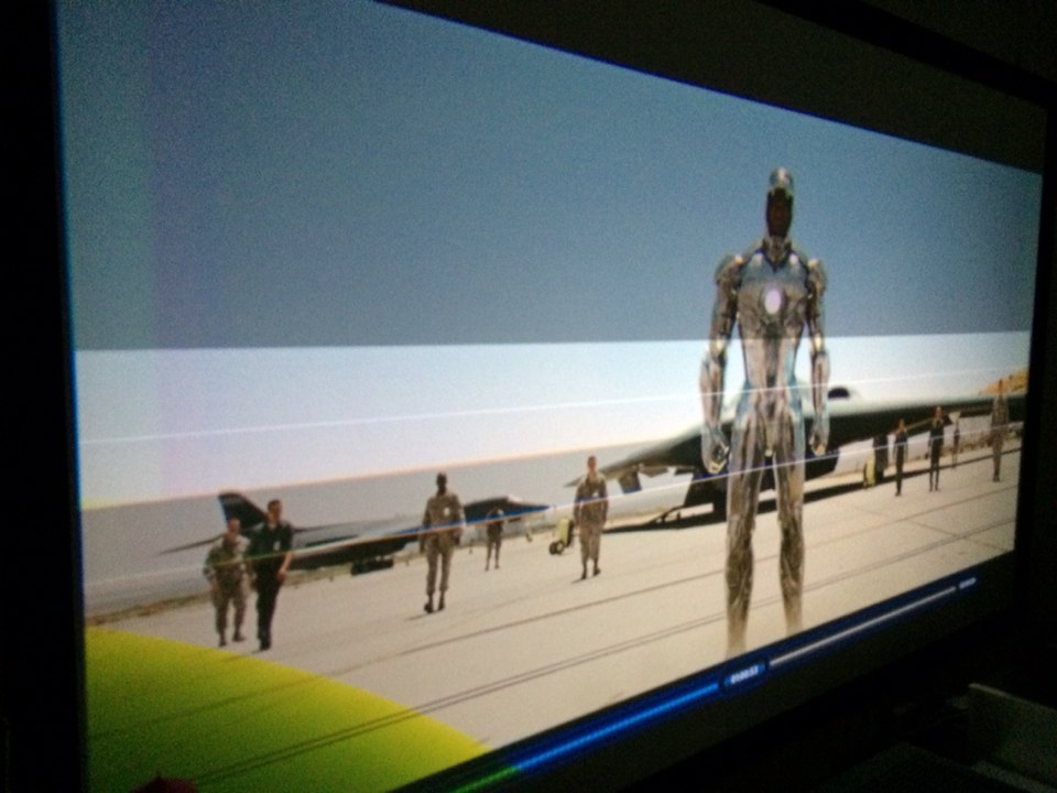

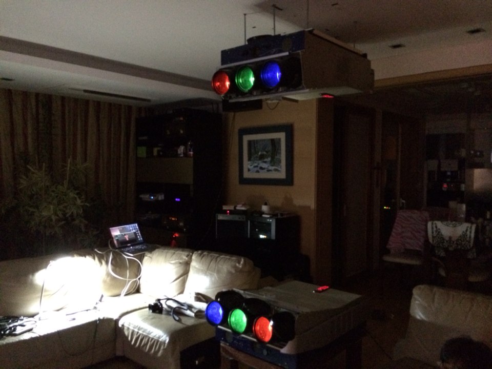

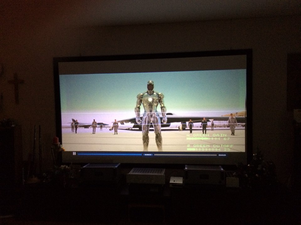

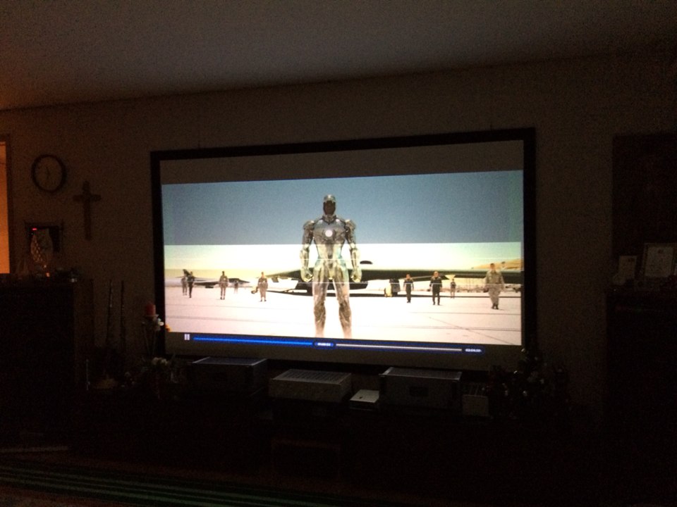

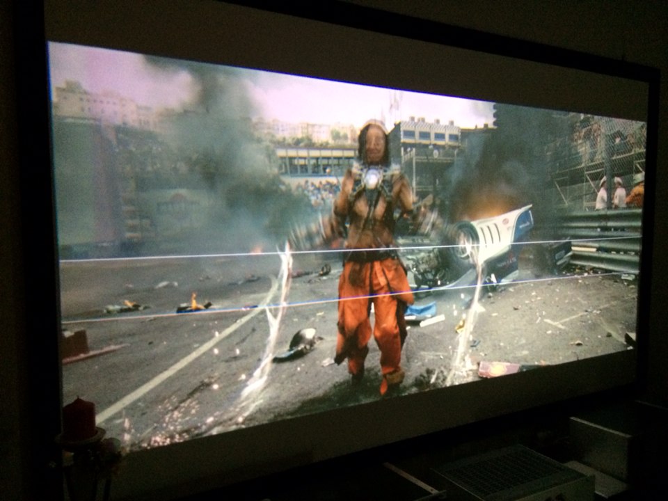

Posted: Thu Jun 12, 2014 3:58 am    Post subject:
OK..
now my setup is a top and bottom. not a side by side.
I need a full working setup for my happy movie life. so until I get my new cinemascope screen, this setup will works for me.
This is just for testing. this setup use a half of entire phosphor one pj by one. So there is no benefit of edge blending Laughing
bottom pj has green tube wear resulted from the previous setup. You can see brighter area on the top of the screen.
(white thin lines on the screen are due to using of a trial software)
top and bottom setup. actually this is a full stacking 16:9 setup.

Turning off the blend zone mask. u can see the blend line.
 Filesize:  102.85 KB
 Viewed:  6102 Time(s)
same as above.

Turning on the blend zone mask.
 Filesize:  95.74 KB

This is the best screen shot. lol
 Filesize:  121.1 KB

Posted: Thu Jun 12, 2014 5:22 am    Post subject:
I can't see the pics but i would do a full blown stack when I got new tubes if it was me

Posted: Thu Jun 12, 2014 5:23 am    Post subject:
Never mind they work now(stupid internet)

Posted: Thu Jun 12, 2014 5:25 am    Post subject:
Looks great now all you need is a good green tube to do a stack Smile
