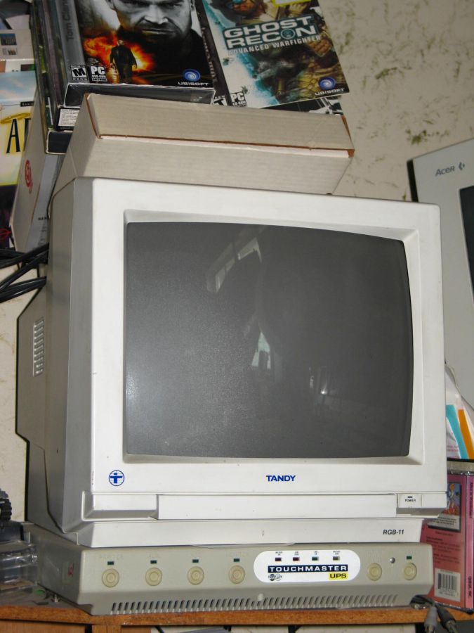

Yes there were interlaced resolutions back in the CGA and EGA days (pre=VGA adaptors) on PC's. That was more when you had 40 column and 80 column displays and RGB monitors that ran at 15KHz or 320x240 with up to 16 colors!. I have one here Tandy brand OEMed by Magnavox. It worked well on the 1980's IBM XT's and 286's and the Tandy COCO 2 computers.
However when we got VGA starting at 640x480 things got de-interlaced or aka progressive scanned.
By the way, next time you watch T2 check out the computers they are shooting up. You'll see the same monitor as the on I have.
Tandy RGB-11

I never thought I would see one owned by someone who wasn't a movie company nice
I have a few vintage macs that Were made in the early 90's(they were nice)
I didn't like the interlaced monitor I had(it would give me headaches after long use)so I gave it away
