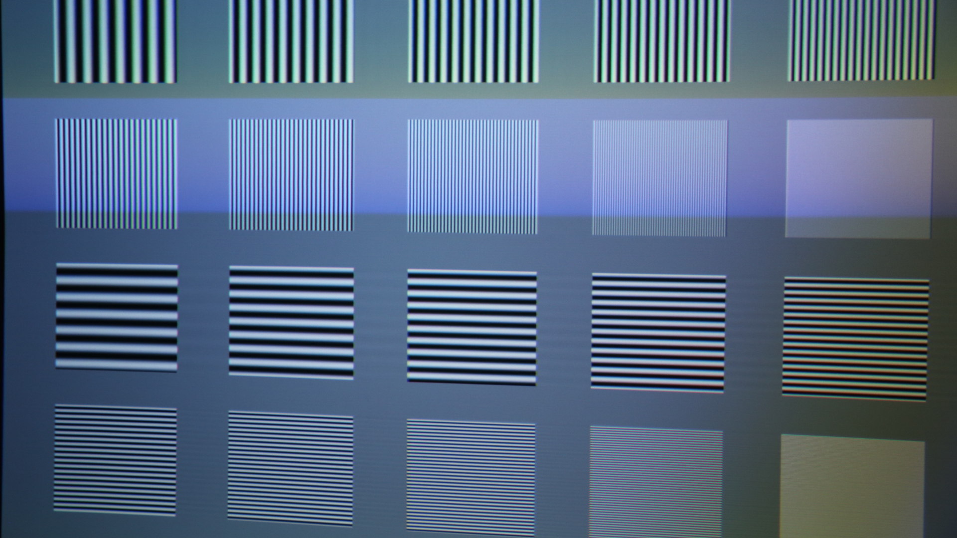

The new moome card in the G90.
Green tube displaying the Croma multiburst.

Craig, can you please post a picture of your G90 showing the croma multiburst on screen, and the green tube face of that pattern.
If possible both the 3D moome card, and the one before it.

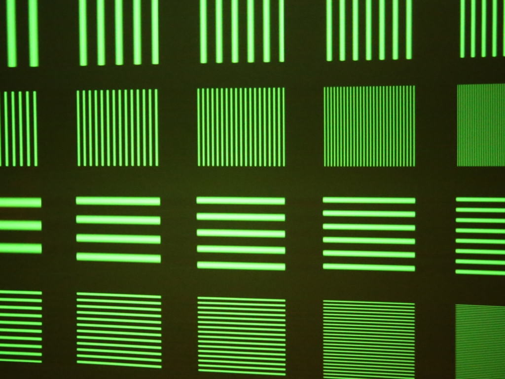

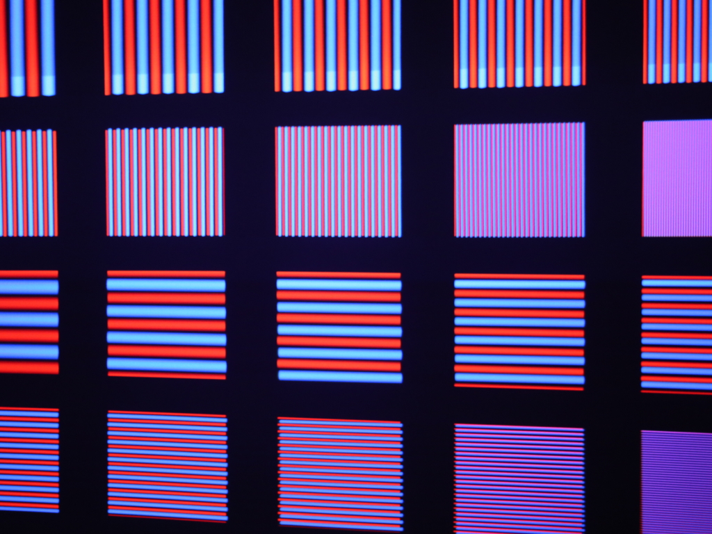

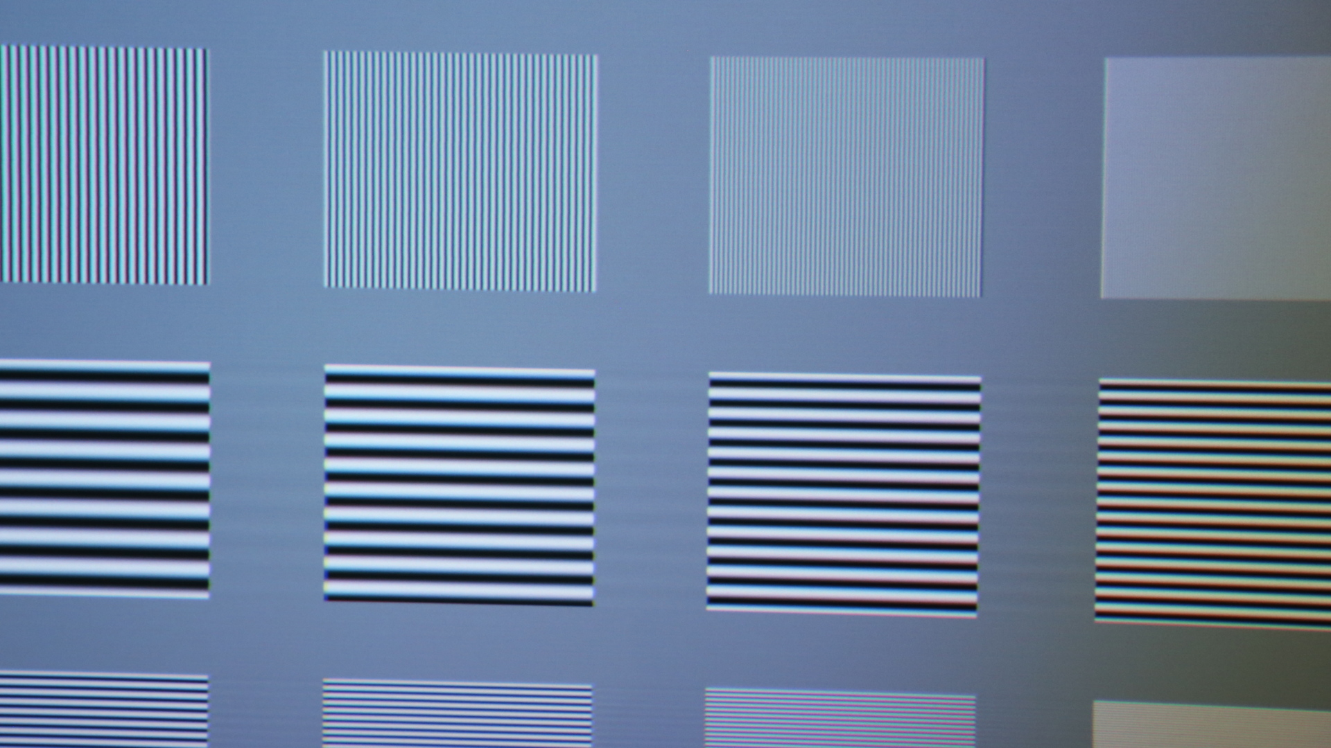

Posted: Thu Jun 26, 2014 4:18 am    Post subject: 1080p from Ps3 g90 at 30 and 68 on brightness and contrast
Here are some screen shots for my G90 via hdmi with moome card v2 playback from ps3
Brightness and Contrast 30 & 68
Chroma Multiburst With RGB and G only
And some Game of Thrones images
 Filesize:  625.93 KB
 Viewed:  12953 Time(s)
 Filesize:  655.33 KB
 Filesize:  720.1 KB
 Filesize:  657.16 KB

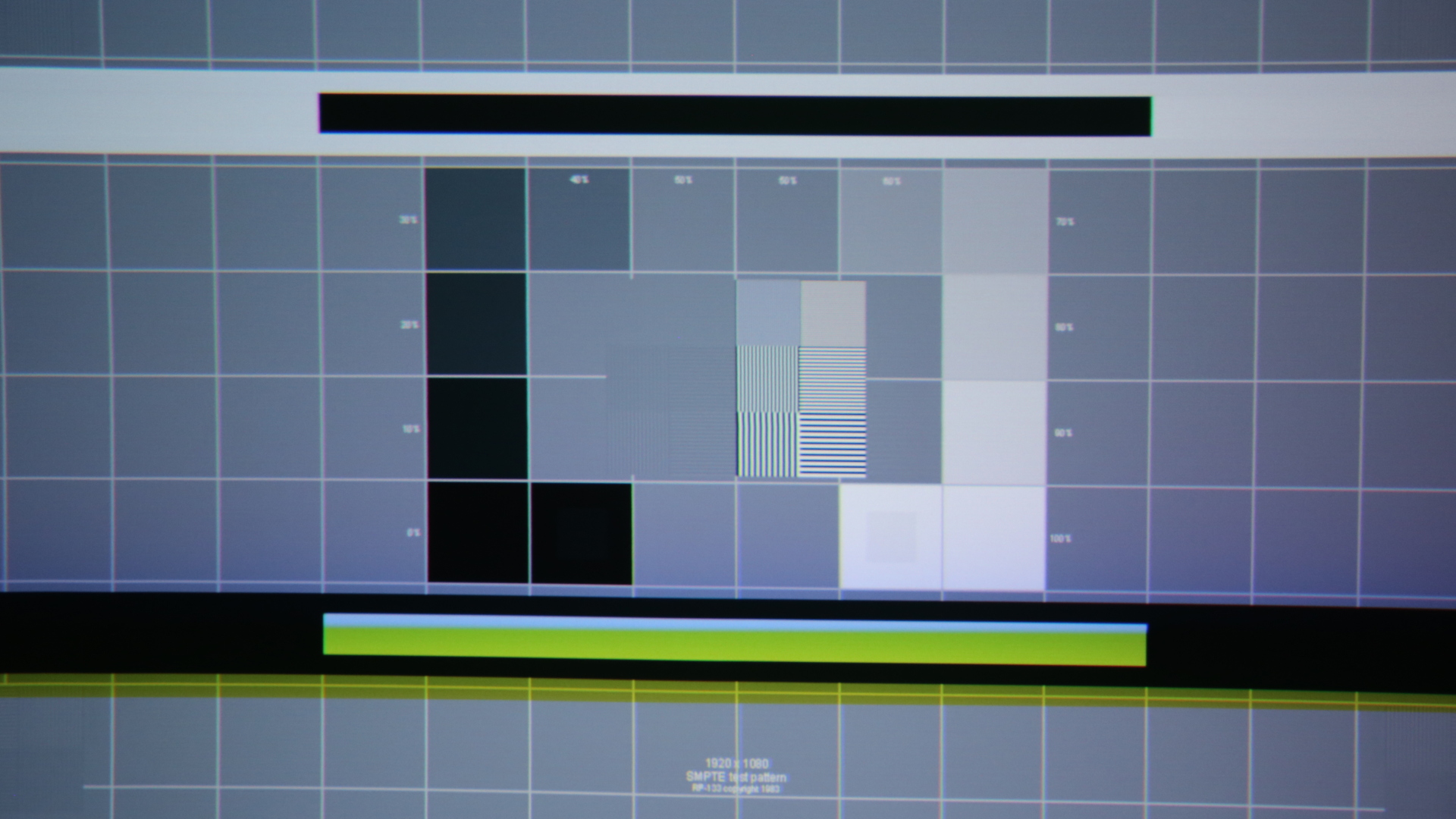

Posted: Thu Jun 26, 2014 4:21 am    Post subject: more
These have a darblet in line
 Filesize:  734.26 KB
 Viewed:  12954 Time(s)
 Filesize:  697.36 KB
 Viewed:  12950 Time(s)

Posted: Thu Jun 26, 2014 3:34 pm    Post subject:
Thanks, nice green tube shot of the croma multiburst.
That is a good indication about how bad the new Moome HDMI card is, compared to your V2.
Other than that it looks as ill expect, some peaking, some problems with the bandwidth running 1080P 60hz.
It looks like you need to work some on the focus, and see if you can get it sharper.

Posted: Thu Jun 26, 2014 9:44 pm    Post subject:
I did see where some of the focus could get a bit tighter when I looked at the VE resolution chart.
What are you seeing with the peaking and Bandwith ?

Posted: Thu Jun 26, 2014 11:11 pm    Post subject:
I think yours look like it do a nice bandwidth performance from a G90, not sure how your moome card behave, but for sure your green tube shot of the multiburst, is the best i have seen from a CRT. I would like mine to look like that, but not possible with the input card i have at the moment.
