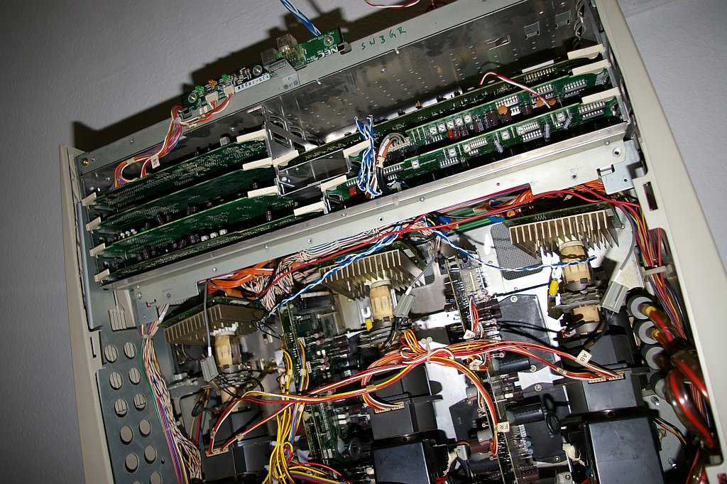

I could set the colors! It needed a bit of tweaking in the reference menu, since I ran out of G2 range (I could not set G2 low enough) so I had to adjust "bright bias" that shifts the range of the G2 range.

After more than two years I can say this project is DONE!

Modified boards not fitting well to my wallet Smile Besides, I did some (performance aimed) modification to the VNBs myself. And as you could see it does not show significant roll-off at 310MHz pixel clock (some distortion yes), but I use my projector at 1080i 96Hz anyway, that is only 138MHz pixel clock. These boards do that with ease, at some point I may play with the opamp, but other than that I can't imagine any other modification that could seriously affect performance.
Here are some highlights about this XG-VNB project:
-The neckboard output stage (+/-85V) is fed from a totally separate power supply from the projector.
-Each neckboard has an own local (low noise, high speed) regulator that feeds the low level analog circuits.
-The whole input stage is bypassed on the VNB, my interface board directly drives the output stage of the VNB.
In fact based on this design I had a faint idea to make a similar baughterboard specially made for Marquees, that would contain all the performance related circuits at one place, so the VIM could be ENTIRELY bypassed from the signal path, and the VIM would only supply the menu OSD signals to the neckboards, and do the input signal's sync processing. But I don't think anyone would want to wait another 2 year for a board like that. Smile
