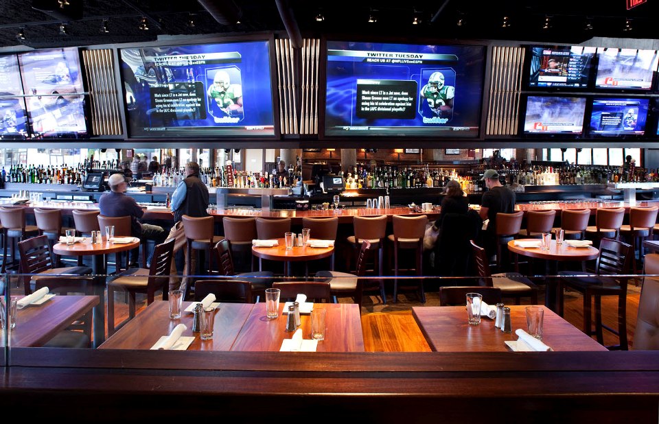

Maybe someone here can give me assistance with a basic learning block I'm struggling with.
I understand the basics of Irule now, can muddle myself through setting up the hardware with Wifi or an IP address, etc.
What I'm having trouble grasping is how to link to a secondary page from the home page. I've done it twice before, but have been sitting here for 2 hours this afternoon, trying to do it with no success. Can't find any tutorial showing how to do it either on the Irule site.
Here's what I've done (and this is for my demo system..)
I've got my home page showing a bar, with 10 TVs over it. (see below).
I've created invisible buttons over each group of 4 TVs at the far left and right, and another invisible button over the two TVs in the center. Each of these buttons have been converted to links as per the tutorial. I now have no idea how to open the secondary pages when I press those 4 links on the home page.
The tutorial says : In the Link properties, select the panel name, page type and page name of the page that the Link will jump to.
Well, I can't do that, because I can't type in the page that I want the link to jump to!
So fundamentally I don't understand how to get a 'link' function to open a another page. HELP, I've been staring at this for 3 hours now, and am getting nowhere!
In the pix below, I want the button/link that I press that's on the leftmost 4 TVs to open another page that shows those individual TVs. Ditto for the rightmost 4 TVs.
I have created 2 pages that shows 4 TVs, called 'LEFT TVs' and 'RIGHT TVs', but I can't get the main button to link to those pages.

Curt,
You don't need to type anything; Once you select a link, you then use the Properties box to:
1) Select your target Panel from the 'panel name' field/menu
2) Select your target Page from the 'page name' field/menu
You must select a target Panel from the Panel first. Once you do, that will then populate the 'page name' menu with pages from the Panel you selected.
Posted: Mon Feb 24, 2014 11:40 pm    Post subject:
OK, that's where the confusion comes in I guess. What's the difference between a panel and a page?
I've created 3 extra pages, one called 'Right TVs', one called 'Left TVs', and then the 'master off' page.
I'm still stuck on how to tell the link on the home page to go to the new pages...
Posted: Tue Feb 25, 2014 12:26 am    Post subject:
Think of a Panel as a folder. It's more than that, but think of it first and foremost as a hierarchical element. A folder contains things; a Panel contains Pages. Pages are what the user sees and interacts with. So, when you point a link at something, you point it at a specific Page IN a specific Panel.
There is no hard/fast rule for how to layout a remote. I've seen people build a giant remote of 20-30 Pages in a single Panel. I don't recommend that, and we had to limit Pages to a Panel because people were doing crazy things and it broke certain functionality. So, normally, you'd let organization, function, and user experience determine the layout.
With the built-in templates, Panels contain Pages for a certain activity, i.e. Watch TV or Watch Move. Within the Watch TV Panel, you have 2-3 pages for controlling a DVR for instance.
In your case, you might lay it out like this (first level is Panel, second is Page):
Home
- Home (layout) of TVs
TV1
- Control TV1 (modified iRule Watch TV page)
- TV1 Favorites
TV2
- Control TV2 (modified iRule Watch TV page)
- TV2 Favorites
TV3
- Control TV3 (modified iRule Watch TV page)
- TV3 Favorites
And so on. This assumes the TV tuners are controlling the content with a modulator or whatever.
If you were only powering the TVs on and off and controlling with a matrix switch and DirecTV or DISH receivers, then the remote would look a little different. In that case, you'd make tuner control pages for each tuner (or a single tuner control page and use Variables to set which tuner the user will control), and probably a single page to make source/display selections. You could probably build a remote like that with 2-3 pages.
Let me know if that doesn't make sense.
