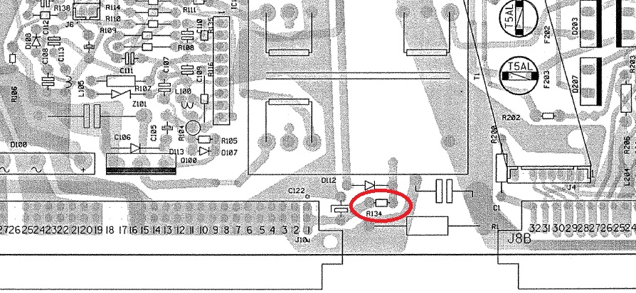

Another thing to be mentioned:
On either of Your main SMPS boards check resistor R134 (0.1 Ohm 0.4W fusible resistor). I had one SMPS where this resistor was blown and kept the EHT board inactive.
Regards,
barclay66

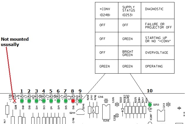

However, according with service manual, the two leds of diagnostic board show "OVERVOLTAGE" condition or "STARTING UP OR NO +CONV"
The second led lit but no bright.
I checked several times the 17v on SMPS board.
I need to check somewhere else?
Domenico (Barco fan!)

Posted: Fri Feb 07, 2014 1:37 pm    Post subject:
none of the LEDs should be brighter than the others. If D253 (in my picture No. 10) is brighter then this is an indication of a problem.
Please see my picture below. Exactly which of the LEDs is on or off. As I understand, LED No. 8 is off (this is OK) and LED No. 10 is off (problem) and one of the other LEDs No. 1-7 is off. Which one?
Regards,
barclay66
