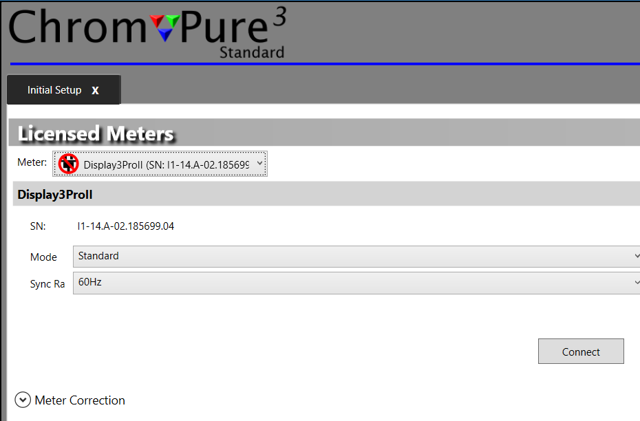

1. Section 1.2.1 - I have a setting for SyncRa which I do not see in your walkthrough screenshot. I'm not sure if this is because we are using different meters or not but I do not see that mentioned.

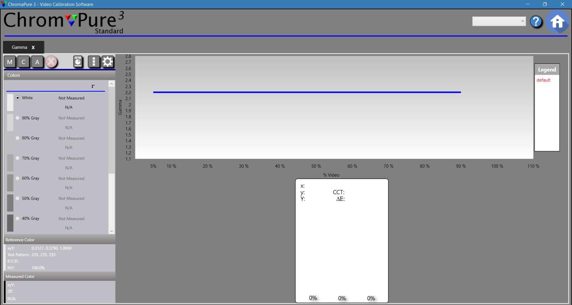

2. Section 2.4.9 - You state "The errors (dE) are shown as CIE94 in the image above. If all are below 2.0 then you are done. If they are not, then make the necessary spot adjustments to reduce the errors as much as possible. " First I don't know what dE corresponds to in the screenshot above that statement and that is probably my fault but I don't see anything in that image that is "below 2.0" which you would be referring to.
3. Section 2.5 - My Gamma module looks nothing like this. I believe it's all the same information but it looks completely different.
That's as far as I've gotten in my muiltiple testing/learning in the past week with a few TVs, devices, and sessions.
I have a Display 3 PRO myself (not the standard meter) so I don't see this. I've sent a note off to Tom of ChromaPure to clarify and will update the guide. SyncRa is likely "Sync Rate". Not sure why it's cut off - do you maybe have your font set larger than normal? (Not that that should matter - software should accommodate). 60Hz is the refresh rate of most displays so it's likely fine.
Good catch. These are the old screenshots. I've now fixed it.
Ah. You could be right. My laptop has a high resolution screen so I had to bump up the scale a bit to make it manageable. That could very well be.

I've now added some clarification on the Scan Rate option to explain.
This is a feature that was introduced by X-Rite in the Rev. B version of the i1Display Pro. The three choices are:
60 Hz
50 Hz
24 Hz
For most sources use 60 Hz in N. America (Sometimes 24 Hz, if that is what the user has set the display at. If the user doesn't know, then they should use 60 Hz). 50 Hz is for the European system.
