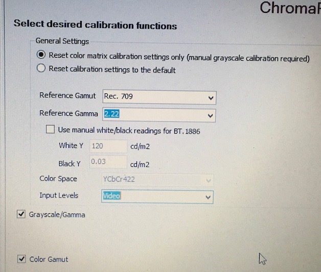

The version I use (2.5.8) has more options in Auto-Calibration (see the attachment) than the very simple one shown in the video. Are the videos based on an even earlier version? Or do you see different options depending on what processor (DVDO etc) is used?
First it gives the option to reset colour matrix calibration settings only (the default setting) or reset calibration settings to the default. I'm not clear why you'd pick one over the other.
Then there's the box for 'Use manual white/black readings for BT.1886' with a couple of boxes which looks like you can fill in your own values for those (though I couldn't, they're greyed out).
I'm calibrating a 4 year old Panasonic VT50 which seems to only have a maximum brightness of about 45cd/m2 (that's if I've measured it correctly). Nowhere near 120 cd/m2. So does that mean I would be better to enter a manual value of 45 in the white box?
I find the videos explain what options you have, but not why you would choose a particular setting (an example is the 'Selecting Options for a calibration session' video). Maybe it just requires more reading elsewhere Smile I've read CHROMAPURE GRAYSCALE & COLOR CALIBRATION FOR DUMMIES and the Chromapure manual.
My last calibration I selected 'Reset calibration settings to the default' (thinking I don't want to do a manual greyscale calibration - I'd rather it be done for me?). I left the BT.1886 box unticked and selected Video in the 'Input Levels' box. Was that the best thing to do?

1. Neither. We just simplified the UI for v3.
2. Some people had asked that the reset not change the grayscale because they wanted to do it manually. The v3 grayscale calibration is much better so this is no longer needed.
3. In v3 you make the gamma setting in Options, Gamma. In v2 the gamma selection is in the module.
4. If your plasma is only getting a max of 45 nits, then it is broken. Are you measuring a window or full field? What Picture mode are you in?
5. Yes.
Your questions are the main reason we simplified the UI in v3.

You are not prevented from doing manual grayscale. The module has checkboxes for color matrix and grayscale. If you leave grayscale unchecked, then auto-cal will not touch it.
