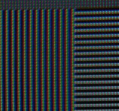

They indeed look differently to me on PC, but I think that is because the vertical lines consist of RGB pixels meaning the left side of the pixel looks redish the right side looks blueish, while on the horizontal lines there aren't such a problem obviously.

No, I wanted to support your observations. I tried to catch the effect on my LCD screen... this is because the RGB dots are not overlapped on LCD/CRT monitors.
