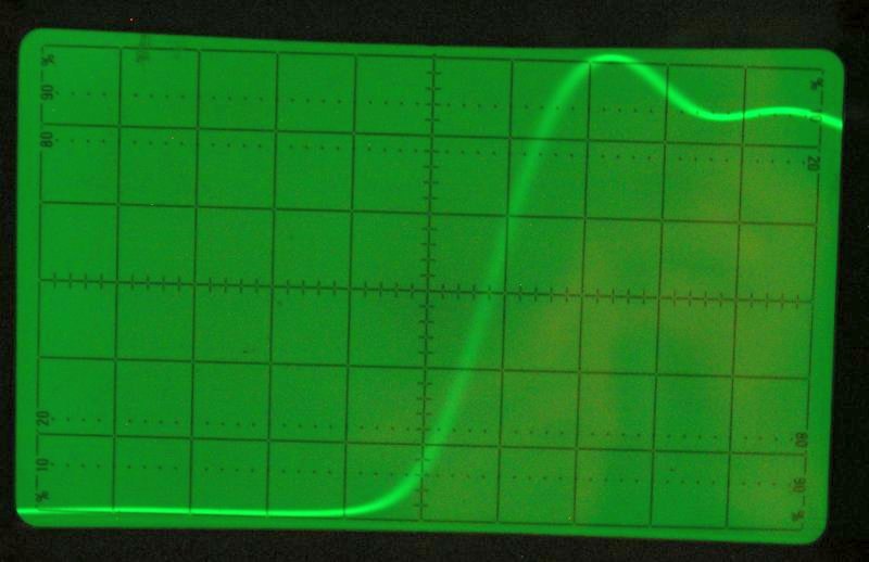

A 18USD Chinese HDMI to VGA converter:
The output was awfully filtered as it came, it could not even resolve 800x600 60Hz according to the oscilloscope, moreover one of the output termination resistor was a wrong value, so the output levels did not even match.
But after removing the filter network and correcting the termination it revealed that the output rise time I could measure is around 1.6ns, which would equal to ~375MHz analog bandwidth, that is quite good, with adding a filter of course would affect this speed, but the raw power is there for sure. It drived my 3m long RGBHV cable with ease.
There is only one video IC there an EP94Z1E.
Despite the specs say it only supports 165MHz pixel clock, but my short test showed it even put out 1080P 96Hz (~250MHz pixel clock)!
