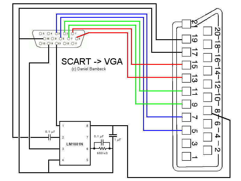

i guess its something like this, but how do i do it with just one video bnc out?

Curt, the playstation has an RGB output, the only problem is the sync is tied in the signal in a way how the NEC don't recognizes, so that's why the above circuit: to peel the sync. for the existing RGB signals.

Buy a playstation SCART cable, follow the pictures posted, connect RGB up to R, G and B, make the sync cleaner, connect the output of that to the H/V sync on the PG.

Look, very simple. The OP can't follow the schematic above, so he says. I therefore offered a simpler solution, although yes, with less of a picture quality. A quad decoder board, NTSC and PAL compatible plugs right into the projector. 5 minutes and he's DONE!
Posted: Sun Dec 22, 2013 3:44 am    Post subject:
The schematic above is WRONG. I posted the right one twice. He can even BUY one off ebay already made.

sorry but your pictures dont show me sh*t (to stay in da language) i have an 1002 playstation (whitch is by the way a high end cd player for all who care!), so i was thinking about the additional bnc out at first. but yes, it also has a multi av out which is probably the rgb out. your shematics doesnt show what to do...or am i blind? they refer on multi av(rgb) to scart as i read them..!?

To me the posted schematic seems OK, maybe the 'vertical sync' output can be disconnected as the composite sync already carries both sync, but try it both way and will turn out if it is working, nothing will blow up...

The pic i showed is to be used with the one Gàbor showed, get on ebay spend $6 on a SCART cable, then follow what we posted on the previos pages. Red blue and green go directly to the front of the projector from the SCART socket, composite video is used as sync with a Playstation, it goes through that extremely simple circuit i posted up before.

You should be able to buy the device allready made up the clean the sync for you. If you dont feel you can make it yourself, just buy one done.
