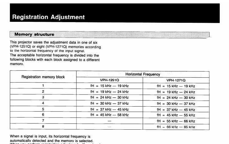

No, if you look at the SONY 1251 manual you'll see there are different memory blocks for different scan rates. Have you tried copying the memory globally by holding down the memory key for 10 seconds? That gets the rest of the memory blocks close to your good set up.
Posted: Sun Nov 10, 2013 3:51 am    Post subject:
1080i and 720p are borderline for the 1251's memory blocks. Looks like Block 5 is where 1080i ( 37.5KHz )would land and that block will also cover up to 45Khz BUT, 720p from the Apple may be jumping to memory block 6. Hence why you should copy the global memory over.
The other possibility is, the Apple TV is outputting a very narrow signal timing on the 720p, meant for flat screens and not to compatible with CRT's. To correct that you would need an HD Scaler of some sort.
Goto page 4 in the SONY's menu to see which memory block you are currently using.

 Filesize:  58.9 KB
 Viewed:  13838 Time(s)
