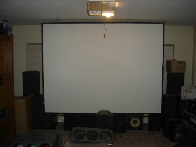

OK, I'm back! Here's some pix of my crappy room the way it is right now. Don't laugh... too hard. Laughing
Posting a series of pix to give you an idea of the room. My buddy and I came up with a few ideas while pulling down my 9500. Then his shoulder gave out, and while we got the 909 bracket up, the poor set sits on the floor...Sad
OK, pictures. this is a view of the front of the room. About 14' wide. Yes, it's a 6 X 8' aluminum frame screen, hung about 3' out from the back wall with wire ties. Hey, I never said I was a good installer.
Mr. Green
Also, aside from the tacky 80s light fixtures, you can see the channel we cut into the drywall to get wiring from the back to the front of the room. Studs in the ceiling run left-right, that's why we had to cut the channel.
I'll rotate clockwise around the room...

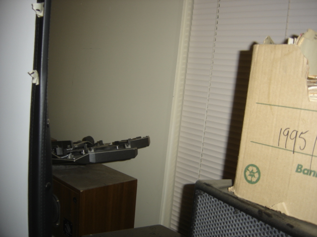

Posted: Mon Nov 11, 2013 1:04 am    Post subject:
Right side of the screen, showing that 3' distance between the back wall and the hanging screen. There are 2 windows with blinds over them on the back wall. They'll be covered up completely.
There's also a larger window on the right wall as shown in this pix. Where the screen is hanging now, it's right about 1/2 way left/right of the window.
 Filesize:  133.3 KB
