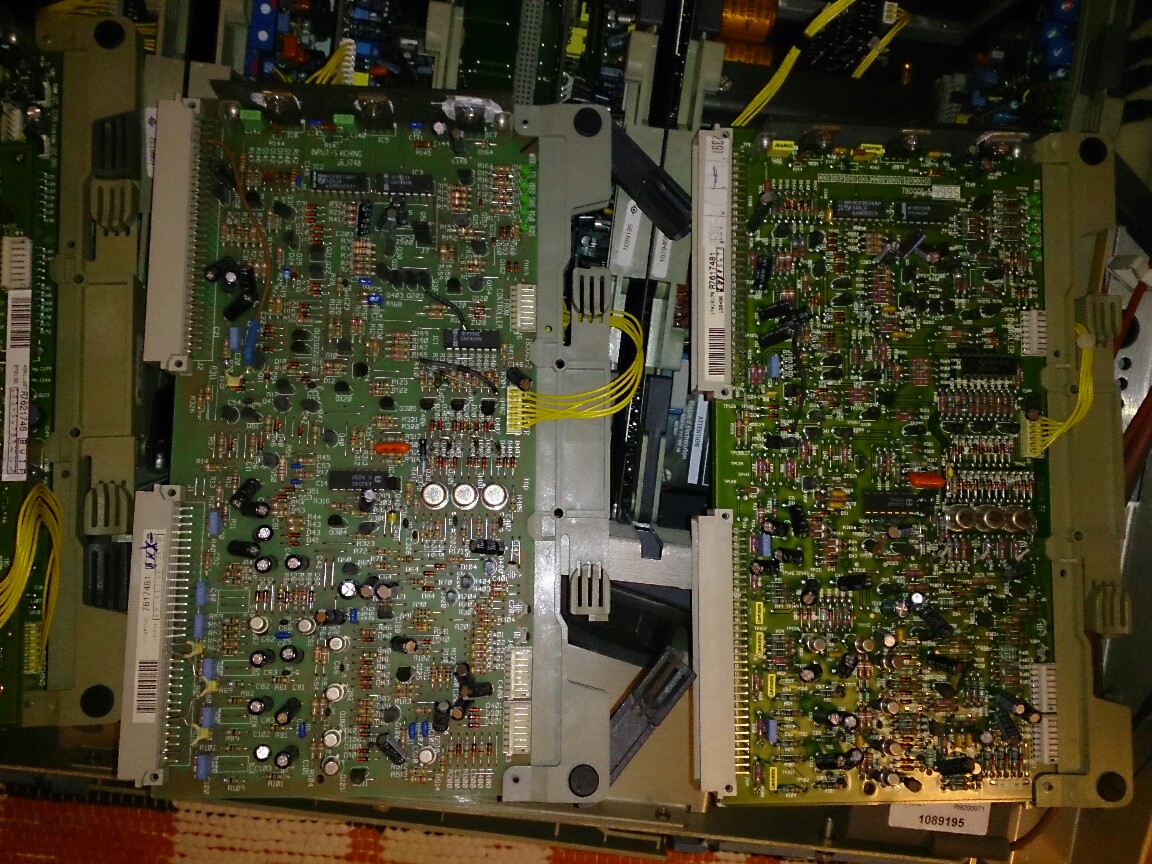

Success!
Got a R7617481 along with other various bits in the mail today. I swapped it in the projector and fired it up and all three tubes lit up. Yayyyy!

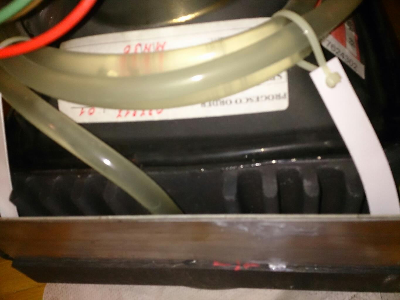

Posted: Wed Nov 27, 2013 10:19 pm    Post subject:

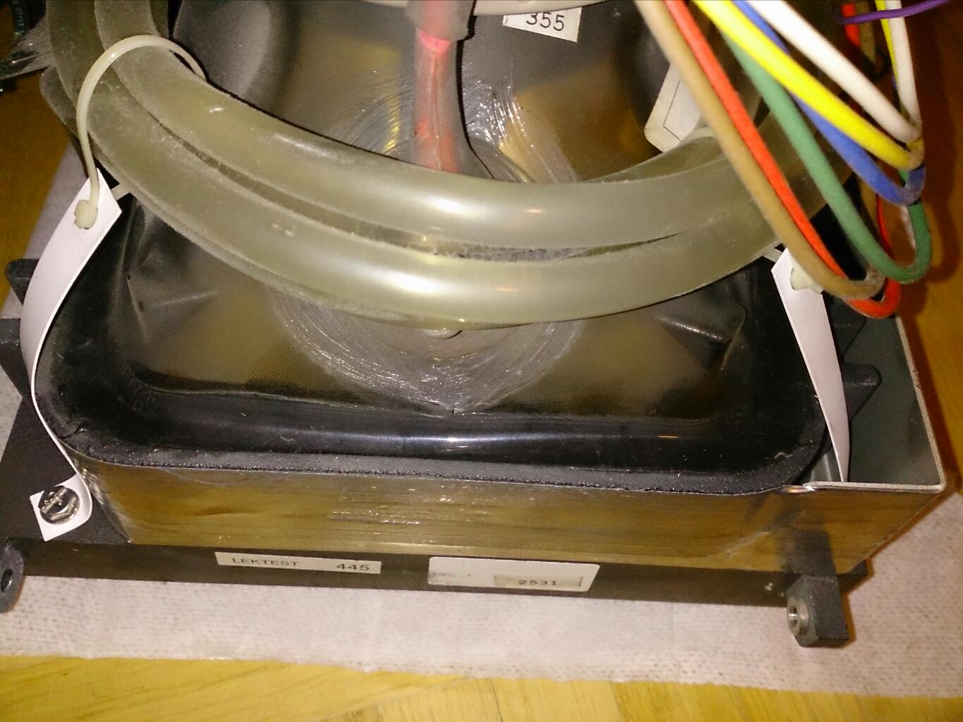

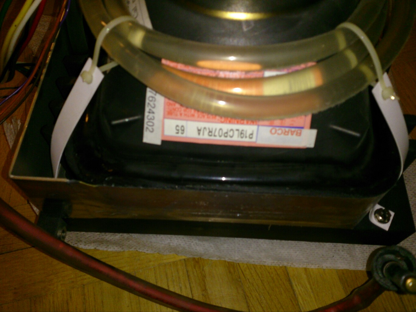

Got glycol and colored C-elements today and took the tube assembly out. From what I can tell the only point of leak was from the C-element's O-ring and the silicone looks fine.
As for draining the glycol I have read the guide for marquee owners. How about the Barco? Is there no screw and just the plastic hose connector? Then flush with water followed by destilled water? Isopropanol better?
How to make sure it does not leak again? Seal the O-ring with silicone?
Intact silicone seal?

Posted: Wed Nov 27, 2013 10:25 pm    Post subject:
To me it looks like the best way to go is to put tube facing up and remove the plate that holds the C-element. clean the tube face with water and some bleach and the rest of the housing. Add glycol from the top and then put C-e;emit in. screw down. While you have it out inspect the O ring for any cracks if so maybe you can find a similar one in size online.
then if there is any mor glycol needed fill from the hose connector. Also clean out the house very well.

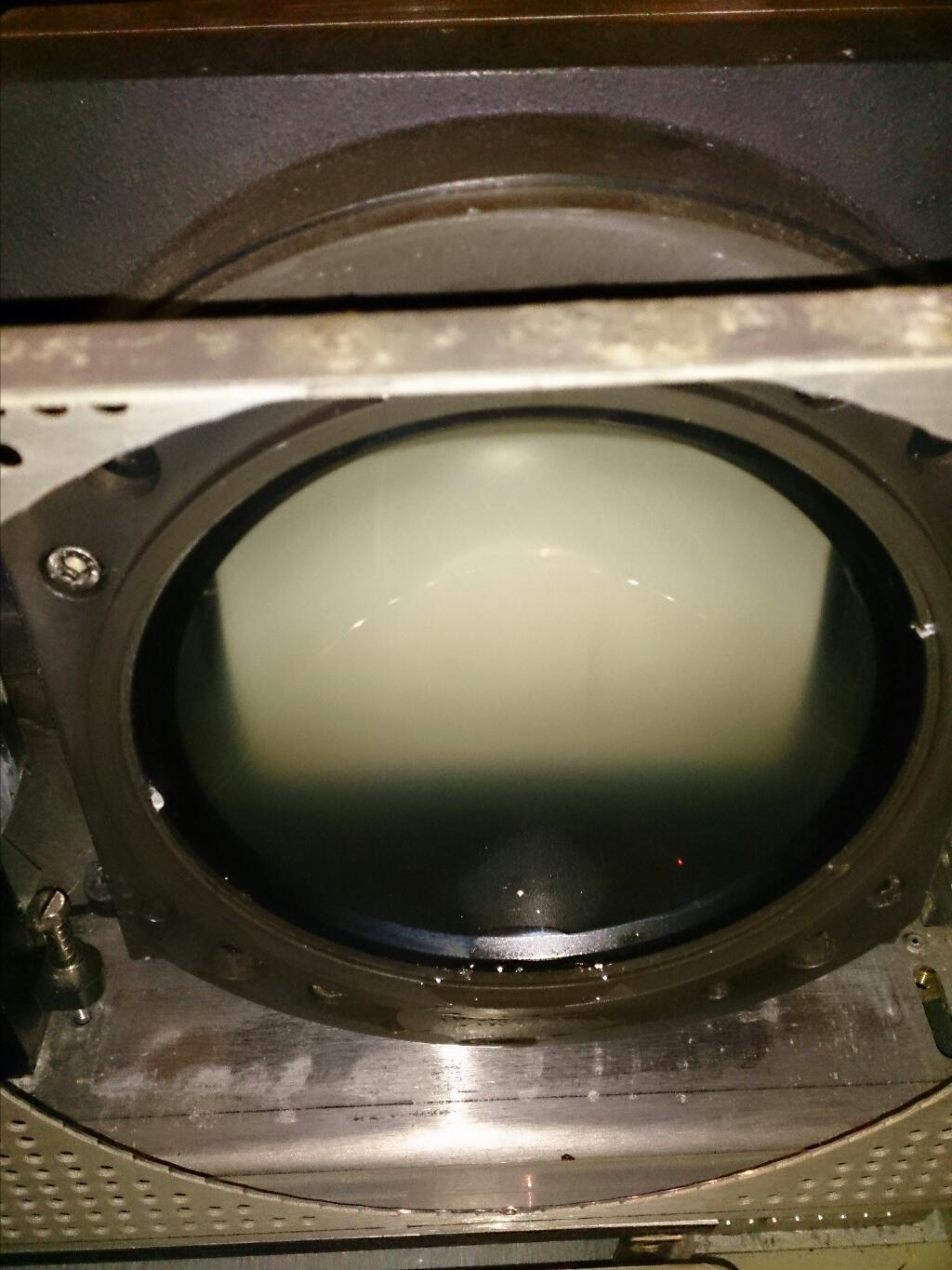

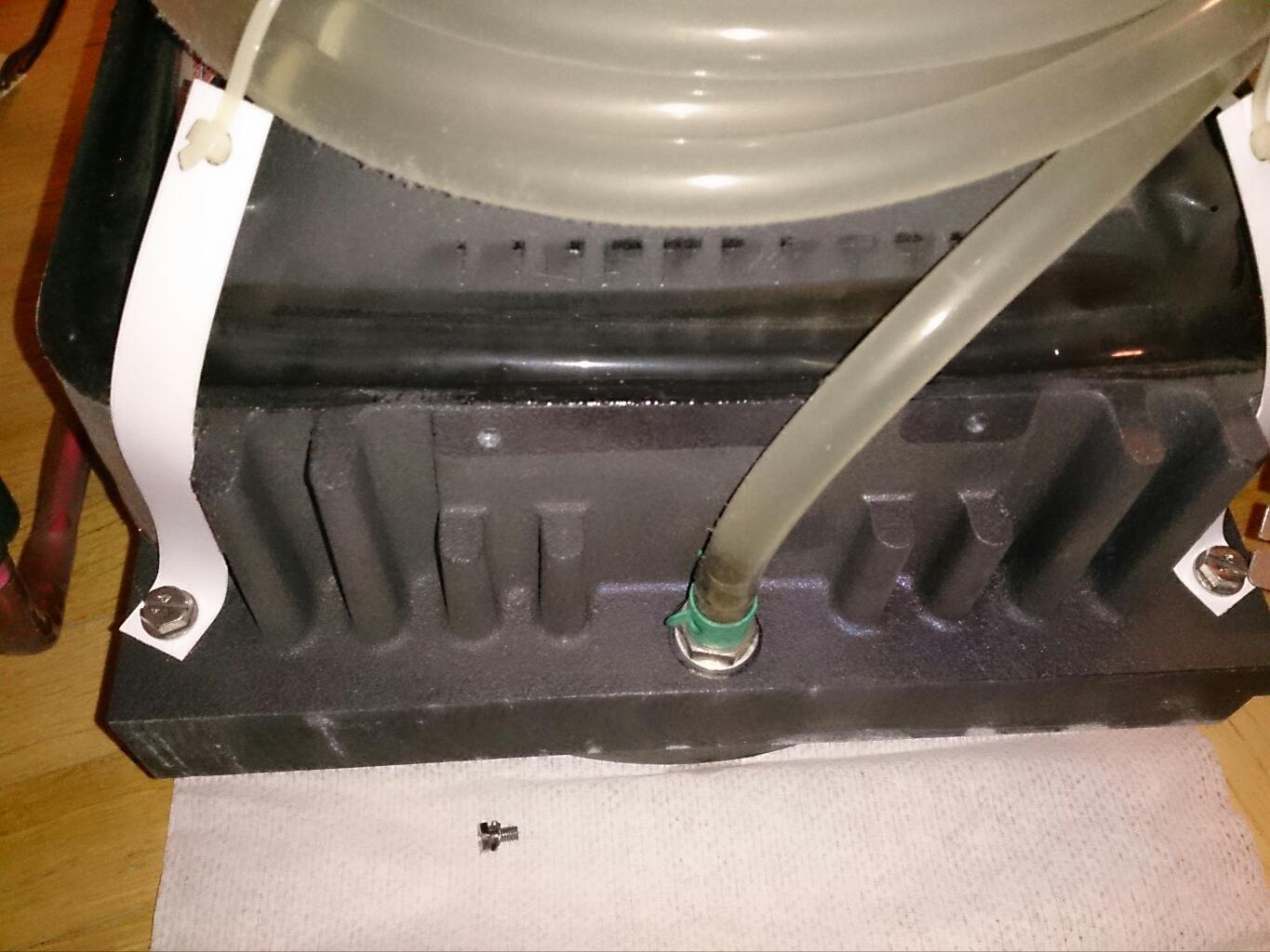

Posted: Thu Nov 28, 2013 5:54 pm    Post subject:
Got the glycol out today. It went everywhere! Luckily is neither sticky nor poisonous. Wink
What do you refer to as bleach? Sodium hydroxide? Chlorine?

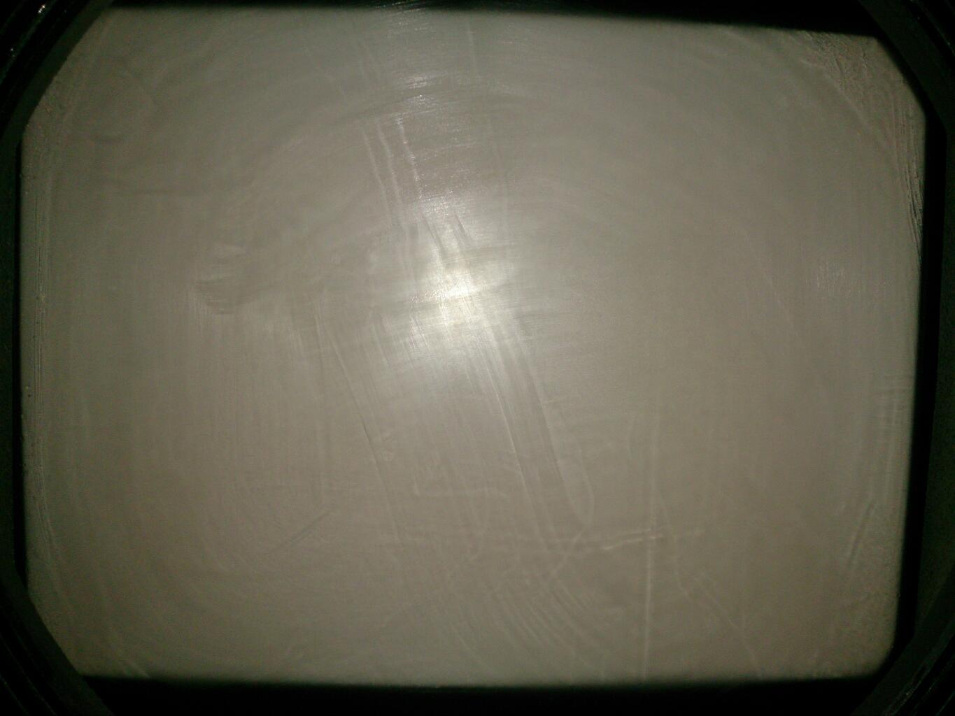

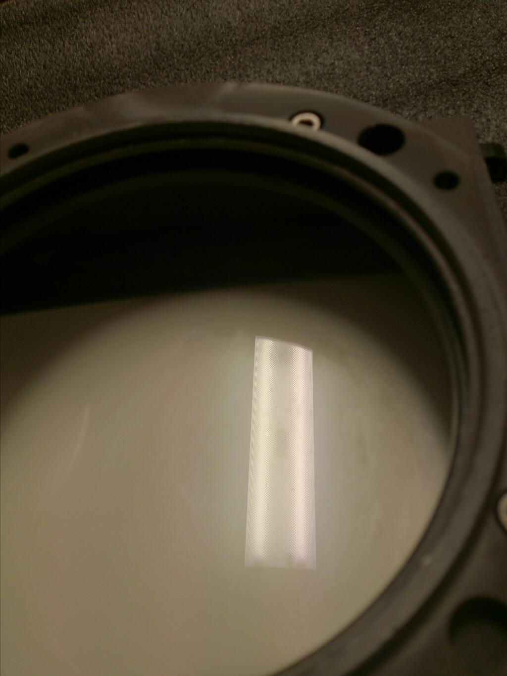

The glycol was not at all as yellow as in the horror pictures in the glycol-change-HOWTOs but it was very cloudy. This brings me back to my point, if water caused this in the first place and I cannot guarantee that all of it will dry out if I clean it, especially the porous cast iron housing, how to best proceed?
The O-ring looked fine by visual inspection but the screws where however severly overtightened. Are spares available for peace of mind? Moreover, the colored C-elements came with silicone residue around the seals. Does adding silicone do any good if the pressure inside is high enough to burst past the C-element seal anyway?
The tube surface and C-element had some very sticky goo on it. The tube surface will be easy to clean but there are lots of compartments I will never be able to reach. Are you sure I should not flush it with isopropanol?
Picture of tube face attached for reference.
Just drained.
 Filesize:  54.54 KB
 Viewed:  7109 Time(s)
Tube surface.
 Filesize:  83.53 KB
 Viewed:  7134 Time(s)

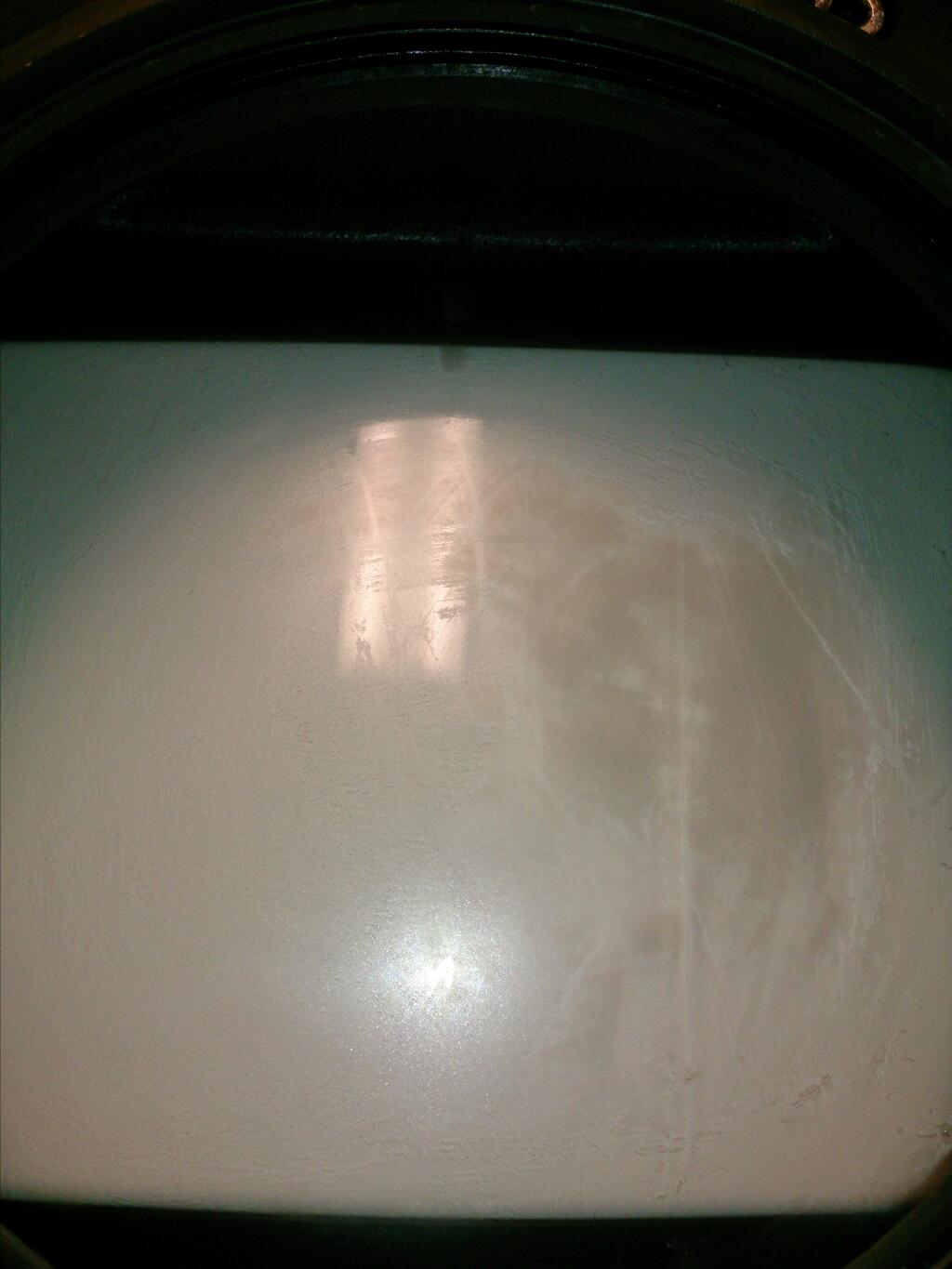

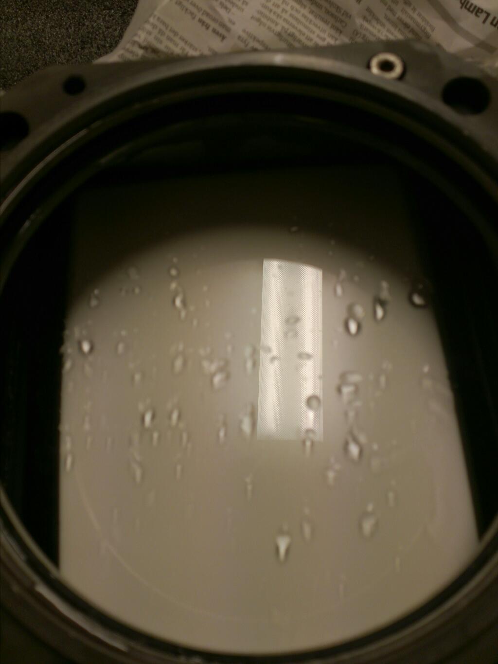

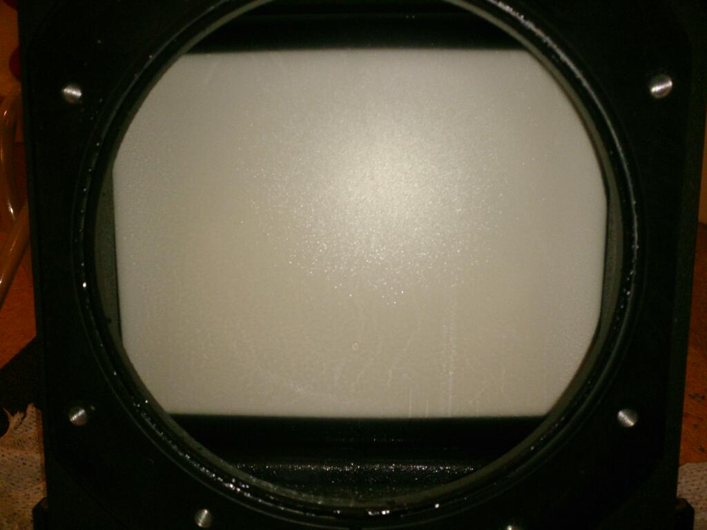

Posted: Sat Nov 30, 2013 8:20 pm    Post subject:
An hour with cotton swabs, tops and isopropanol later and I can now see the phosphor face behind the yellow goo. The isopropanol cleaner did leave residue behind but I washed out 99 % of it with distilled water. I will leave it to dry overnight but since the housing does not sit tight against the tube face (for allowing the glycol to cool the entire tube and not just the face?) I'm afraid it will not dry out completely.
I have asked before but no reply so I try again. How important is it to get all the water out ? Everyone/all guides suggests to use distilled water for cleaning.
After several rinses of water
 Filesize:  68.4 KB
 Viewed:  7076 Time(s)
Getting there.
 Filesize:  76.48 KB
Half way.
 Filesize:  84.58 KB

Posted: Sun Dec 01, 2013 9:39 am    Post subject:
In the last picture I see many imperfections. It's just dirty?
Maybe you could use one of those sponges used to wash the dishes.
Domenico (Barco fan!)
winny
Joined: 09 Oct 2013
Posts: 403
Posted: Sun Dec 01, 2013 9:41 am    Post subject:
Yes, yellow goo stuck to the suface. Took an hour to rub out with cotton swabs and isopropanol. I added the images in chronological order but they appear in reverse chronological order for some reason.
