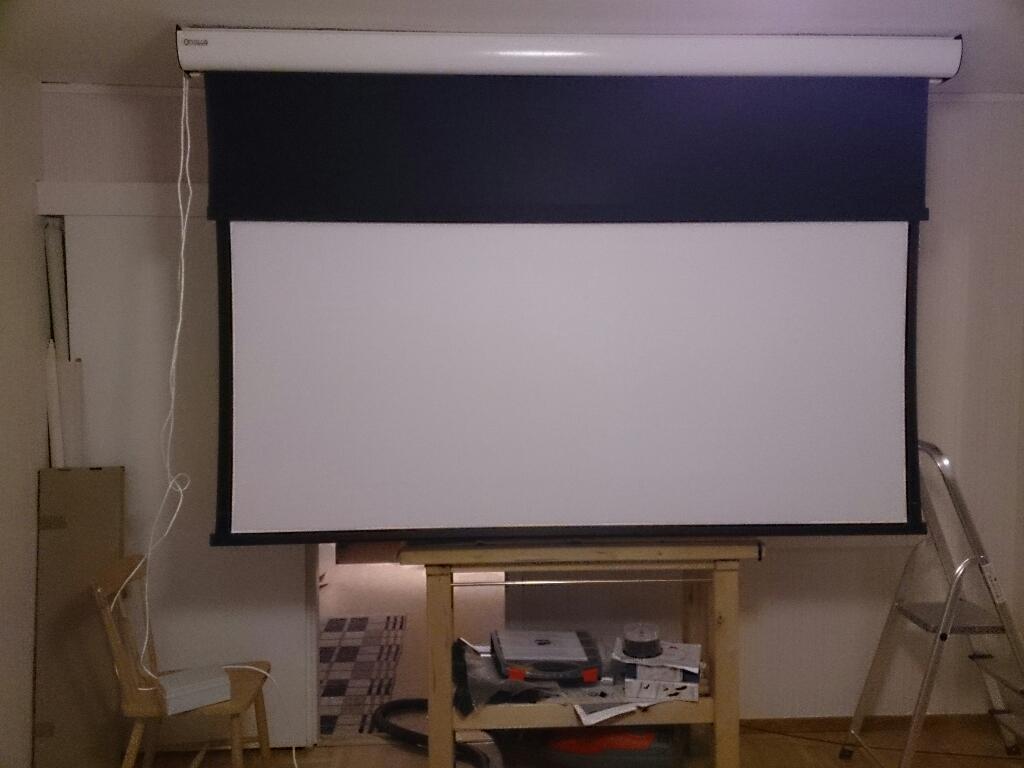

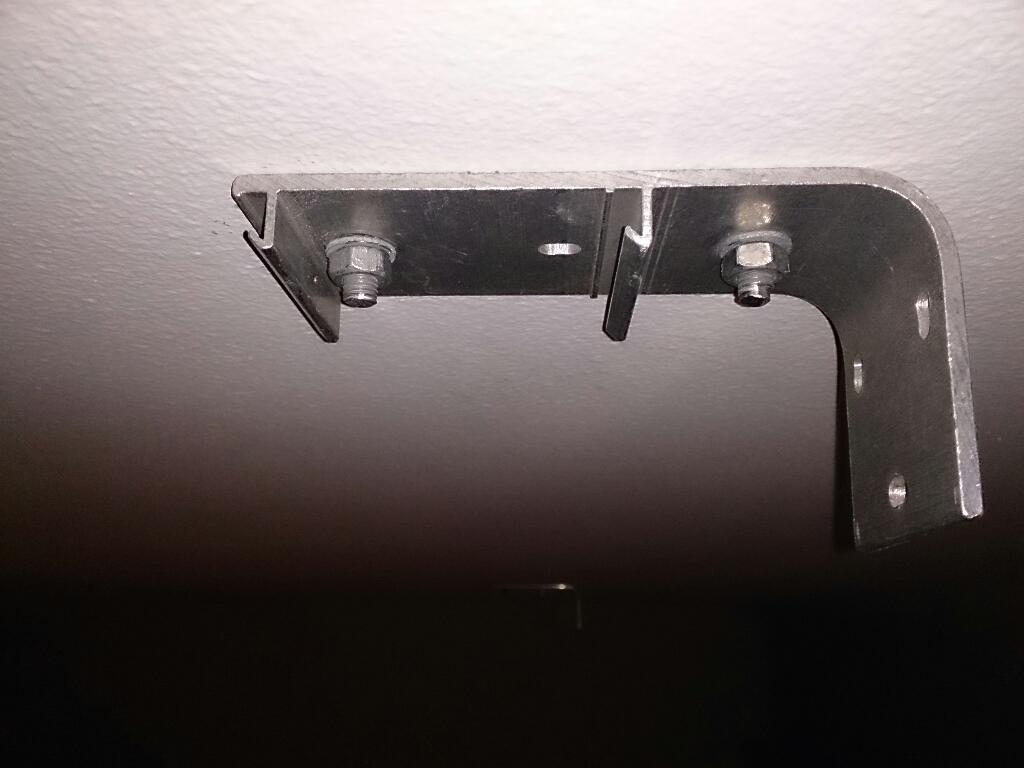

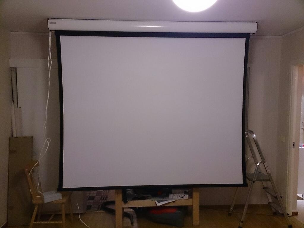

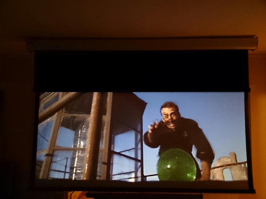

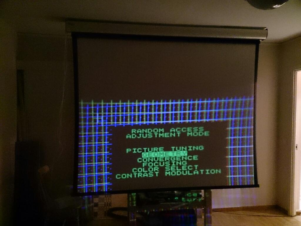

Got the screen up today after a lot of drilling, modifying the concrete anchors, taking measures and filing one of the anchors down when in place (that lovely feeling of working above your head). Sorry about the mess in the pictures, I'll clean when everything is up.

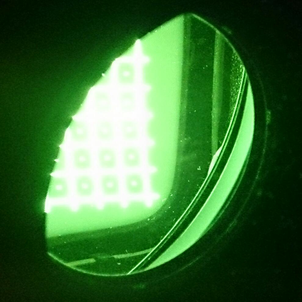

Firing up the 808s, I notice two things, I might run out of room to fill the screen and the raster was already off the edge of the tube. So I set the brightness to the lowest and was able to look into the lens without sunglasses and there was not much area left to zoom out any further and yet the picture did not fill my screen. Should be enough with 3.0 meter distance lens-screen for 2.13 meter screen width according to the calculator, but I doubt it. Also, I could see that the pattern was a bit bent on the far left edge of the screen and looking into the tube, it was obvious that the grid was outside the phosphor area in the left upper and lower corner.
To fix this, I would really like to have the remote since lying on the floor under the projector behind the case was not a comfortable position and I need to look into the tube while I'm adjusting. How to sync/address the projector and remote? They did not talk to each other when I put a battery in the remote. Also, when adjusting the raster, I had to choose a resolution from the menu first. Does this setting affect the raster setup? Is there one setup per resolution stored in the projector?
2.35 masking.
 Filesize:  58 KB
 Viewed:  6074 Time(s)

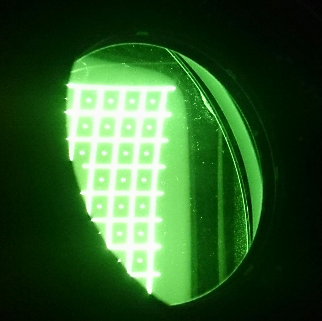

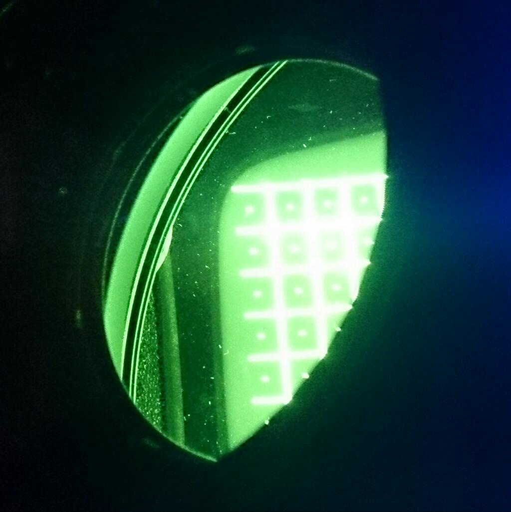

Found the remote in the manual and after some adjustments, I got to this stage without hitting the wall. It will hang right over my head in the couch. I hope the concrete anchors hold up. Smile
One thing tough, after mechanically adjusting the red and blue tube, am I guaranteed to not run out of phosphor area on the red and blue if I push the green all the way out?

Posted: Thu Oct 17, 2013 8:40 am    Post subject:
I would do some basic geometry work to see what's required to fill your screen! You are quite close to the edges of the tubes!
Also, seems your image is way too low and you are already at the max size on the tubes, you could lower the back of the projector to reduce the angle of the tubes and bring the image up, this way you are able to use more phosphor which increase the amount of light the projector produces and might increase the max resolution.
This is because it's still sitting on the case about 1 meter off the floor. I just wanted to make sure I can fill the width of the screen before I proceed and also find out the real world screen to lens distance and not blindly trust the calculation before I start drilling holes for the projector mount.

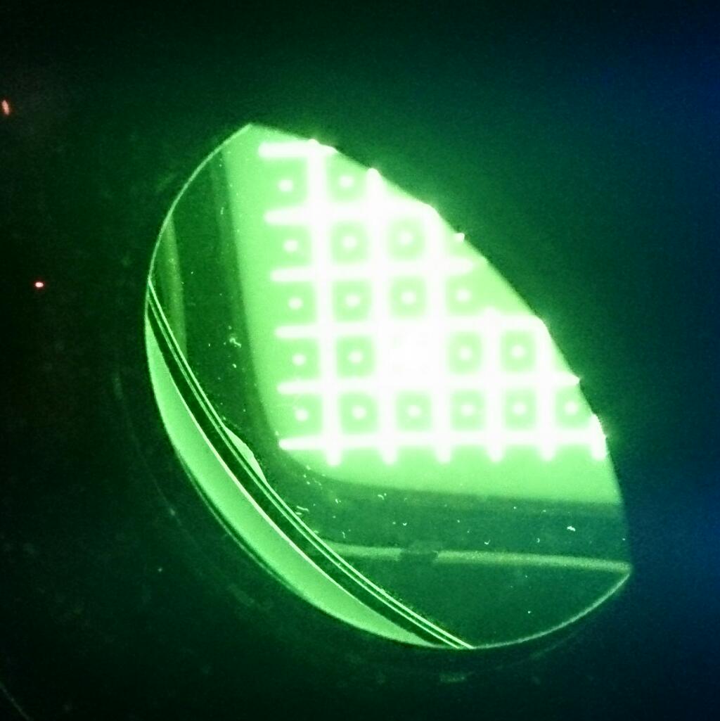

I thought that running close to the edge was the point, to maximise the phosphor use? Also, I thought the tube face would be more rectangular. There is a lot of area on the middle of both vertical and horizontal sides wasted by the corners hitting the tube edges at the moment.
Sorry, i misunderstood!
And yes it's not 100% square, my 16:9 image area would not fit at the top or bottom of the tube.
Edit:
I thought your image wasn't big enough already, running any close would be quite dangerous:)
Ah! This would pose a potential issue if I wanted a 4:3 mode in the projector since my screen has such a mode. That or ditching the 4:3 and getting a bit more resolution out of the 1.85 and 2.35 modes. I do have some 4:3 laserdiscs like the X-files which would not look good on a pillarbox screen. On the other hand I probably have 100 times more 1.85 and 2.35 material.
So back to my question regarding phosphor area. If I set up the projector with the PAL or NTSC pattern, will this be the same for other inputs and resolutions or will the raster shift?

Posted: Thu Oct 17, 2013 9:35 am    Post subject:
That's true, i only have a 16:9 screen so never encountered that issue!
http://www.curtpalme.com/Barco_Setup_Quick_Reference_Guide.shtm
That's a good basic overview.
Raster should stay the same for all inputs and resolutions!
Do toe-in using the Guy Kuo procedure (see the link above) - you can use normal raster shift to position the image on the tubes (you'll get it when you read the procedure).
Afterwards center the rasters using the potentiometers inside (they are described here http://www.curtpalme.com/Barco808_Layout1.shtm
I'm no setup hero so this might not be the 100% best way to do this!

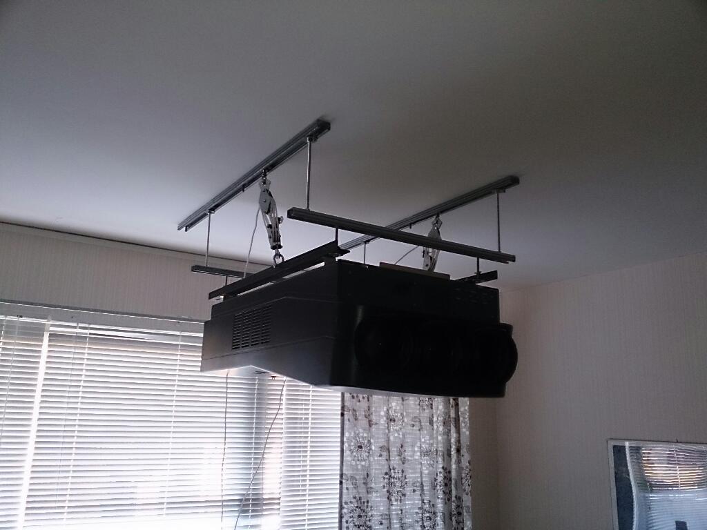

Posted: Thu Oct 17, 2013 8:19 pm    Post subject:
Well, I'm on the other end of the setup hero scale. Smile

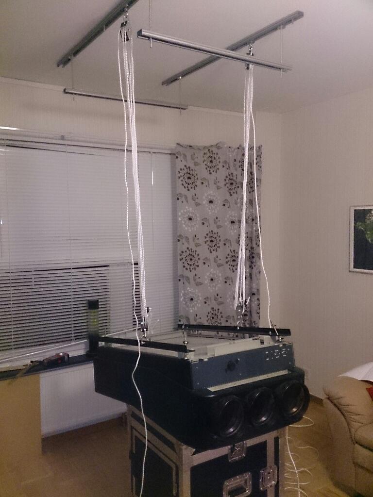

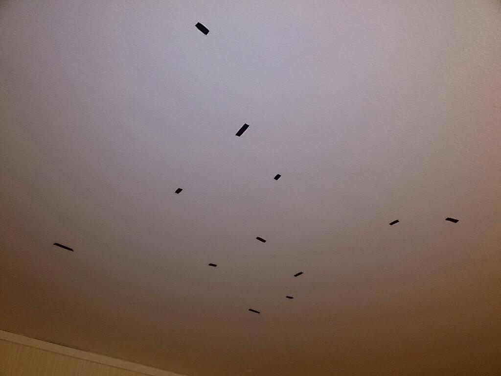

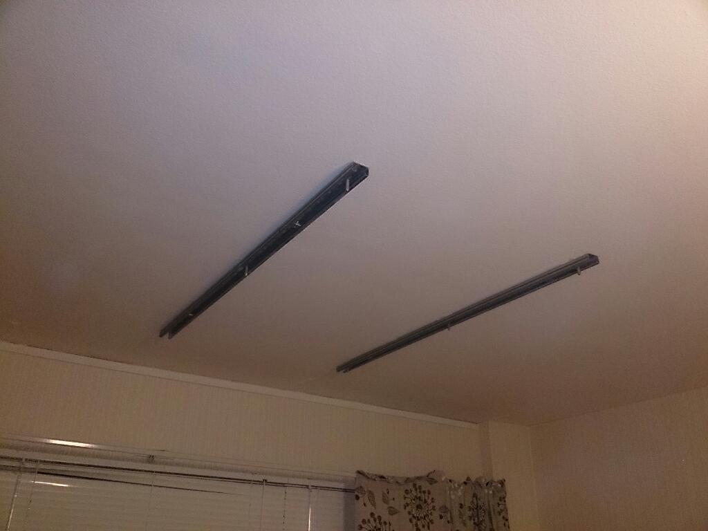

I did the same setup a bit more carefully and then starting with finding the steel reinforcement bars in the roof. There was some sort of method to the madness but it's quite hard with a consumer stud/metal finder to get precise results. Looked like I was in the clear and went off with the hammer drill.
Tried doing a chin with just two concrete anchors holing the bar and with me weighing about the same as a projector, it should be safe with six of them. Now I just need said colleague again to do the hoist since there is no break in the block and rope.
Hoist.

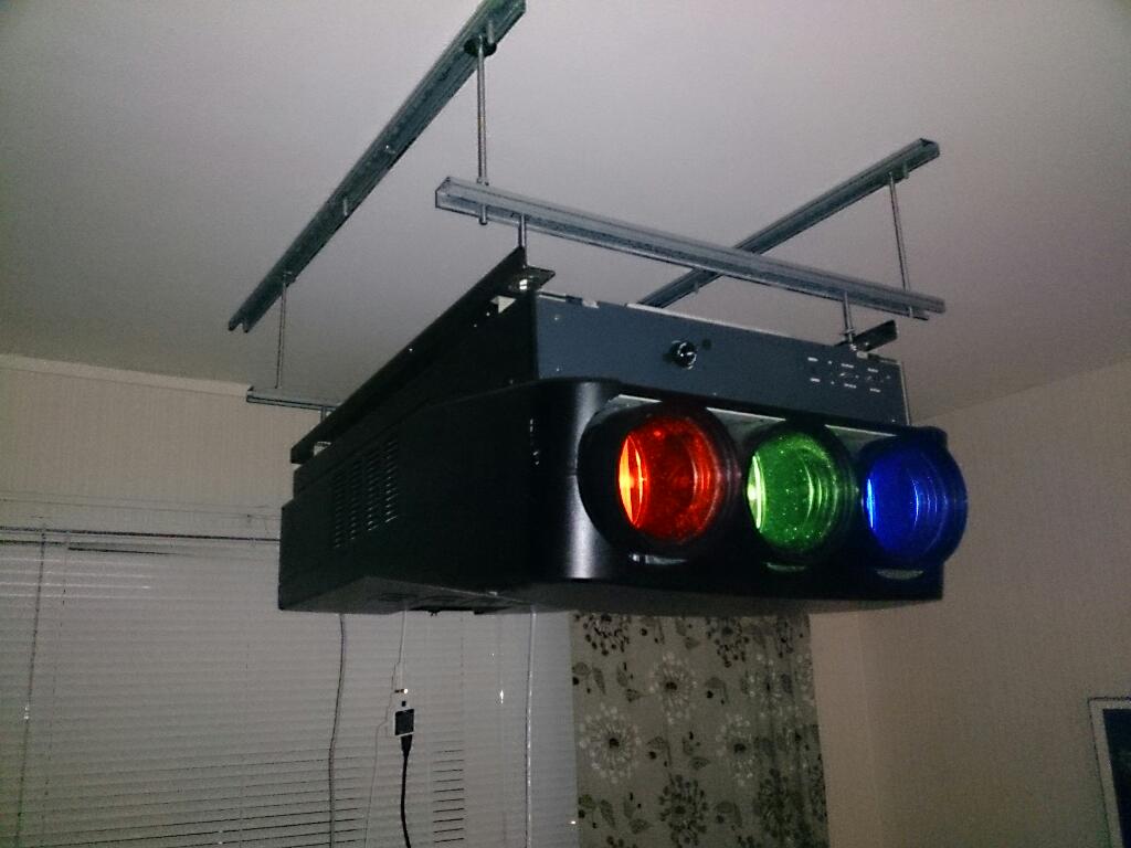

Posted: Fri Oct 18, 2013 8:30 pm    Post subject: Liftoff!
Ended up hoisting it myself. Heavy stuff!
Despite careful measurement the raster did not center. I have a few cm of movement on both the projector and the screen but I think I will live with it for the moment.
Getting the convergence right was a quagmire. Spent a solid hour on my initial setup with the built in ntsc pattern, only to have to start all over again when I hooked up the HD fury. I never got the full width of the picture either and changing h phase to correct this ment that the convergence had to be done all over again.
It's getting late here so I thought I would settle with a laserdisc for the moment since the ntsc setup is well adjusted. The scanlines are almost unbearable! What scan doubbler or quadrupler is recommended?
