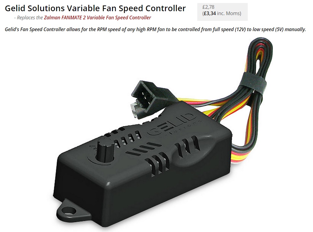

I will have to build a 24-->12V converter anyway, so just use a adjustable voltage regulator instead of a fixed 12V type.
Once you have 12V with a regulator you can with GELIDs little fan controller adjust the voltage to your specific needs. Very cheap to.

Thanks für the info, wolfman. But i don't buy things i can build myself. Thats kind of principle for me.
May be easier, but it's so fast and easy to take a piece of perfboard and an LM317 or LM337.
I will wait until the fans are here and see if they are good. Reading and comparing spec sheets is most theoretical.
Let's see how the practical test will be. If they fail, i'll send them back and try others.
