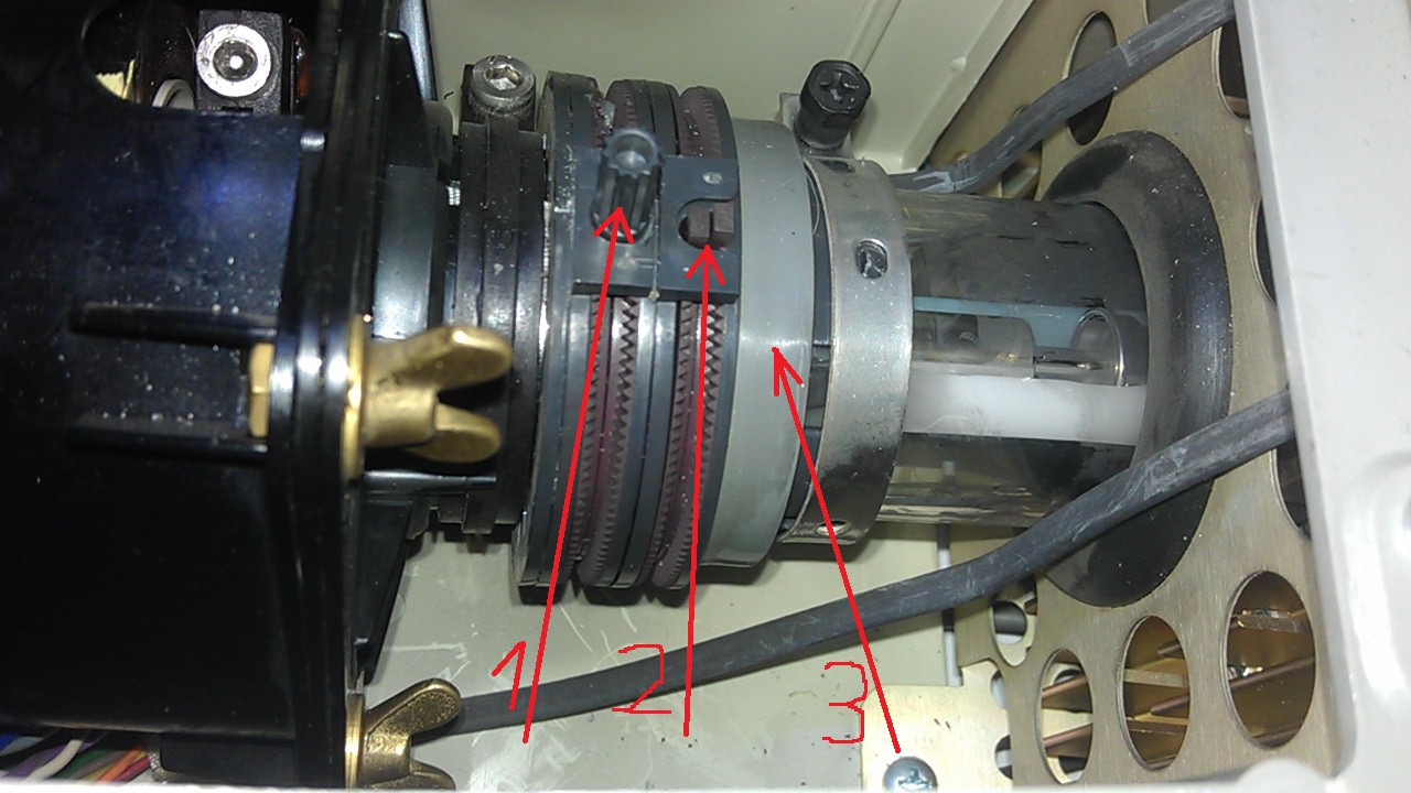

On my tubes, it's build like you painted it. Here's a picture. Flare ring, flare ring knob?

yes you only have a single pole magnet(1) which is the flare magnet. Each half of that magnet has two magnetic points on it at opposite ends, for example at 12 O'Clock and 6 O'Clock points. these magnets will push the electron beam towards the center location which will move as you move the entire knob back and forth around the tube neck and also if you twist the knob the magnets move away from each other or toward each other.
The NULL point is where the two magnets on each half are together. So the two magnetic points on the front ring half should match up with the magnetic points on the back half . You know this is true when you move the knob around the tube neck and nothing happens or there is very little movement. Another way is to turn the ring around by the knob till you find the two tabs
like the ones on magnet (2). Put those tabs together and you now have a Null magnet structure. Start here with Flare adjustment.
Do as Drags states looking for the bright dot and where there is a "comet trail" move the knob around to get the trail or flare to get closer to the center, first by moving the entire ring around then by twisting the knob so the four magnetic points, two on each half, move around the ring pushing or pulling the magnetic field closer to the center. You may have to also move the knob around the tube neck while twisting. it will take some practice to figure out what each action causes in a reaction to the electron beam.
Eventually you'll have an AH HA!!!! moment and understand what is going on.
