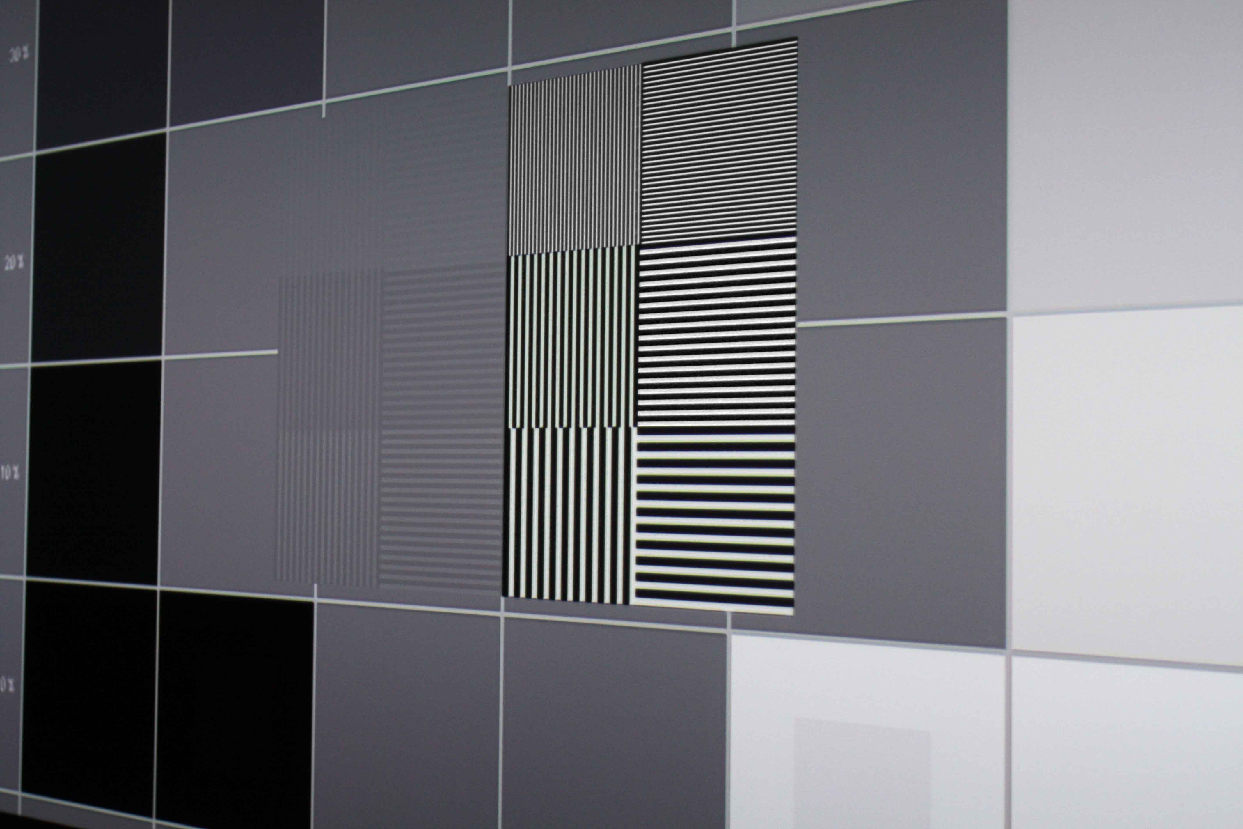

Andreas21
Joined: 02 Oct 2013 Posts: 582
| Posted: Wed Nov 27, 2013 10:39 am Post subject: |
It is easy to see in the close up of this picture the light diffference in the horizontal and vertical, if you compare this to the VW1000 closeup I took it is cleary much better in the lightoutput than this CRT.
And also out of this picture you can see sharpness and ansicontrast is in another league on the VW1000.

stridsvognen Guest
| Posted: Wed Nov 27, 2013 10:44 am Post subject: |
| Andreas21 wrote: | It is easy to see in the close up of this picture the light diffference in the horizontal and vertical, if you compare this to the VW1000 closeup I took it is cleary much better in the lightoutput than this CRT.
And also out of this picture you can see sharpness and ansicontrast is in another league on the VW1000. |
Right.. and hopfully so.. It also shows that its not perfect as a 1080P dlp would be.. Do that make the DLP better..??

Andreas21
| Posted: Wed Nov 27, 2013 11:19 am Post subject: |
| stridsvognen wrote: | | Andreas21 wrote: | It is easy to see in the close up of this picture the light diffference in the horizontal and vertical, if you compare this to the VW1000 closeup I took it is cleary much better in the lightoutput than this CRT.
Right.. and hopfully so.. It also shows that its not perfect as a 1080P dlp would be.. Do that make the DLP better..?? |
What makes the DLP better with this testpattern than the VW1000 is mostly because it is a single chip I think. And I know no DLP can compare with the VW1000 in 2D picturequality not even the insanely expensive 3 chips from Sim2. But if you only sit and watch testpatterns all the time the DLP can be better.

| Francisco wrote: | Diddern is right about the camera thing. I will try to shoot a picture tonight with my Canon D40 with L 2.8 lens. Maybe it will capture this better. Also will take a shot of 72hz resolution.
Strisvognen please try to explain me why we need higher bandwidth? If we take 1080p@60hz we don't go over 165mhz pixel clock. 1080p@72hz we can configure as 817P@72hz because most movies are shot in 2:35 and will give us 148mhz pixel clock. Now 4K is a league to far for the resolving power of a single CRT, so why bother about higher bandwidth???? |
I think you need to understand some basic stuff about Bandwidth, rise and fall time.. I understand it like how vertical the signal can go.. the time from off to on and the other way around.
If the on off time is not 0 it will be like ramping the signal more or less.
So actualy you need much higher bandwidth than the pixel clock..
To reproduce a 20khz audio in a ok way you need around 6x the bandwidth,
My preamp will do 2,5Mhz all the way true.. from riaa input to line out.
Same for everything else.. Higher bandwidth faster response.
Even at low resolution you will benefit from the faster response.
I dont think running 800P will save you.
So having just the bandwidth needet will let you reach the right output level, having a headroom, or much higher bandwidth will let you reach that level and hold it longer before it needs to be turned off.
Sorry for my drawing skills, but i try to ilustrate black is the digital signal perfect reproduction.. Green a good response on a crt, and the red like yours, a bad response.
The yelow angle ilustrate the bandwidth.. the more vertical the higher bandwidth..
So lower your resolution wont change your rise time, but you will get time to hit the right level.. Maybe.
I know I tested this.
You have a nice crt +1 and god lucking pictures also.
What I mean is also important is that when you watch this at home, they should be all the same , but also important that the white lines are just as big as the black lines. And that black is black and white is white.
Not grey or a mixture of black and white.
The original 1080P pattern on the disk is clear black and white lines.

| stridsvognen wrote: | | Francisco wrote: | Diddern is right about the camera thing. I will try to shoot a picture tonight with my Canon D40 with L 2.8 lens. Maybe it will capture this better. Also will take a shot of 72hz resolution.
So lower your resolution wont change your rise time, but you will get time to hit the right level.. Maybe. |
Question for you mister.
Why is there NO black in 1:1 and even lower down, can you explain that? Then in H and V lines.. in your photos.
