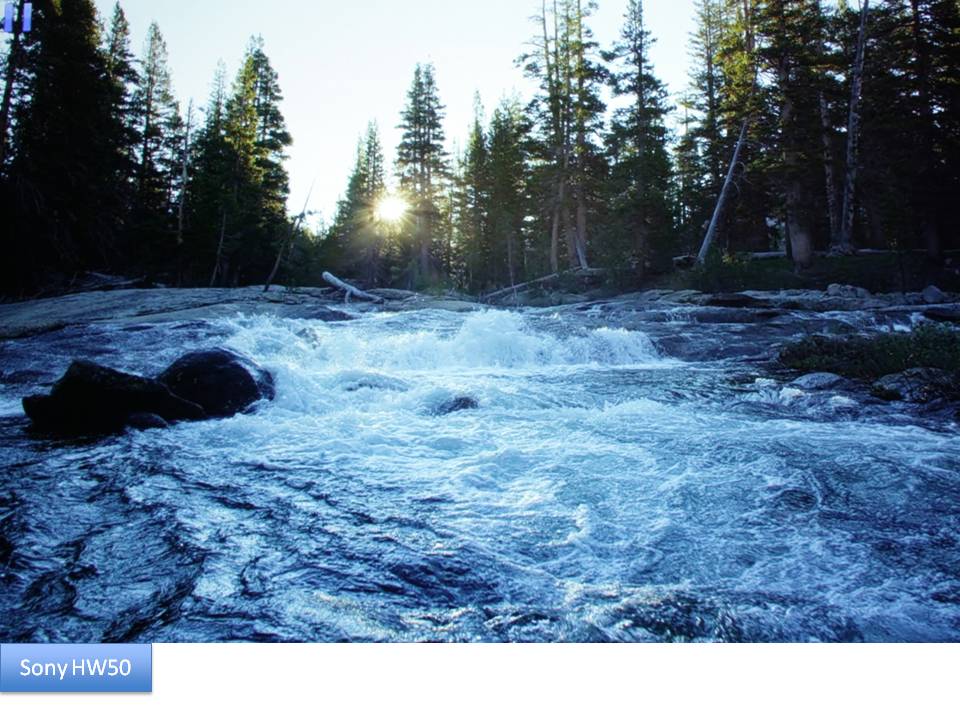

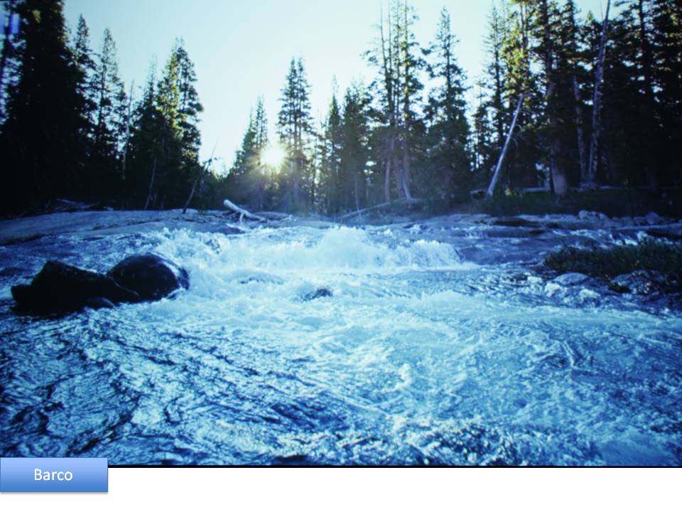

Here are some of the pictures that were taken.
Straight form the camera, no correction on the pictures are done.
The differences shown are very similar to what that is seen in real. But it looks much better in real, then with both the crt and the digital. Camera is set up close to screen so you can see the whole image. The CRT had a Darbee connected at green 40-50 % (do not remember) and the Sony HW50 had none...
The CRT beats the HW50 big in dark dark images. Example in life of PI where you see just a little boat on the water and everything around is completely dark on the crt while the hw50 or any digital will look some grey around the boat. The Hw50 beats the CRT form images like AVATAR in space at the start. So similar to 3-4% ire and down ""Crt best""
From 3% ire to 100% ire The HW50 best then in my eyes and also the people present.. """At all."""
The so called picture war, was pictures form a hw50 and some taken by a iphone and same with the crt. And the pictures look good. But a picture does not prove anything else if not taken in same room same cam. and so on.
The pictures are form different films paused and picture taken without touching camera. Both with same shutter time and possession. Then on the CRT talked about in this forum. and a Sony HW50 not a vw1000..
And to try to remember a picture,,, you don't. So only way side by side. But I recommend that others do the same with a JVC or a Sony and see for them selves against a crt.. And post it here.
You see who is what projector ...

i can see that CRT setup need some serious calibration, looks like the grayscale and gamma is all messed up.
The only right thing would be to calibrate the 2 projectors so they hava identical calibration data.
White on that CRT is all blue.. lets guess about 12000 kelvin. I would be ashamed to invite anyone to a shoutout with a porly calibrated projector like that.
So i agree.. The SONY looks much better...

That is correct, but not possible at that time. I hope the owner after new modd let me check again and then easy to see the improvement and then can post again. Remember that the Sony HW50 was calibrated up to another screen.
With D65, Rec 709. The Barco was off, I knew that. But still even if it were calibrated you see with no problem that there are huge differences in favor the hw50

Is there any data what resoluytion and framerate was used on the CRT. pixel clock video chain and so on.?
Still i think its not serious to make a shootout when the projector is not calibrated and ready to perform its best.
If i was that guy with the Barco i would hide myself for the rest of the world for a loooong time.
The pictures shows clearly that he have no idea what PQ is all about. He dont need any mod to do better than that.. just buy a 100$ standard Marquee 8500 with HD8 lenses.

Indeed the Barco needs a calibration.
According sharpness it will not be on the same level as the digital but that doesn't matter because a "film like" image counts.

Resolution blueray 1080P 60 HZ with HDMI direct to the projector. both form a oppo player
I agree on the shootout. There were so much bragging that this will beat everything, we went and this is was the result. And only with a hw50.
I have told my friend that it really need to get calibrated. I hope he does, so we can see how it will do then. And specially after new mods coming. I gave him a avfoundy pro so he can calibrate it the best way. And not pay so much money. But I think it will not make a different. Of Corse colors be correct, better gamma, and the correct greyscale. But the same best form 0-4% ire, form 4-100% ire it will lose. And to this just buy a 100$ standard Marquee 8500 with HD8 lenses no.
I have seen this crt form before mods and after, and its huge improvements. But why compare if you're satisfied, and don't say that something is better. And I agree with Kal """Some will argue that CRT does better with lowest black level (near black) while digital does just about everything else better. It's up to the end user to decide what's right with them. """

Again i cant coment on how a Barco will be able to perform, but i still think there is more to a picture than sharpness, and im quite sure that i can make a more alive picture with better dept, and better color reproduction on my CRT than any Digital.
I think the barco simply miss bandwidth to resolce both resolution and colors.
