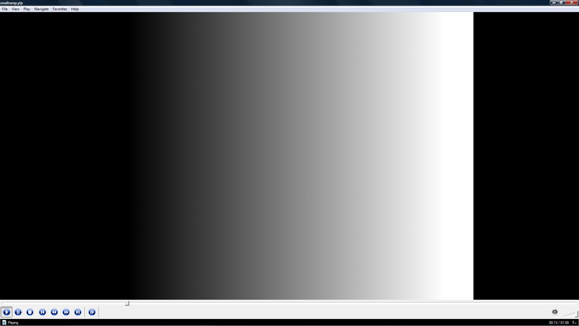

here you go. a 1920X1080P ramp pattern

^^^^ I see 'bands' or 'stripes' in that too. It doesn't look 'smooth' to me. Again, it may be my monitor or HVS.
Posted: Fri Mar 13, 2015 12:21 am    Post subject:
Yes, you will see bands and/or stripes. But they are Bit or conversion related and not because the pattern has Steps.
A step pattern is designed to show steps. A Ramp pattern would have abnormalities in it that are related to:
"Banding is normally introduced due to luma conversion"
I have another one that's 1920X1200 (2mb) and the banding is not visible on my monitor. And it's too big to load on this page
