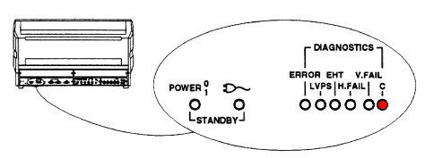

The projector turns on but will not turn the CRT. When I press any button on the remote control on the rear panel of LED lights in the picture which I marked in red.
When I release the button on the remote control turns off.

The projector should give at least a test pattern from the UTIL menu. You may have a loose connection, a failed board, a failed power supply, a false trip of a protection circuit, there are several possibilities. For tubes to fire up they need power to the filament, they need G2 bias voltage, they need 34,900 volts to the anode, and a signal to display. Loss of H sweep, V sweep or loss of some other signals can cause protection circuits to shut the tubes down
