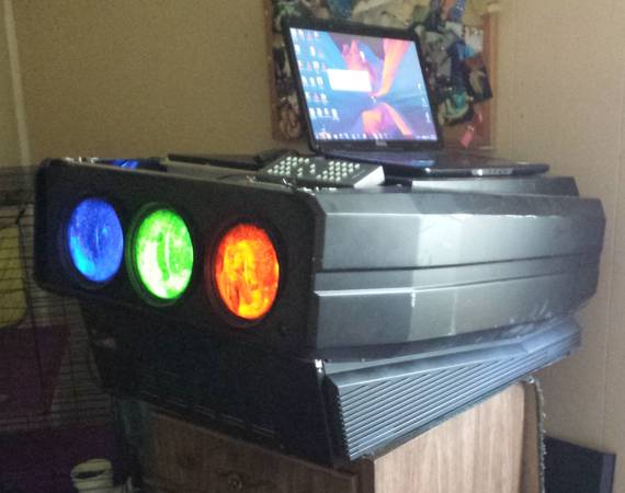

Does anyone know if this model number is consistant with a Vidikron 1 ??
38-P11075-95
I haven't even taken it out of the minivan yet but I can't see any markings identifying it. Both the external and internal remote say VIDIKRON on them but I haven't gotten into it enough yet to see if there are any identifiers anywhere else.
I made the three hour round trip because I thought it had the green and red c-elements since it was supposedly a Vision 1 but was surprised to see that it didn't. The tubes are in good shape, though. Light wear on green and great red/blue. I need to open it up to see if it was retubed with LUGs or factory.
Thanks!

It has the later model plastic side panels at the bottom, so yes, it should be an Ultra, which really is the operative question. Earlier Vision Ones were non Ultras.
Posted: Wed Jul 03, 2013 9:45 pm    Post subject:
Looks like a vision 2 or an 8500AC. No LC chambers, 8 inch tubes.
Posted: Wed Jul 03, 2013 9:51 pm    Post subject:
Yep, he's right, also the IR cutout isn't cut as part of the red lens. It's an 8500 or 8110 at best.

Posted: Wed Jul 03, 2013 9:52 pm    Post subject:
Nooooooo Nashou! Say it ain't so!!! I'll definitely have to open that thing up tonight and have a look then. I hope it's not an 8500!!!!
See what happens. Get comfortable with a great set up by Craig Rounds and you end up taking yourself out of the game only to jump back in to take some lumps.......
Hopefully not!
Posted: Wed Jul 03, 2013 9:54 pm    Post subject:
Pop those tubes in from your friend with the 9500LC if he still has them.

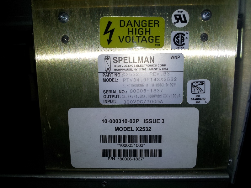

38-P110xxxx, 110khz being the top scan rate so its an 8110. If the hvps is 34.9kv then likely an 8110 Plus.

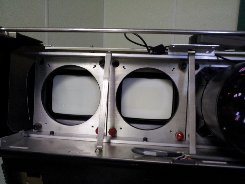

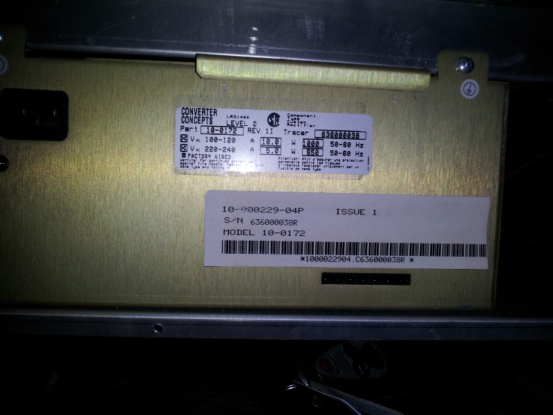

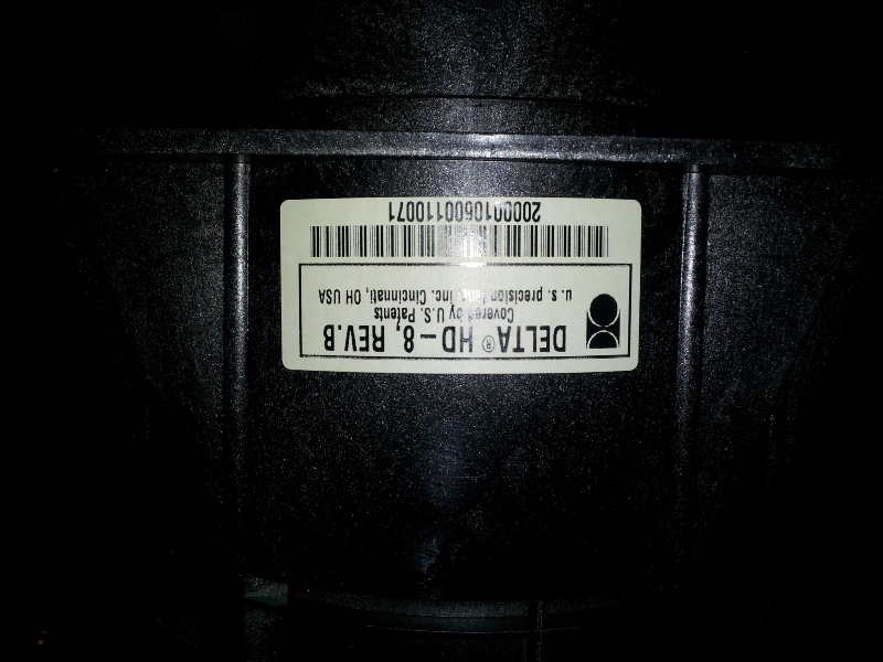

So I had a little time today and pulled the HD8 lenses to check tube condition..........not bad as you can see. Got into the menus and it is a Vision 3 with 2800 hrs. I also posted pics of the power supply since Tim had mentioned it.

Posted: Wed Jul 10, 2013 3:47 am    Post subject:
Man they had that set up poorly!!!!!!
Posted: Wed Jul 10, 2013 9:41 am    Post subject:
They used the NEC throw distance calculator!!
