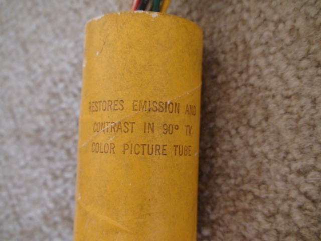

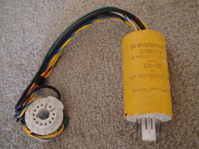

Hah ! i found the perfect solution to your problem, Benareeno: check out this baby....I will sell it to you for one biillllllliion dollars...

what is that thing?
Posted: Tue Aug 27, 2013 6:47 pm    Post subject:
It's a CRT 'kabooster' as we used to call them. It bumps up the filament voltage from 6 to about 7.5 volts to superheat the CRT to give it another year or so of life. haven't seen one of those things in 30 yearfs. Very Happy

Curt is correct as usual! In between grade 11 and 12 I worked as a summer helper for Jack's TV in Tsawwassen....Curt might know of the Learmont family who ran this place - it was big on Sony & Panasonic. Anyways, I would grab faded sets traded in/tossed outside the store and use this on them. Sometimes it only worked for a few days then one or more of the filaments would blow out completely ! This is back in the days of "all wood" TV set enclosures lol. Its been so long I can't recall where I got it ! Might be a museum piece one day...maybe already is !
