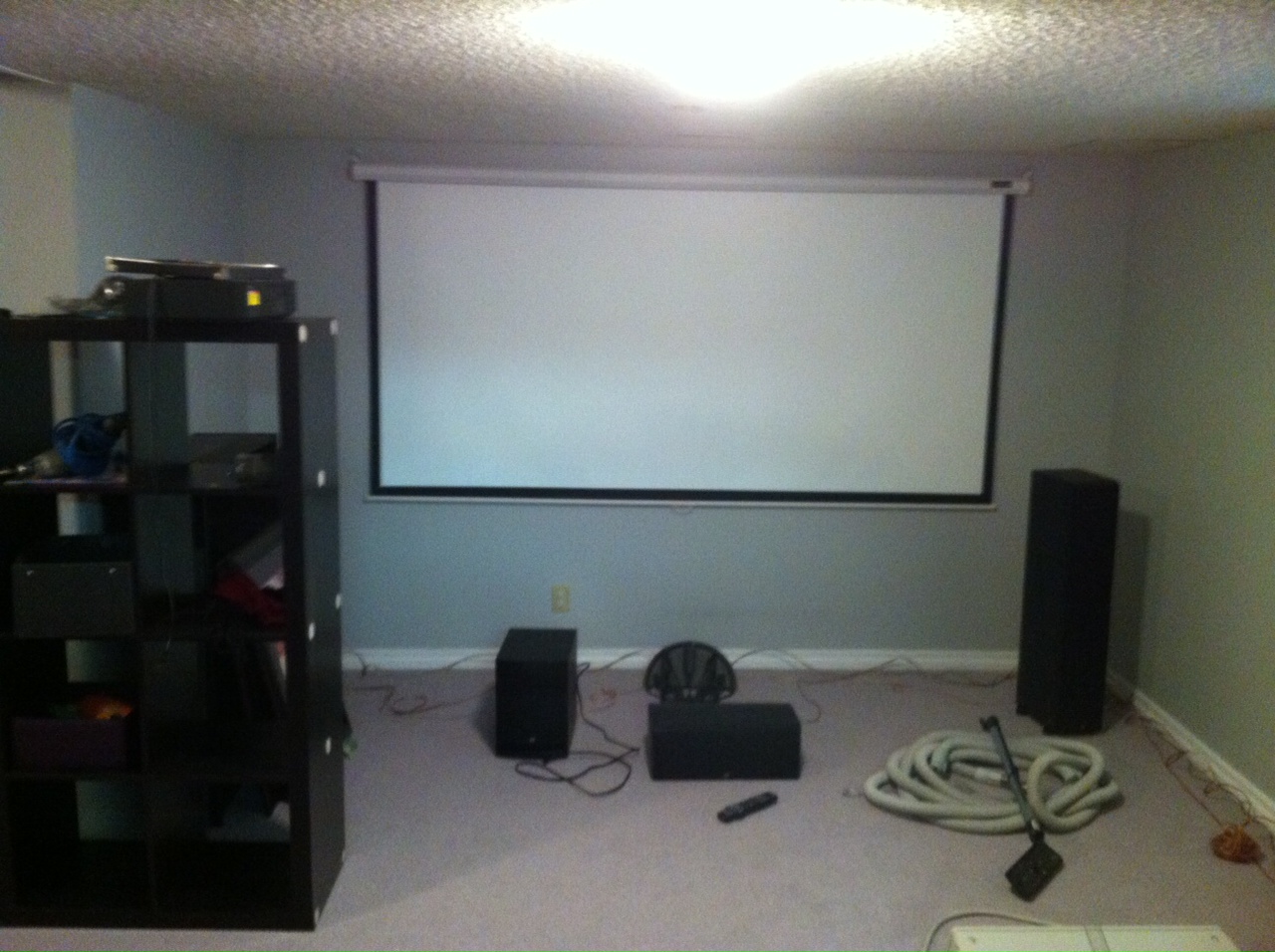

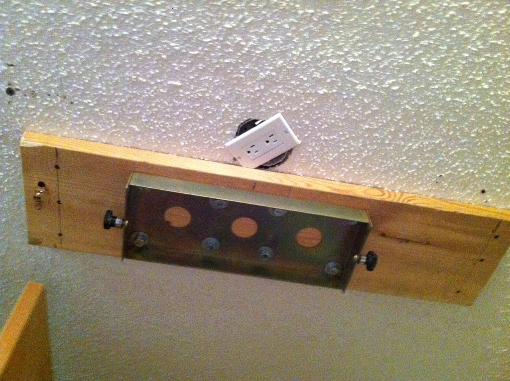

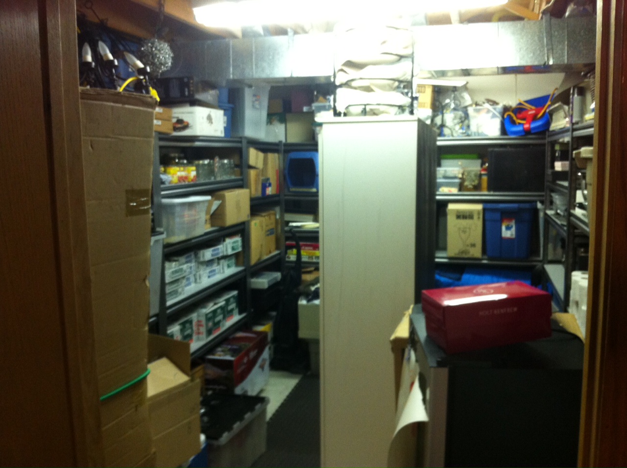

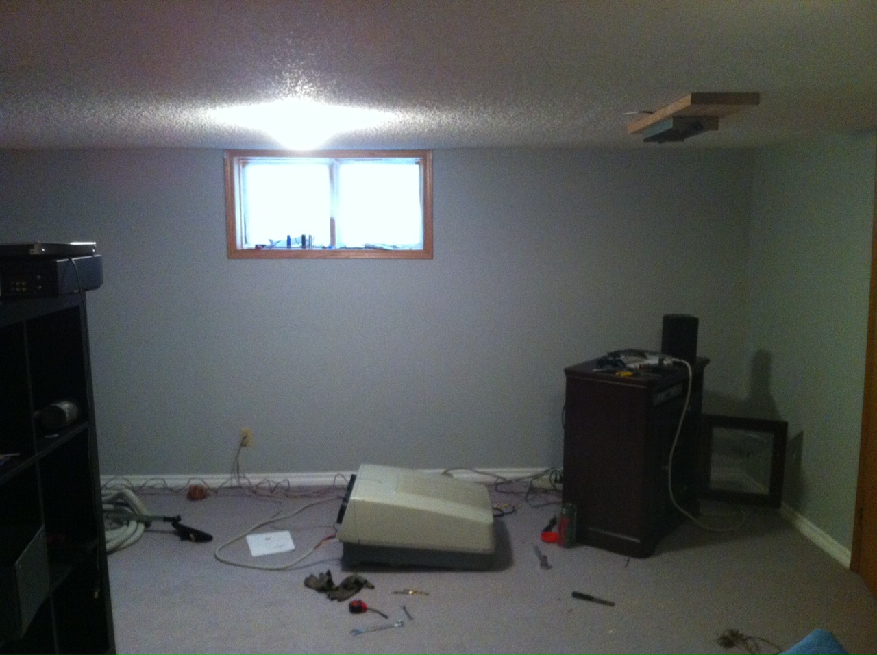

So here you go, mount, room and the storage room that cleared out everything so it's all in one place. Convenient light fixture I switched to a plug for projector. Smile Used to be a dead florescent light. Yes, I'll completely block the window. Speakers are PSB's

I Probably should have painted the 2x10 board white first... oh well. lol
Looking at that mount picture again I'm going to have to remove the door or have it swing in (talk about being focused on one thing only). Once the projector is up it won't open... doh!

Remove the door much easier Very Happy

How did you attach that 2x10 to the ceiling? I see what looks like small screws. BAD idea. Very bad DAF if the projector falls on his head. Very Happy You want a minimum of 4 good-size lag screws driven into joists. Then before you hoist your projector, hang from the mount and bounce around a little. If it supports you, it should support the CRT OK.
For raising the beast, I used Clarence's chain-lift idea:
I lifted my Marquee 8500 by myself, 30 minutes from "on the floor, hook up the chains" to "take off the chains, it's in the mount."

Exsact resion I didn't ceiling mount my Ecp and I ain't going to mount my nec 10pg either I wouldn't want neither beast to fail and possiblely land on and hurt someone

Pff. You worried about the ceiling falling on your head too? It's heavier than your projector.
Mount it well, and it ain't goin' nowhere. I have 4 lag screws on each side of my unistrut mount. I hung from each side and bounced as hard as I could, and nothing budged. If each side of strut can handle a dynamic bouncing 180lb load without moving, then each side will have no trouble supporting half of a 150lb projector. As long as you don't screw up bolting your projector to the mount, it's no more likely to fall than the ceiling is.
