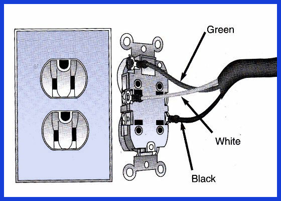

You need all three wires, usually White ( neutral ) Black ( live ) and green ( ground ).
Sounds like you have the outlets wired wrong. For the two 15 amp outlets. are they wired alike? That is all three wires going to the same terminals the same way on the back of both outlets? ( See picture below for example )
On the 20 amp circuit with only two wires you are running without a ground. What side of the electrical box are your 15amp and 20 amp circuits coming off? If one is on the other leg of the 220volt line coming into your box it can cause a ground loop.
I think you should get an electrician in there to straiten this out.
Also do what curt suggested. Different room, set it up and try it out. All on the same outlet. See if your problem goes away.

 Filesize:  52.66 KB
 Viewed:  18967 Time(s)

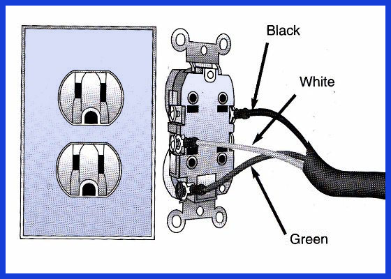

Posted: Tue Jun 11, 2013 4:23 pm    Post subject:
It was bugging me, so I had to fix it. Here's the above illustration with the outlet NOT shown upside-down. Wink
 Filesize:  217.34 KB
 Viewed:  18933 Time(s)
