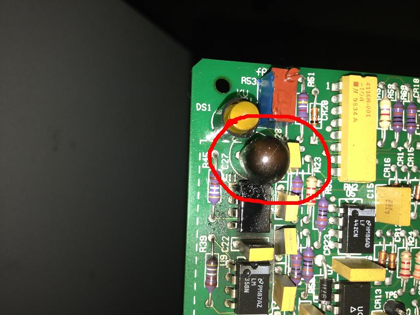

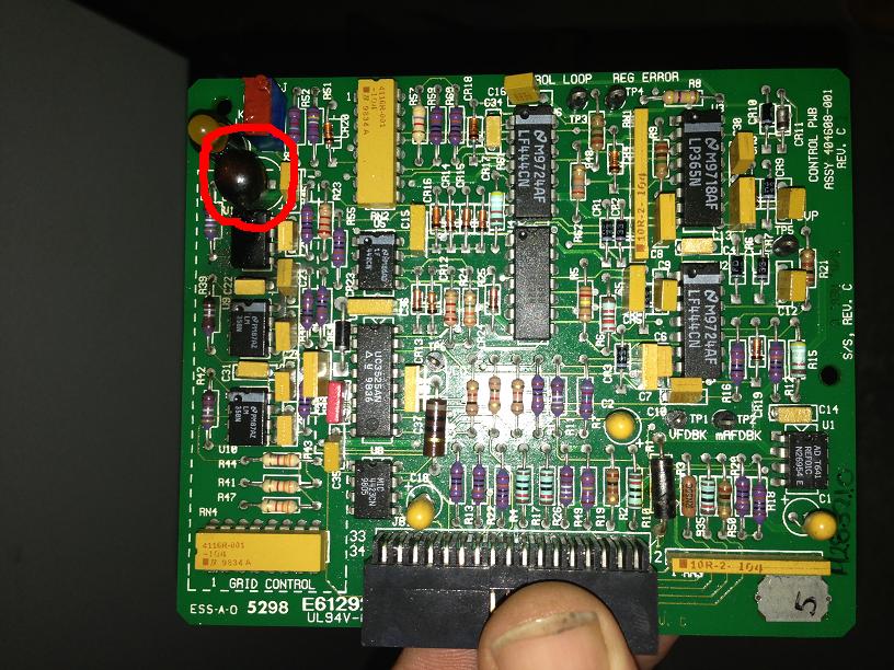

Thanks guys started getting out of hand there for a bit there was caps lock and all happening Sad well I poped oped the hvps (I'm learned the lingo Smile ) and on the control board that plugs into the main of the hvps there is a busted cap close to the led... Looks like its labeled c26 on the board I'll take a pic and post it in a few minutes... Pretty sure curt or some might be able to get the board to me quite cheap from a smoked hvps but if anyone knows what cap it is I might try replace it whilst I'm waiting for it to come....

Thought it was ... It was the only thing I didn't pull apart as I was a little scared of it 8x closer inspection shows c27 blew... I'm thinking its the same as a few other caps on the same board so I might take a guess if no one else has one apart...

This is the part that smoked up...
if anyone could let me know the cap values so i could try a repair whilst the other board comes...

cap is labled on board as c27 ...
