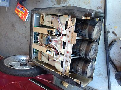

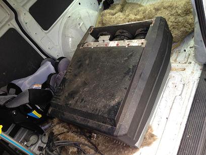

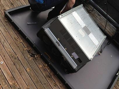

yeah looks ugly ATM and needs a resto as she was out in the weather.... I'll pop some pics up now...

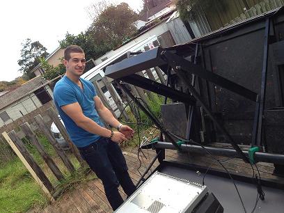

Here are some pics as promised

My Mate Danny helping!!!

Nice..
Rip it apart, clean it good, conectors boards, and see if you gently can get those lenses cleaned without scratching them.
Dont worry its easy machine to work on, and all conectors and boards are marked.
Lets see some pics of the boards when you get them out. Thumbs Up
