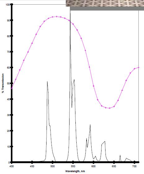

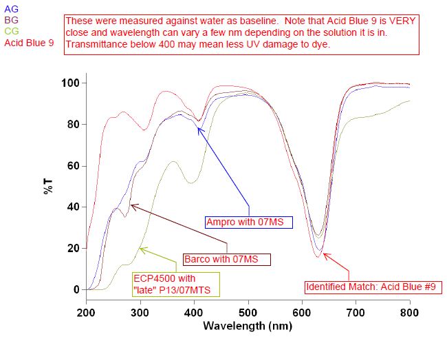

I think I recall seeing on some chart I can't find that some green phosphors do exist that emit centered down to around 520, but I don't know if they were ever used in a projection tube. If such a tube existed, it just might move the XY enough...not sure.
For AC machines, I've included the %T vs wavelength for the green tube's fluid used as I measured last summer. You'll see the transmittance is not quite as good as in the 2nd figure that is for a c-element (3M RPTV). The 2nd figure also includes what is emitted by a typical green tube.
Bottom line: I'd say to have a net impact of shifting the "average" (whatever that means in this case, given human color response over this range) would require an additional cut-off filter for everything ~570nm and above. No idea if that exists except in very expensive tiny little filters one might get from Edmond Optics, etc. I doubt such a specific dye/filter exists.
Oh -- and if mother nature wasn't such a big ass party pooper (see Stoke's shift), I'd say we'd simply need to specify a fluorophore that would excite at 550 and emit at 510... Wink Of course, one might suggest using something that excites in the blue range and emits in the green -- thereby enabling a blue tube to create green light (at less intensity...!)! This, of course, is the single most insane idea ever to appear on this site...
green optical fluid from 7"ES machines...don't be confused by dye name acid blue for green. blue is clear-looking fluid...
3M spec from RPTV with c-element
