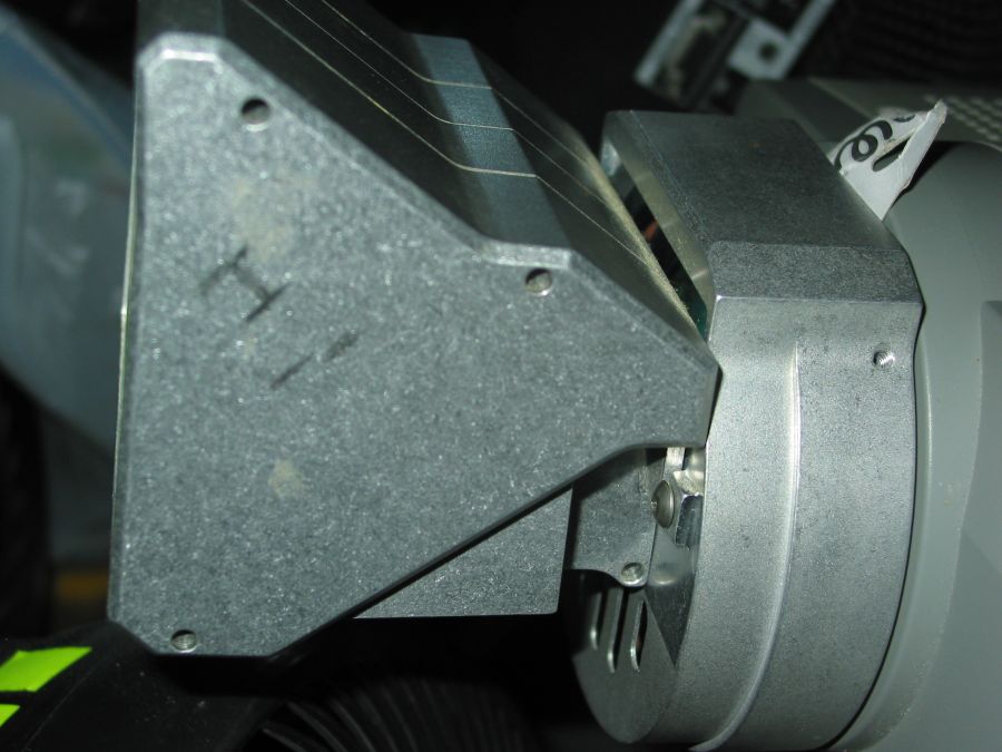

I cleaned the beam splitters with Kodak lens cleaning tissues. It also came with an anamorphic prisim lens. Interestingly that doesn't do a horizontal stretch. Just a vertical squeeze. As far as I can tell from my research the lens is out of a Faroudja projector based on hand picked JVC DILA chips and re-cased. The FDP-DILA2.

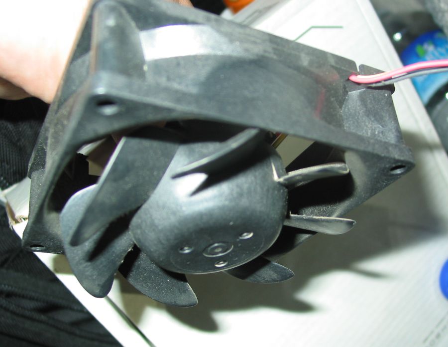

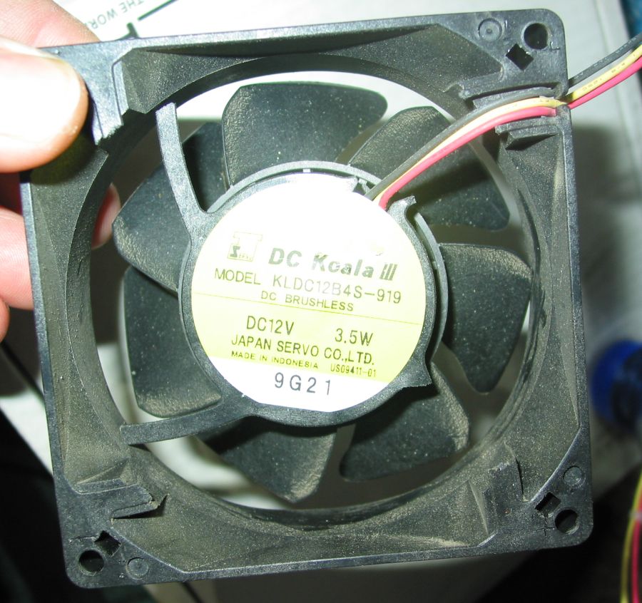

Posted: Wed Oct 23, 2013 11:58 am    Post subject:
Ouch, that fan took a serious hit.

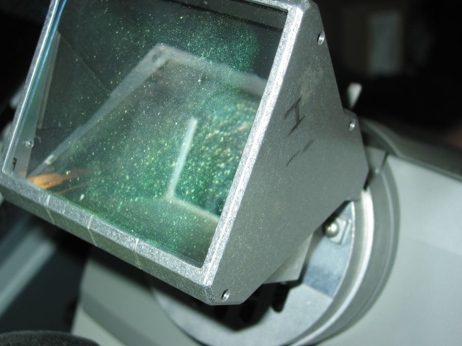

Posted: Wed Oct 23, 2013 12:13 pm    Post subject:
Are all those dots on the VC lens dust inside of it?

Posted: Wed Oct 23, 2013 5:32 pm    Post subject:
Yep

Posted: Wed Oct 23, 2013 6:12 pm    Post subject:
Yep
Yikes. How easy is it to open up so you can clean the elements?

Not sure I'll have to look into it. Laughing

Posted: Thu Oct 24, 2013 7:09 am    Post subject:
HogPilot wrote:
Yep
I see what you did there Mr. Green
FWIW that looks like an old Panamorph-designed VC lens. I had to open up my Panamorph UH380 (a larger, HE lens) to mod the rear optical element position, and the whole process was far easier than I thought. Hopefully it's the same for this one.

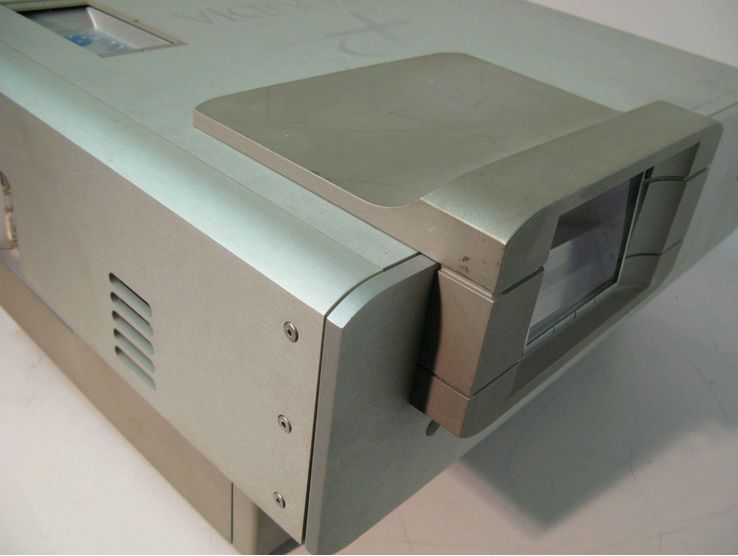

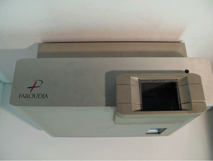

Have a look at this ebay auction. I think it's from one of these projectors:
Faroudja FDP-DILA2 Projector
http://www.ebay.com/itm/140850382035?ssPageName=STRK:MEWAX:IT&_trksid=p3984.m1423.l2649
 Filesize:  28.31 KB
 Viewed:  14967 Time(s)
 Filesize:  34.07 KB
HogPilot
Joined: 21 Jan 2010
Posts: 2383
Posted: Thu Oct 24, 2013 10:36 am    Post subject:
You appear to either have a Panamorph PSO-U100 (glass optics) or a U85 (plastic optics). They looked very similar to eachother, and to the pics you posted. The modern-day version of both is the FVX-200, which uses glass optics.
Pre-dating all of those lenses is Panamorph's original lens, the oil-filled P792. The Faroujda projector that you linked had 4:3 D-ILA panels, so they incorporated the optics from the P792 into the chassis to make it a 16:9 projector for the bargain unit price of ~$40K. Shocked

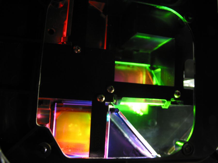

Just watched this projector cook its self into red blobs on the screen over the last few hours. Laughing Digital, what fun!
Also had my iScan HD go from normal to purple and green regardless of input. It also refused to do a 1:1 pixel map. The JVC just woulnd't use the full signal across the panel no matter what the iScan's setting were. Got almost 3 whole hours use out of it before it died. Laughing
Even tried a 2nd DVD player. Same thing.
2 down, let's see what else I can cook to death over here. Shocked

Posted: Sat Oct 26, 2013 5:49 pm    Post subject:
I gave the projector a day of rest. It powered back up.
I suspect there are blobs of dust on the beam spliters causing the red blobs because there is no air filter.
BTW I need to source an air filter. Anyone?
