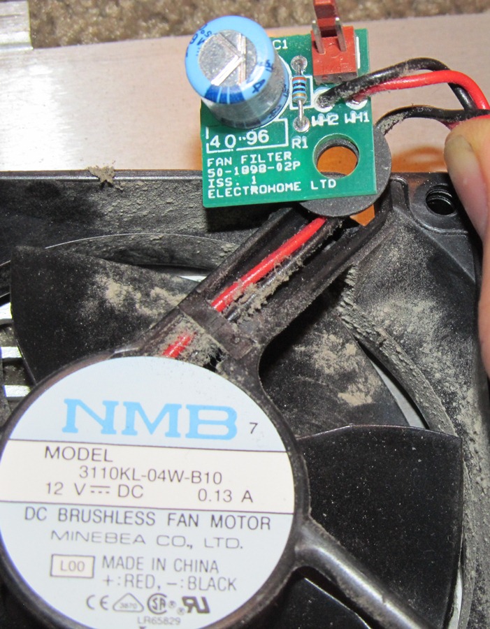

I just looked at the fans on my extra 4500. All four fans have a corresponding little tiny circuit on the corner mount closest to the power leads -- I didn't look too close, but saw a little cap and perhaps a resistor. I'm guessing this is just to ease them along as they get up and running...not sure if this is of some benefit to the LVPS or not. If your has these, you might want to re-use those with the new ones.
If you have a way of measuring/benchmark sound or flow, don't forget to do so before you take out the old ones! Wink

Posted: Tue May 21, 2013 4:28 am    Post subject:
Show a pic of this device!! Could be to reduce speed and to prevent or reduce ripple being introduced to the 12v supply.
Being that they are an AC device they will cause all kinds of strange effects to voltage.

Posted: Tue May 21, 2013 5:08 am    Post subject:
Here it is...
Matt

Posted: Tue May 21, 2013 5:46 am    Post subject:
Yep, its exactly what i said it was.

A photo of other side of that circuit board would be nice, as it would show how that cap & resister are wired in the circuit.

The little curcit board in the picture is a noise filter(I have the service manual in hard copy thanks to curt along with more) I will transfer that to the new fans(it prevents the fans from making electronic noise in the video circuitry)
