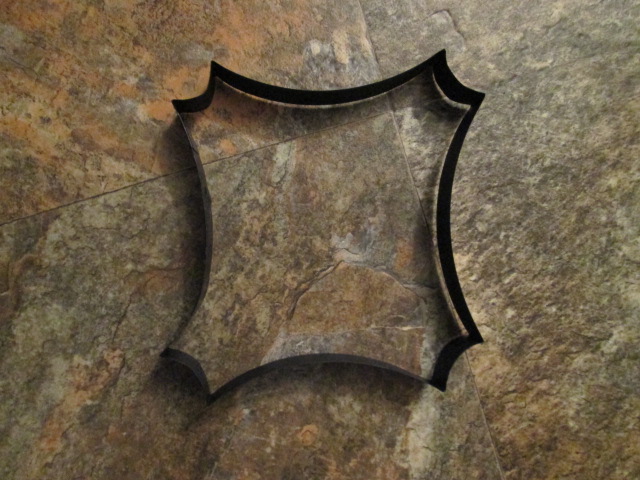

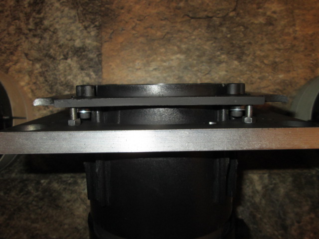

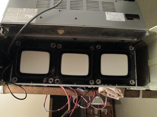

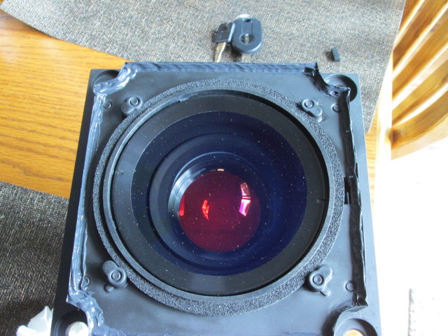

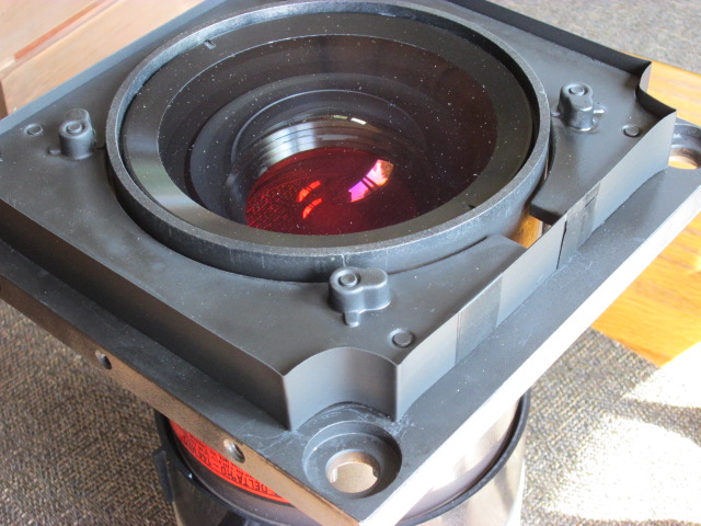

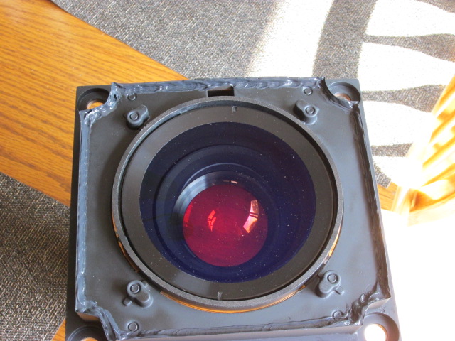

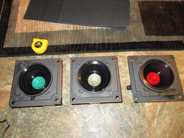

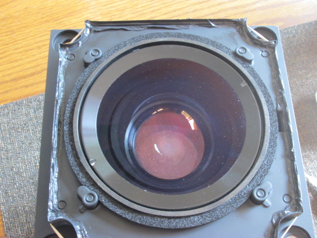

Here are some pictures of the mask I made to solve the light scatter from the tubes and lenses. I have a 1/8th inch thick piece of foam that gets adhered to the outer mask and contacts the tube housing for a complete seal of the lens assembly. Its flexible enough to move with the adjusting allen screws.
