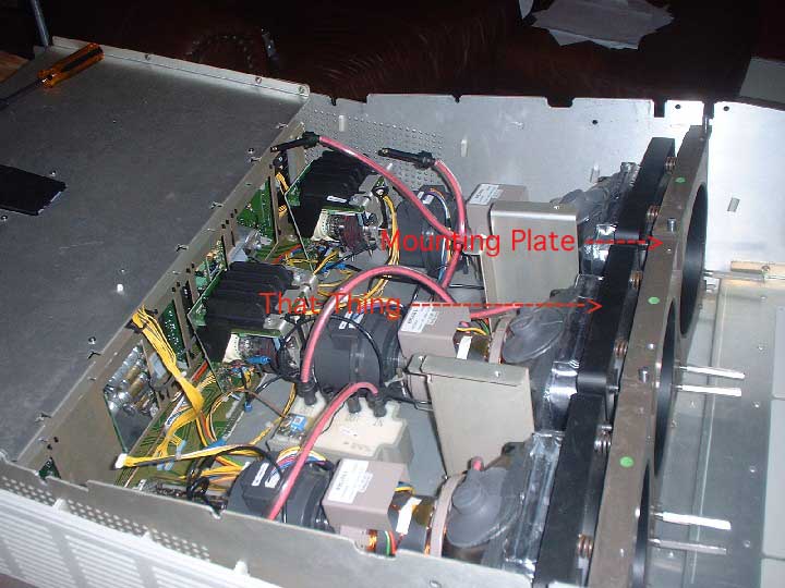

dc_pilgrim
Joined: 31 Oct 2006
Posts: 225
Location: PA
Posted: Wed Jan 03, 2007 12:21 pm    Post subject:
I think this is what he means. Note "that thing" also protrudes into the mount itself, which I previously, inexperiencedly called a "sleeve". I still don't know what its called.
Be great if you can solve this riddle Barry. I want to get my unit up and running first (Curt fixed my SMPS), but might be able to send stuff when the PJ is put away to allow construction.
 Filesize:  88.79 KB
 Viewed:  12411 Time(s)
Joust
Joined: 05 May 2006
Posts: 2429
TV/Projector: Marquee 8501LC
Posted: Wed Jan 03, 2007 2:20 pm    Post subject:
yeah thats the "thing". Can teh projector do without it?
can someone send me that thing along with a plate (preferably with Scheimpflug support) ?
Spotmatic
Joined: 29 Jun 2006
Posts: 531
Posted: Wed Jan 03, 2007 2:34 pm    Post subject:
I don't think so, because the CRT's are attached to that plate...
Joust
Joined: 05 May 2006
Posts: 2429
Posted: Wed Jan 03, 2007 2:49 pm    Post subject:
is "that thing" a plate? it doesn't appear so to me. but i'm just going from the given pictures. The plate is the front most part that the lens is attached to. same as on the Marquee. but the marquee does not have "that mystery thing" between the plate and the tube.
Is it needed?
what does it do besides block light and xrays.
Spotmatic
Joined: 29 Jun 2006
Posts: 531
Posted: Wed Jan 03, 2007 3:02 pm    Post subject:
Well, it's more or less a frame to which the CRT is bolted. This frame is mounted to the lens plate with springs on the top (allowing the CRT to move for the Scheimpflug adjustment). It does not block light, nor does it block X-rays. I should take a good photograph of it tonight, as I have removed the blue tube from my Barco 1208s/2.

Joust
Joined: 05 May 2006
Posts: 2429
Posted: Wed Jan 03, 2007 3:36 pm    Post subject:
OK, I think i get it. but Isn't the front plate Fixed and the tube allowed to move with the adjustments? to which is the "mysterything" attached? the tube or the plate?
Posted: Wed Jan 03, 2007 3:44 pm    Post subject:
The two rods you are referring to are the scheimpflug adjusters which are spring loaded to the rear CRT assembly . You lose the ability to use scheimpflug with Bjorn's design . The CRT's then mount to the rear of the adapters .
dc_pilgrim
Joined: 31 Oct 2006
Posts: 225
Location: PA
Posted: Wed Jan 03, 2007 3:54 pm    Post subject:
Barry,
I think Ile gave a decent render of the "thing" in the other thread (probably not to scale):
https://www.curtpalme.com/forum_archived/viewtopic.php@t=3026.html
