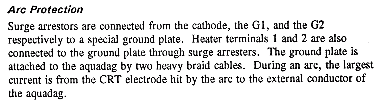

Posted: Fri Jun 21, 2013 10:45 am    Post subject:
No comment.

Posted: Fri Jun 21, 2013 10:59 am    Post subject:
so the arc are going from the neck board, and to the aquadag.?
Posted: Fri Jun 21, 2013 4:44 pm    Post subject:
no, the surge protectors are the round things holding up the ground connector plate on the VNB. you need to connect it!!! Don't blow up your HDM or FGM by not connecting them. And for better grounding add two more aquadags tot he extra two connectors on the VNB.
I need better understanding of this, Why are those aquadag caled grounding, are they leading a arc to or from the tube bell.?
The neck board is grounded to the VIM true the coax cable, and from the motherboard right ?, and then 2 conections to the shield around the neck board and from there to the rear heat sink with those fly wires, and its conected to chassis true the HDM and FGM boxes.
I would think that would make a nice potential ground loop.. looks to me the neck board is grounded 3 Places, that i guess all endes to chassis somewhere.. Or am i wrong.?

The driving of the tube is referenced to the ground that is on the VNB, so connecting the aquadag there would be the best solution, if you connect it somewhere else that means if any current flows there it elevates the ground of the VNB through its ground resistance.
In a CRT projector the ground loop is not that bad as is an audio amplifiers because of it's more complex structure, eg. focus and convergence have no real effect on each other, so the ground loop neither affects their function. But good surge protection is crucial, as everything near to the tube is endangered of high voltage arcs.
