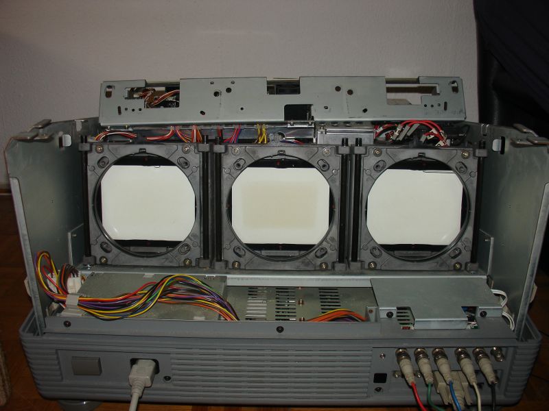

As Curt said the tube life is highly depending on how it is used.
Look at this:
This 6PG xtra ran less than 2600hrs, and none of the tubes are usable.
On the other hand this is my 6PG xtra:
It has more than 4000hrs in it.
Jeremy: Have you tried the 1600x900@72Hz? It looks great on my 6PG xtra!
