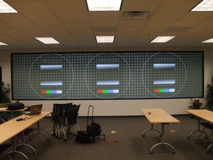

I forgot to respond to this:
Almost all of the technology has some form of light control built in. Some has auto, or Dynamic, and as you say the JVC does not have such thing. But it's on every top end projector I know of. For instance (see attached photo) one of my blended setups uses three Christie Digital HD3 / 3 chip DLP projectors. These projectors have various forms of light control, that can be considered dynamic or auto depending on what they do. But being like what was common on the HT projectors for light control, these circuits are far more advanced.
In the picture (btw, that is my service kit - both laptop and tool bags pictured). As you can see on the 40' wide rear projected screen is three rear projected images showing three different test patterns. I had just finished the light balance and getting ready to do the blending. If you look at the pictures, in the test patterns there are three places were you could see white and even the reference of white to black. On that screen is projected three different images and they are all of the same light intensity with matching fl output. Here's the thing I want to point out. None of he three images light output is controlled by or modulated by an iris. I am however using an electronic iris control to keep what I have setup constant, but the the balancing of the three had nothing to do with an iris. In fact, these projectors have several auto iris and lens light output controls built in. But of course, it would be a disastrous case if these features were allowed to do their thing to control the light output in a Blend setup.
So here's the thing. I have three projected images and none of them are using the Iris to regulate or modulate the light output. Yet I have a balanced light output between the three projectors. I can have the iris help keep what I've already achieved. I sometime do that, but in no way do I involve an iris to get to where I'm going.
But at the same time, these three projectors have very low contrast ratios. Now if they had higher contrast ratios then I would have a problem being able to achieve what you see on the screen, with out using some form of iris control. but also going against something you said, the reason why I would not want to use the iris control on the RS56, because I know it can affect the dynamics (contrast ratio) and diminish the light output.
So for the commercial application in the picture, super C/R is not important. But for HT and being able to get great video dynamics with good whiter than whites and blacker than blacks performance, I want to leave the iris alone. I want to see if that's possible on the JVC.
Also, and if you notice from the picture. My whites in all three of those projected images are really white (not silver, clipping or blooming..Very Happy). You have to look at the last bar at the bottom and the white at the far right of it. Now that took some work, and it was done with the optics wide open..Smile
On my next visit, I'll be taking my Chroma Pattern Generator with me. It has DVI output. I will use it to make sure I'm sending the RS56 the right colorspace and signal level. It also has the perfect test pattern for for where I'm going next.
