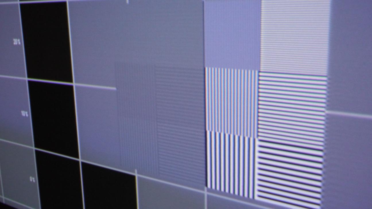

Posted: Fri Sep 13, 2013 9:50 am    Post subject:
Here ya go Cine9 with P19Lug and HFQ900
1080p@60Hz
Maybe the shot is a little bit unsharp but the lines are resolved very well.

Posted: Fri Sep 13, 2013 10:08 am    Post subject:
Thanks ElTopo.
Looks like the vertical lines are not resolved very well, or is that just the Picture.?
Ideal i guess the horisontal and vertical pattern should look the same, same color and all.
Ill try if i can make a screen shot of my Ultra Marquee tonight.

Topo,
That is a good start. Look up a thread that IIRC correctly tse or MadMrH started about this. Tse said the best way to test is to look at the upper left portion of the screen.
Posted: Fri Sep 13, 2013 9:15 pm    Post subject:
It is a good start yes, but i wouldnt say that is all it could ever be, i reckon it can be made better than that.
