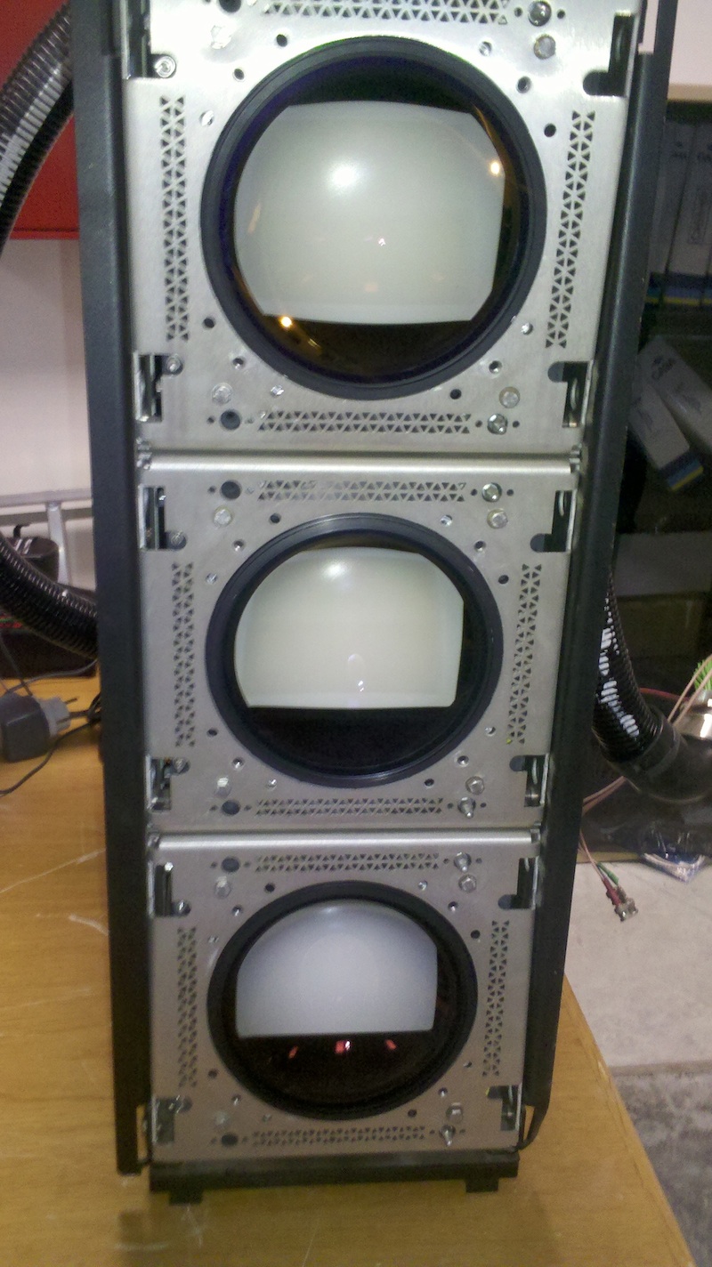

Progress:
One unit was used for spare and only for testing boards. New P19LUG dated 2002 were still in it, but in 90c housings, so did mayor job to cut them out and re-glued them in horizontal housings. They have to dry now for 2 weeks. Then new glycol and new red and green C-elements will be installed.
Question: does some of you have RB909 or RBL909SP or maybe SEOS controller software? I want to try to bring a dead controller back to life. Please shoot me a PM.

Francisco
Joined: 05 Apr 2007
Posts: 305
Posted: Mon May 13, 2013 8:56 pm    Post subject:
Hi km987654,
The tubes are mounted 90 degrees turned, the LC chambers scheimpflug is also turned 90 degrees.
visualize that the optical head stands vertical tubes are then horizontal above each other, scheimpflug can be adjusted top bottom this way.

Posted: Wed May 15, 2013 9:41 pm    Post subject:
Nope normal as any other 909 only tubes are fitted 90 degrees into chassis and LC chambers front is rotated 90degrees.
scheimpflug from left to right when projector head stands vertical and tubes are horizontal.
Actually software is from SEOS meaning little more adjustments and different vertical board.

Hi I'm setting Astig as for installing the new tubes. Green and Red are done but....
Anyone knows why I can't adjust blue focus?
I have no I2C errors and blue and red can be adjusted using midpoint focus controls 0-99
Also blue controls function from 0-99 but the blue tube does not react on the adjusting.
Already changed focus coil on blue and convergence tray to see if the problem came from focus coil or Focus board. But no changes unfortunate
Do I miss something here?

Phew sometimes things are easy, connector was not tight properly. Confused Sorry for asking I tought I missed some kind of setting and was thinking difficult when the solution was easy.
