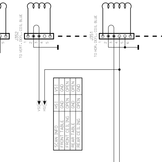

Anyone knows were these jumpers are for?
They are mounted between deflection coil connectors on the extension boards on which you connect the extension cable for the 909 split pack.

Seems to have to do with deflection scan fail or connector test. In the picture there are different combinations of grounding and leaving open. Might very well be that this influenced your abl as it grounds a vertical deflection wire. Perhaps someone else knows more why they are there?
Difficutl but I think that if there is no jumper between vsi and hsi than the vertical connector is not tested for scanfail? Perhaps the jumper has to be set different when you change the connectors?

Posted: Tue Sep 30, 2014 11:47 pm    Post subject:
I thought it was for changing scan direction?

Posted: Wed Oct 01, 2014 12:55 am    Post subject:
He I now see there is SI written on the board. scan Info. So the scan info table has something to do with it.

Posted: Wed Oct 01, 2014 2:57 pm    Post subject:
Eh no, connector is labeled nr. 15 by Barco technical simulator service. Nothing to do with switch. If made some more shots:

Francisco wrote:
GUYS GUYS!!! MYSTERY OF ABL LINES is SOLVED!!!!
When I put all back together again the picture was upside down reversed on the screen. I didn't see it earlier because I looked trough the lenses most of the time. But I was sure that I connected the scan reversal connectors the right way Confused double checked and yes the were connected the right way for front ceiling...still shown upside down. Now there is a little pcb to plug-in all the connectors for cable extension. this pcb is connected to the mainframe, now it appeared that the previous simulator technician reversed the connectors there which have these little jumpers. Guess what reversed the connectors, pictures displayed the right way on screen and ABL line is GONE Cool
I want to thank you guys for helping and all suggestions, sometimes it's hard to find a simple solution.
The FUN can begin Wink
Do I understand correct that changing the connectors on both sides made the ABL line disappear? And do you think it is related to the jumpers?

redfox001 wrote:
Yes that's correct! I think this is what these jumpers do. When I changed the 3 connectors with yellow green wire around the ABL line disappeared. Only thing is that the connectors are positioned differently as referring to the manual. These jumpers are also differently positioned, on the main unit they short the upper 2 pins, in optical unit they short lower 2 pins.
There is no explanation in manual how to set these.
