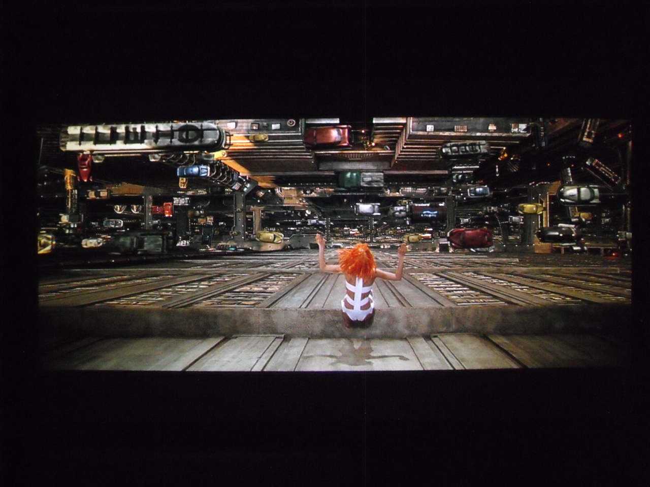

If you like, try make a screen shot of this scene in The fifth element, i stole this picture from Mike Parker.
And tell me what differences you see from this one to your shots. And explain to me why bandwidth is not verrryy...!!!! Important to a CRT.

Kurt, what do you expect from this shot? It's 1280 pixel wide, so it will tell nothing but shooting abilities and camera differences Smile

Im sure you will notice if you make a shot like it, no matter your shooting abilities, and almost no matter what camera.
I had to minimize the image to upload it here.
So post your shot of that scene, and we can argue whats what.

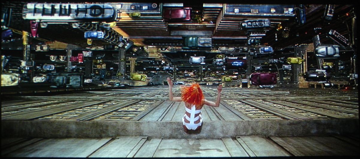

So, here you are, what can you tell about this?
(the colors are off, looks warmer in reality)

In reality? I have never seen a flying taxi Very Happy

gjaky..
That picture looks nice to me bandwidth wise, would be interesting to see that projector with a tighter focus, and a calibration.
Is it a AC machine, or a LC machine ? ill guess its a AC, the contrast looks a bit weak, but that might also be a calibration isue.?
The shot looks much more flat and lifeless then MPs shot, ill say it looks much like the G90, just looking it now, your shot could be from a G90 from where im looking.
Im just guessing here, and commenting about what i see in the picture, i trust you compared it to what you see on screen and it was a good match.
Lets hope someone with a 909 will post that scene to.

The cold facts:
This is my NEC XGLC, this particular machine unfortunately has some serious bandwidth issues, it's rolling off with even 120MHz pixel clock signals, not even resolves the 1080i-96Hz, which was used in this shot, and the movie itself was a 4GB 720P BRrip. I bet this isn't what you expected Wink

That explains very well why it dont fight the bandwidth, then you need to do a shot with a 1080P 60hz resolution to as i requested. Wink
Ill gues it then looks quite clear what the bandwidth do to that scene.. so exelent test. A low and a high bandwith shot of the same scene.
Whats the bandwidth / pixel clock on that shot.? 80Mhz.?

It was projected in 1080i-96Hz, @127MHz pixel clock, it's just the source movie that was 720P Smile

Try shoot 1080P 60hz.. 155-165Mhz, and try keep it pixel perfect, might show some more details, and more dept in the image, dependig how the bandwidth role off.
It will be a very good way to show the effect of bandwidth if you can push it over the edge.
Maybe together with the 1:1 pattern to see how that match.
The cold facts:
Not soon by me...
I was just doing this to show there is so little to see in these small pictures, that even my setup looked comparable to the top machines, while my machine is definitely ill now and even the source material wasn't cutting edge.

I still think there is much to see if you post pics with the information like resolution and bandwidth, and specially if you post a low and a high bandwidth shot.
I have a 144 and a 155Mhz profile on the G90, and its clear to see the difference on that scene, your right its impossible to see everything in a shot like that, as we have limited information, but its a very good scene who display stuff a bit like the 1:1 pattern. It also displays very well why to use the test pattern, like no one knows what they are looking at in a scene like that.
Now you dont want to finish it, lets hope one of the Barco guys will finish it and make a low and a high bandwidth shot of that scene so everyone can see and understand whats the difference in resolving the signal good and bad.
